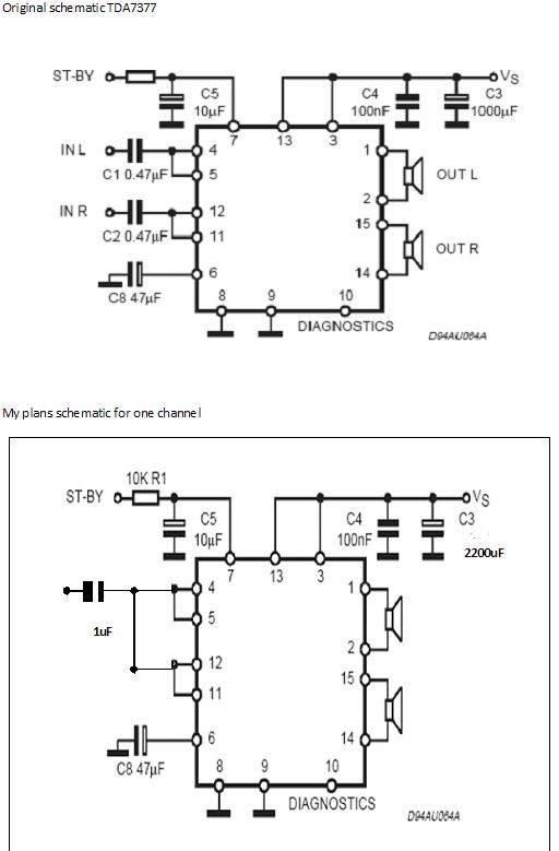

Hi Every One,
I will to build small amp for my mp3 player/ comp. Thinking TDA7377 is a good choice because is very easy for me.😛 So, I want to make bi-amp configuration. And thinking my schematic can be work. Am I right 😕. Somebody please help me...
