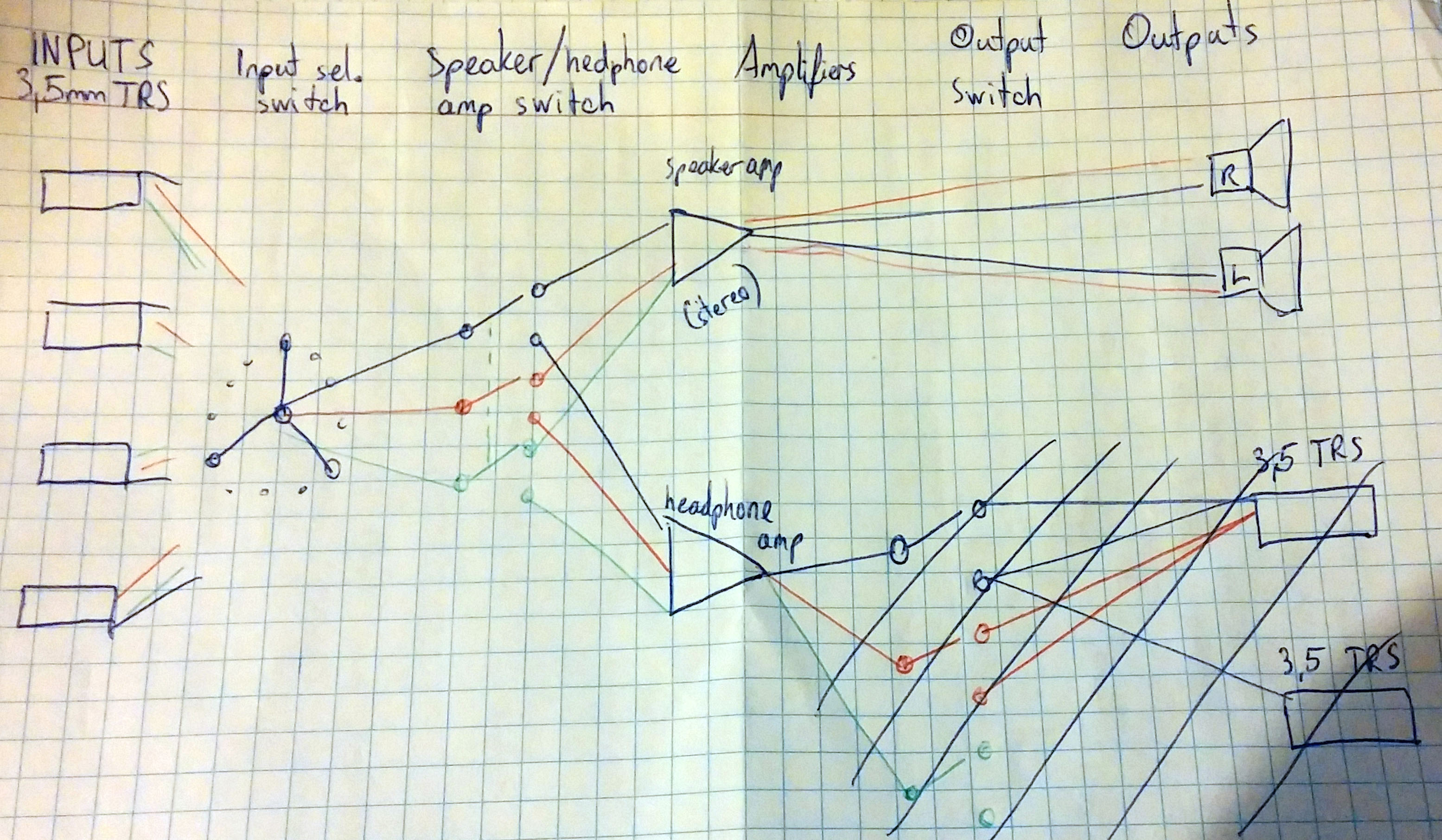

I plan on building an Input/Output selector with inbuilt speaker (and probably headphone) amplifier. The plan is to use 3 pole, 4 position rotary switch to select an input... and the following parts get complicated...
I want to be able to switch between speakers and two headphones, but have the ability to use either one set of headphones, or both at the same time.
The way I see it, I could use a 3PDT switch to select between speaker or headphone amp, and then have additional switches on the amp output side to select between the headphones. That's quite a lot of switches...

When talking about a two wire connection, we're talking about a typical + and - connection, like on speakers - those would get disabled when one wire is not connected. But on a phone/TRS connection, I would still need to switch off both L and R channels to cut the audio, right?
The input and output switches WILL be separate ones, I can't even figure out how to do it with one...
I agree with not needing to completely turn off both headphones - although I plan to keep mine connected at all times, if I want to use speaker output, I will have to route the "audio path" through speaker amp instead of the headphone one, and that would "switch" them off...
And I don't need a mixer input as I will use only one input source at a time for the foreseeable future...
I am attaching a crude schematic to better convey my idea. Still need to figure out the best way to switch between headphone outputs...

Your diagram shows 4 inputs. Is that two stereo channels? or do you intend to have 4 stereo channels (equals 8 channels)?
Combine the two sets of input switching.
The outputs from that switch can connect to both the stereo power amplifier for the speakers and to the stereo headphone amplifier. You don't need a separate switch. The source impedance at the other end of the 1/8" TRS should have sufficient drive capability to drive the cables and switches and the two input impedances of the head & power amplifiers.
Yep, that would be 4 stereo channels. Well, to be honest, I really need only two at the moment, but I see myself *maybe* needing additional inputs in the future so there's that. I have some 3Pole 4position switches anyway, might as well use them.
as for the "amp selector" switch - I see that's not needed, not sure what I was thinking 😀 I would still need a switch to turn on the power to either one of the amps...
