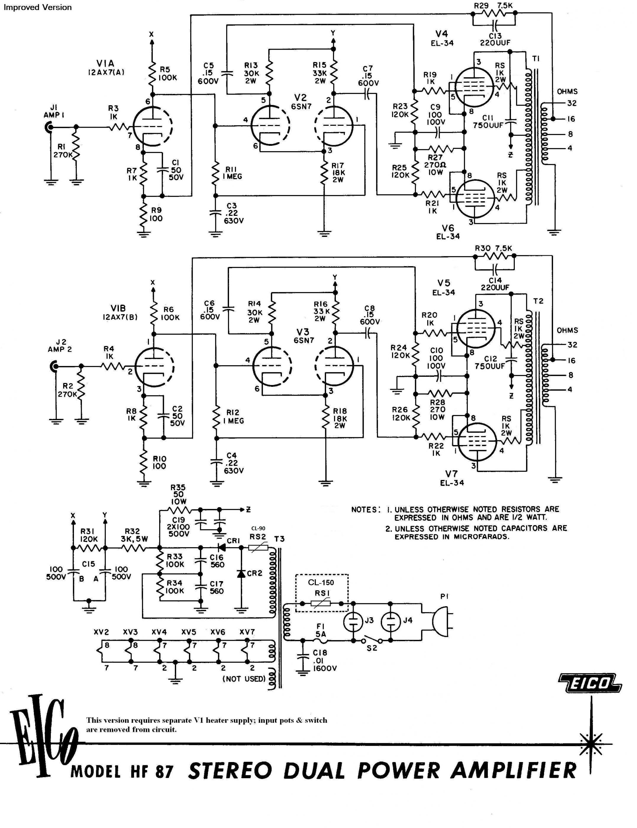

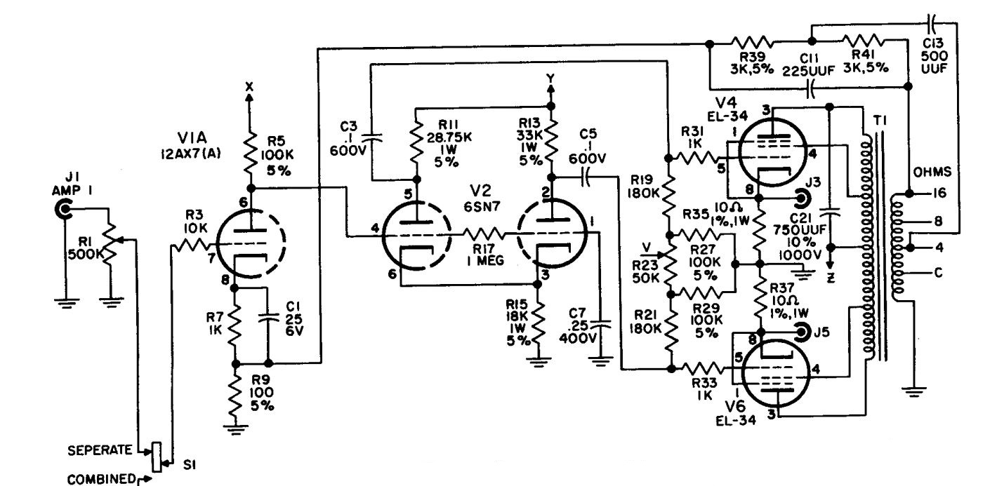

The Russian 6Π3C-E (6p3s-E) is a nice 5881 equivalent.
Hammond's 1650HA O/P transformer is a decent match for the 6Π3C-E. Given Hammond's reputation for OK, but not outstanding, performance, I suggest you employ "idiot resistant" Mullard style topology. IMO, EICO amps are good starting points. For cathode bias, see the HF87. For "fixed" bias, see the HF89.
Thank you very much, that's quite useful. I definitely want to start with something relatively simple and idiot resistant. I'm going for cathode biased first, but also want to experiment with fixed bias, CCS, stabilised power source (cue the radiator), things like that.

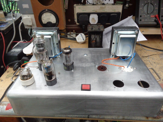

I've recently started a new amp and am using a Grundy roasting tin as the chassis, they can be bought new in the UK for about £30. They are solid ali, thickness about 2.5mm, see - Full size BS Tin - Grundy Tin it should fit your amp ok. The one I'm using I found chucked with some rubbish, it measures 16" x 10" x 3". The handles can be taken off (drill out rivits) and reversed. If you keep your eye out for auctions of catering equipment I think you could get a lifetime stash of chassis's.
Regarding your layout, try to keep in mind the signal input and heater wiring placement when orientating the valve bases. Try to keep IP wiring as short as possible, whilst not always possible an RCA IP right next to V1 is optimum. Also keep PSU wiring as short as possible too.
Andy.
That's a great idea, and looks very good. I was browsing e-bay for used chassis or something similar, but I really did not think outside of the box like you did. Kudos!
About the input, this is something I'm still trying to decide. If I use a dual pot, it means cabling from the input tubes to the pot, which will be located right in the middle of the front panel, then it will make sense to also have the RCA sockets next to it. Alternatively, I could have separate pots for each channel, then is easy, all very close to the first stage tube for each channel. I need to make my mind about this, any ideas? Does shielded cable works OK to suppress noise if I use longer IP cables?
Edit: What is that tube on the left that looks like a Dalek?
