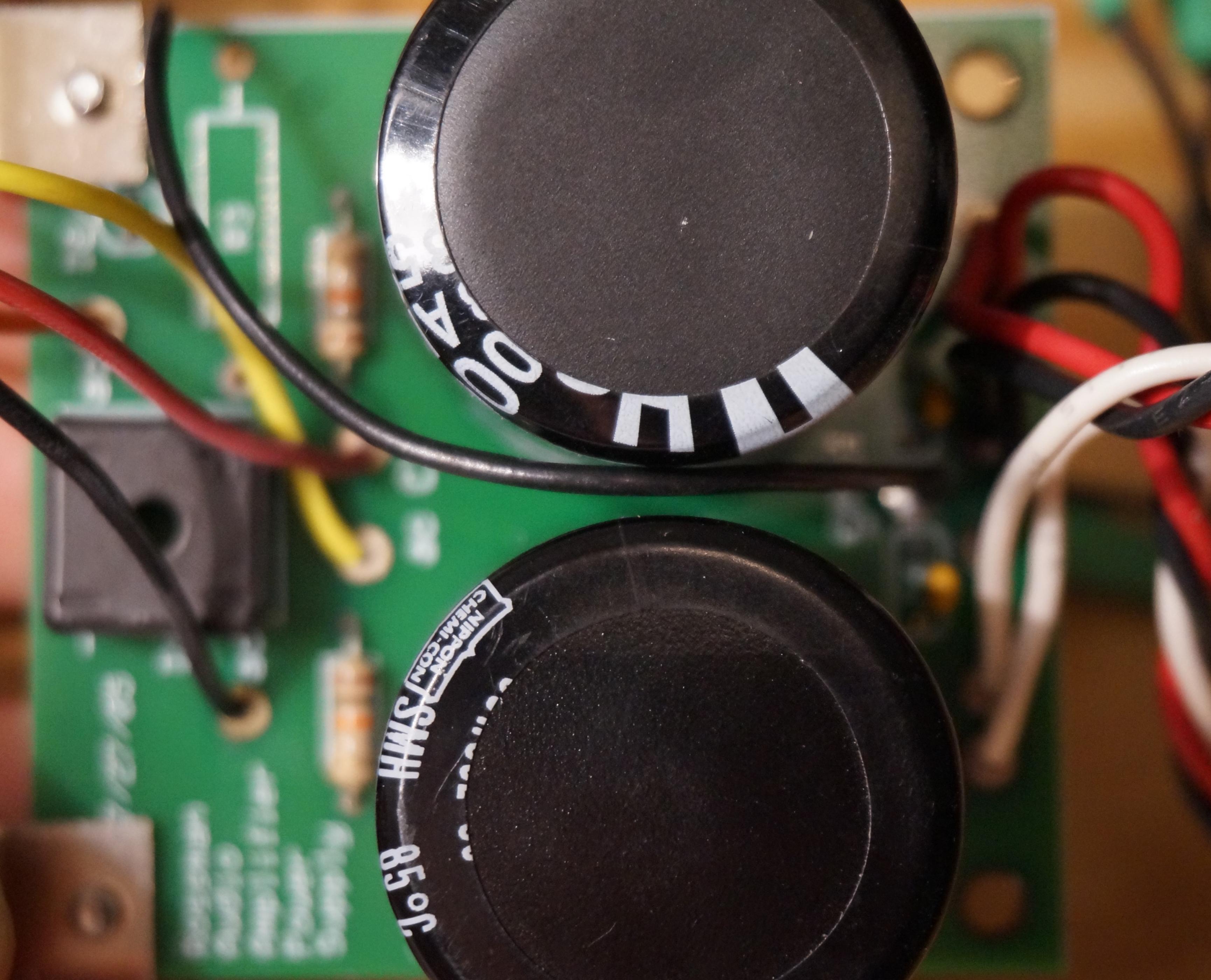

I recently bought an amp that I thought might be a shortcut to gainclone fun. See first picture. It cost less than a bare toroidal from partsexpress.

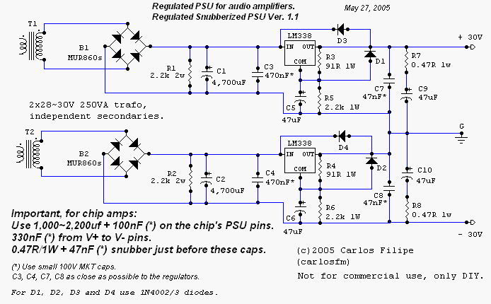

My goal is to build something like what's in the second picture.
I don't yet read circuit block diagrams well, so I hoped that by starting with a complete amp, I could just connect up an eBay input selector and be done (in a new chassis).
However, this amp has some hiss, and when I check the voltage at the amplifier, I read 45.7 volts. Am I right that this is too much power? The transformer has 30 volt secondaries.
If I'm right, should I try to modify the psu to drop the voltage? Or buy new amplifier boards? (e.g. ebay mx50se)?
Thanks for your help, and my apologies if asking questions like this straight off is not ok.

Welcome to diyAudio Stefan 🙂

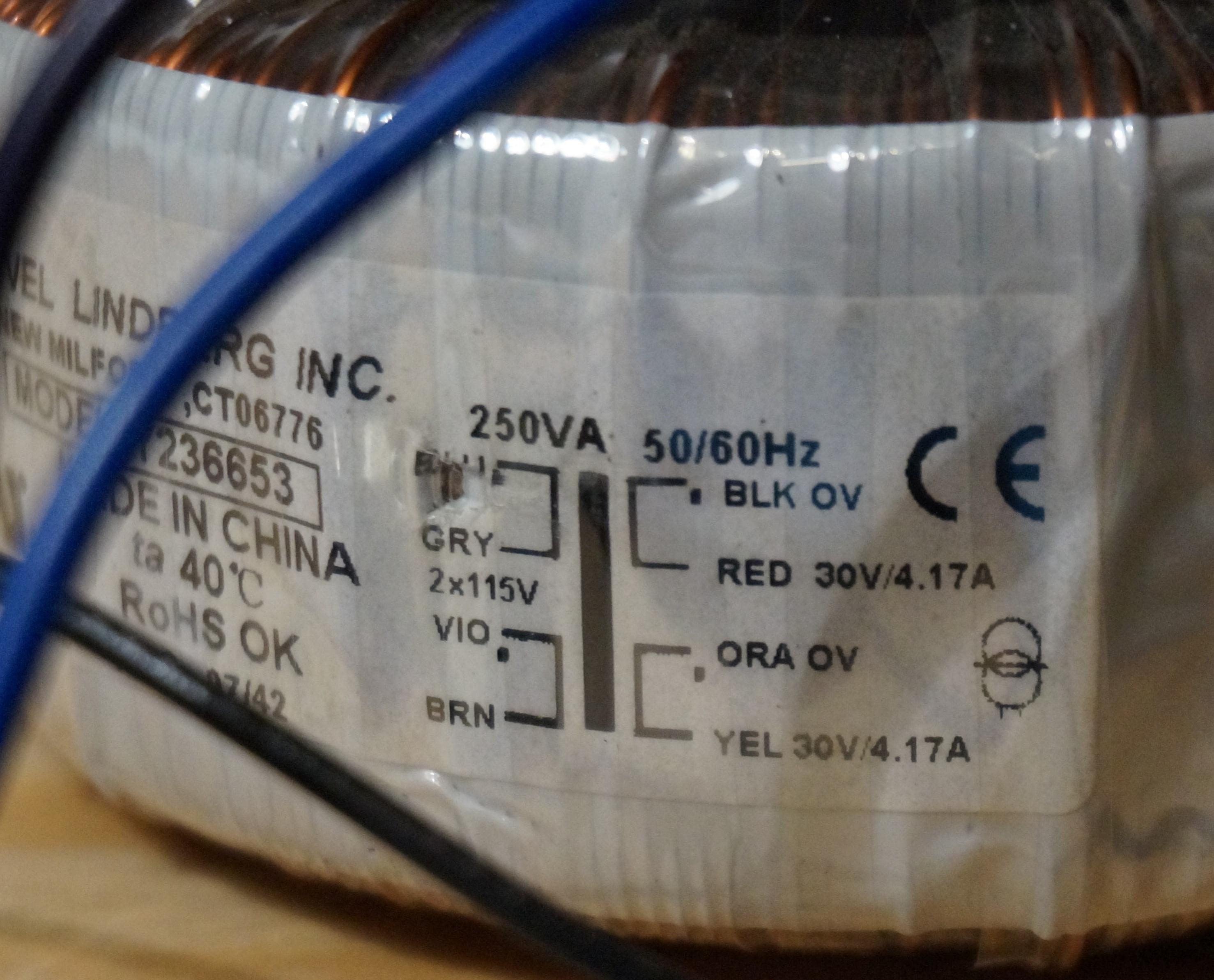

Your 30 volt transformer (so a 30-0-30) is really to high. The DC voltage you get when it is rectified and smoothed is 30 multiplied by 1.414 which is 42 volts. Your 45.7 volts is higher because the transformer is only lightly loaded.
You are right on the absolute maximum voltage for the LM3875 and that value is for no signal conditions.
Ideally you want something like a 25-0-25 volt ac transformer (or even a little lower) to give good reliability. That would give DC rails of around -/+36 volts DC. That would be plenty.
The hiss probably would not be altered by different voltages though... so that is something else. I've no experience how quiet these amps should be. Also your speaker sensitivity will play a part in how noticeable hiss is.
Good luck with the amp 🙂
Thanks for your reply. Are mods to the power supply an option here? Or are there other (inexpensive) amp boards available that would thrive on 45 volts?
I've attached a picture of a circuit from decdun.me.uk, that appears to show a 30-0-30 AC input with a 30-0-30 DC output. Would this work for my amp? Or would I be in way over my head, even with the help of some electronics (not hifi) people at my local makerspace?
A third option would be to buy a new toroidal, as you suggest. But they are expensive, and if I (or the previous owner) have been oversupplying my chips, they might already be damaged?

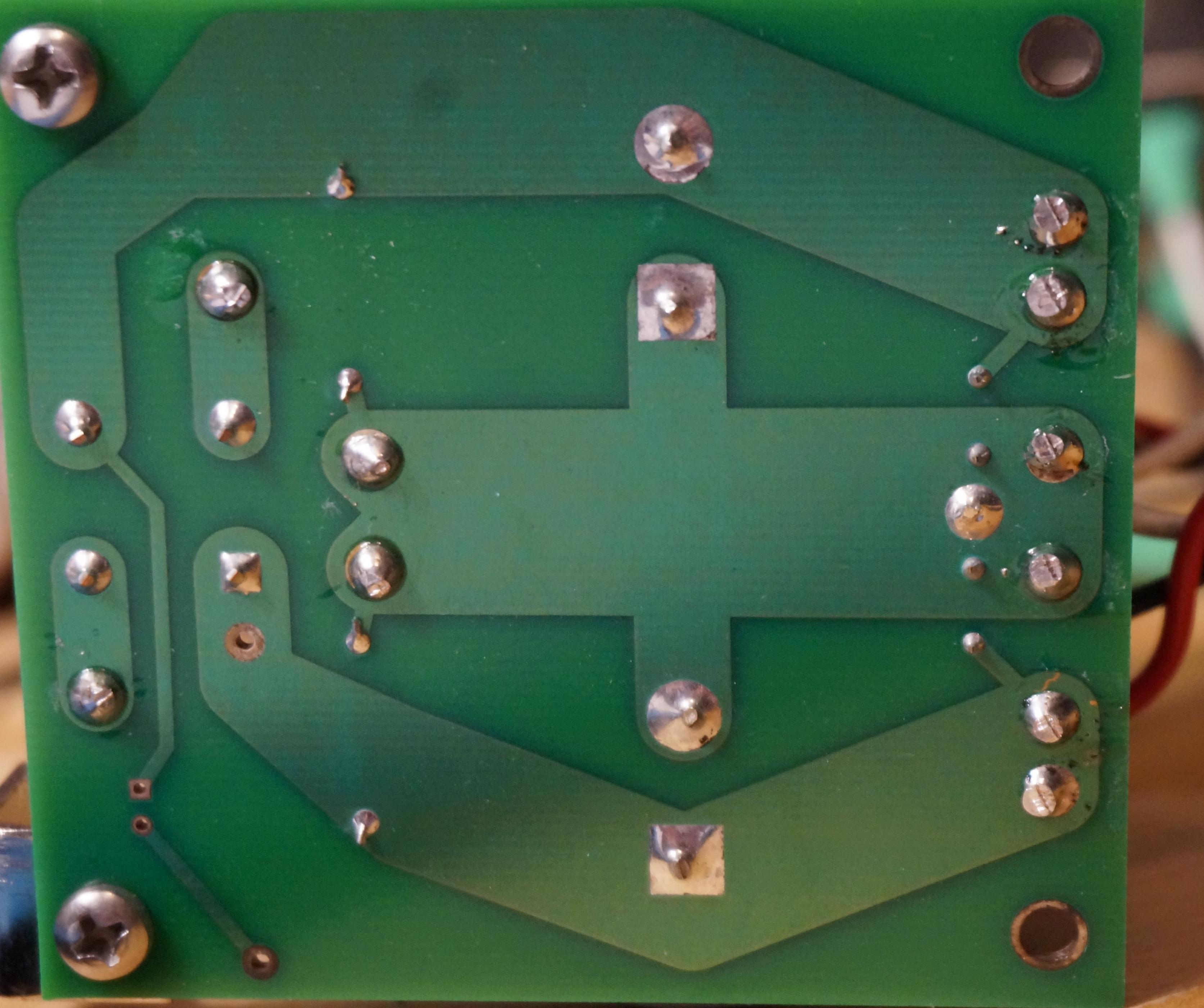

Ok. I'm thinking that since this amp has probably been used quite a bit with the high voltage, there's little harm in continuing to use it. It was used in a classroom setting, with no power switch!
Anyway, I'm now trying to sort out the hum, and discovered more of a mess. This design has no chassis grounding, and it looks like all the grounds are daisy-chained to the house grounding.
I've attached my attempt to trace out the grounding scheme as I understand it. Apologies for my ignorance of circuit drawing conventions.
Is there any use trying to salvage this? If/when I put this amp in a new chassis, how complicated would it be to convert to a star grounding scheme?
p.s. am I lucky that the amp didn't have a chassis ground, with the +30 v wires from the transformer connecting to the power PCB's ground? Or does the AC power there not care which wire is which. (I'm pretty new to this).

Its not really practical to try to lower the voltages because of the higher currents involved. Although its easy to make a regulator to drop the voltage, the problem is that the regulator will get very hot as you turn the volume up.
If it drops 45 volts down to 30 then 15 volts is dropped across the regulator. If you now pull say 3 amps from that supply then the regulator dissipates 15*3 which is 45 watts of 'wasted power'. Just not practical.

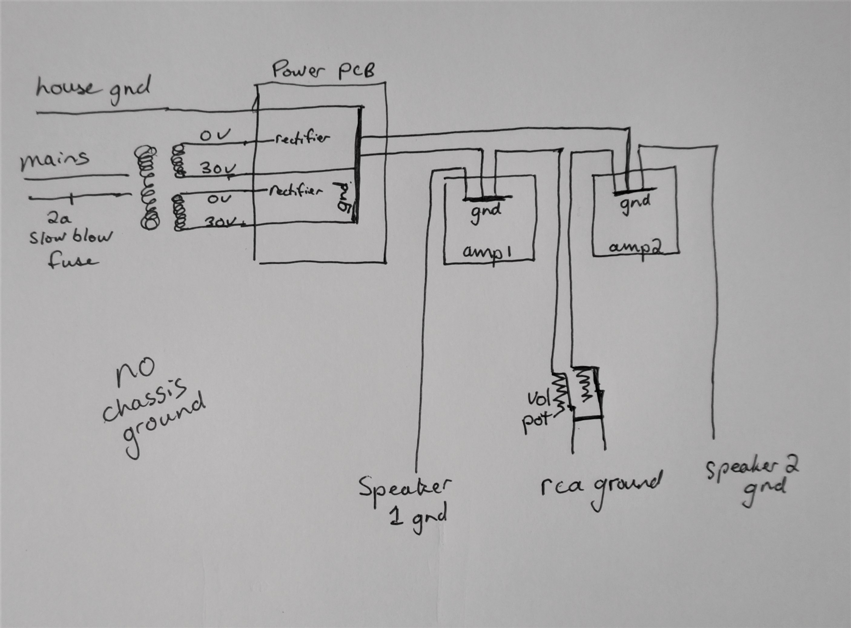

If the amp has been used as it is then yes, you can just carry on using the same supply but it's not ideal. If you look at the data sheet for that IC it states the absolute maximum values and yours are running pretty close to that.
Hiss and hum are totally different in their causes. Hum is always down to either layout and wiring and/or picking up radiated magnetic fields from the transformer.
The wiring of the two outer wires on the transformer doesn't matter. The Red and Orange join together and that becomes the zero volt point. The Black and Yellow can be swapped around, it doesn't matter which way they connect to the rectifier.
I would begin by starting again with the wiring of the boards to the power supply. Do one channel at a time.
Connect the ground of one amplifier board back to the power supply ground. That is the right hand connections on your third image. The thick middle trace with the connection at the right hand edge of the board.
For testing apply a temporary short circuit across the amplifier audio input. Do not connect to the input sockets yet.
Connect the power supplies for the amp board correctly back to the power board. Be certain to get polarity correct.
Connect the speaker socket ground terminal back to the power board centre trace but connect it to the left of the other ground terminals. Scrape some of the green coating off and solder to that.
Connect the positive speaker output socket to the amplifier board.
Switch on and check the DC voltage across the speaker terminal is zero.
Now try a speaker. It should all be quiet.
