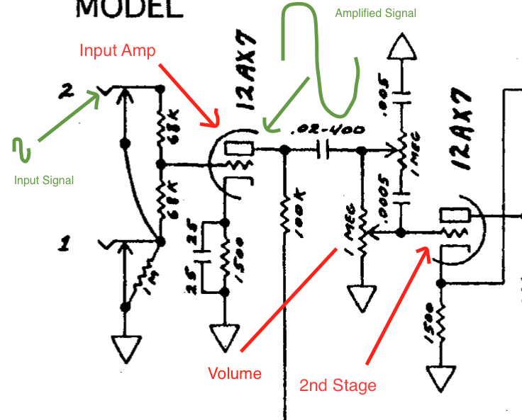

So, non-expert here with what is probably a dumb question. Related to analyzing a guitar amp, where it uses a 12AX7 for first an input amplifier, and then a tone section, it doesn't make sense that I can first amplify a guitar signal of let's say +/- 2 V, into a much larger voltage, and then couple that voltage into the grid of the tone stage. If the load line of the 12AX7 expects grid voltage swings of a couple of volts, which OK for the guitar output, how isn't the amplified version then way too much for the input of the tone section? There's probably an obvious explanation so I appreciate any insight!
You sort of answered your own question ie your right it can get overloaded...... Depending on the pickup, figure 200mV to 500mV is normal range of light strumming.... hard banging can produce peak transients between 1 and 2 volts... The example you mention sounds like classic BF /SF input stage... The first stage is working into a very lossy tone stack ...The signal attenuation is significant ....Since this is a guitar amp..the front end can easily be over-loaded to make for some nice harmonics ..if you turn the BASS up just a tad too much you can get overload very easily..
Thanks for the response - but I think you may have missed my point. Using easy numbers, and assume a well behaved guitar signal (within limits), if the guitar signal is +/-1 Vpk, and the amplifier gain set by the plate resistor is 20, then the output of the input amplifier would be +/-20V? If so, then that is sent into the grid of the tone stack? I know the tone circuit will attenuate the signal, but it's before that happens I'm curious about. Hopefully that's better and thanks again...
OK, so I think I was confusing in my wording. I was calling the 2nd state the tone. In this circuit, if i understand correctly, if the Volume pot is all the way up (arrow at the top of the wiper), isn't the amplified signal coupled directly to the grid of the 2nd stage? If so the would seems to violate the load/grid voltage swing the should be allowable?
So gain is roughly 59 in the mid band....neglecting the tone pot..
59 x 200mV light to medium strumming = 12V across Volume pot pot..
LOG taper pot varies depending on maker and many other factors...
Let say you set the pot to half-way ... figure .1 of 1MEG AUDIO taper pot by PEC (measured)
.1 x 12V = 1.2V
2nd stage biasing roughly at 1.5V for 5F2 circuit..but can vary..
I think the key point is: *It has a Volume knob!* If it is too loud and distrorted, and you don't want that, TURN IT DOWN!
What is "too much" for a network of resistors pots and caps? They are likely 400V caps.
1V peak is possible from e-guitar but would be REALLY STRONG. 200mV peak is more likely.
However, guitarists like to be able to overdrive the output with 20mVrms (30mV peak) at the input, everything on 10. Any lower sensitivity (higher voltage needed) means the guitarist has to work too hard. Why have an ox and pull the plow yourself?
The gain of that stage IS 50 for practical purpose.
So for this very strong signal we have 10V coming out of the first stage.
Work from the speaker toward the front. The 6V6 needs about 20V peak on grid. The AX7 before it, in the original unbypassed form, has gain of 25. So *at the Volume pot wiper* the overload level is 0.8V.
If you are slamming 10V out of the preamp it is going to be 12X overloaded. This is gross distortion but not unusual *for e-guitar work*.
Or you can turn the Volume knob down to 1/12X (maybe "4" on a log pot) and have just-clipping.
Or you can leave it full-up, do NOT strum like John Henry hammering spikes, an easy 10mV-20mV out of the axe brings the poor 6V6 just to the edge of clipping, so small adjustments of finger technique bring-in overload as an accent on desired notes.

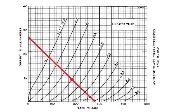

OK, thanks everyone so far, we're almost there. I should just mention that my questions are circuit related, as in, I'm not actually saying I have a problem, so of course, turn down the volume if it distorts too much. I'm just curious from an electrical standpoint. So, with that said, hear me out one more time. IF, using cerrem's numbers, we have a 12V swing from the input stage, then according to my eye, virtually all of that amplification cannot be used if I apply it to a 12AX7 chart. This chart, with an added arbitrary load line, would seem to indicate the ABSOLUTE limit of allowable grid voltage swing is +/- 2V (can't go above 0 right?)? If so, two things - what then is the point of amplifying to +/- 12V? Also, with this being a 5F2A Princeton circuit, which I've built, how is it I can turn it up all the way, albeit with distortion, but it's still musical - as in it doesn't cutoff, etc.? Thanks! Am I making sense?
So what actually happens if you feed it a sine wave, from a high impedance source (previous triode), with an unloaded peak to peak 12 volts? What happens when that absolute limit is exceeded?
The next triode has Vgk maybe (-1.5 V). As you said, the grid can't go above 0 V (more or less). So the triode responds more-or-less linearly to the signal swinging positive from -1.5V to 0 V, then clips off the rest of the positive half cycle. At the anode, you get a negative-going half-cycle of signal, heavily flat-topped (or should that be flat-bottomed?)
And for negative input half-cycles, once the signal swings from -1.5V to roughly -4V, the triode cuts pretty much completely off. It's anode voltage has now risen to nearly the full B+ voltage, and there it will stay, until the input signal once more rises above -4 V on its journey back to zero volts.
So the output is heavily flat-topped on both positive and negative peaks. But it's not as if anything explodes, or the universe ends, or the world stops turning. You just get a distorted output. Which we may like.
It probably does cut off, on every half-cyle. And saturate, on every other half-cycle. Unless you have a very low-output guitar pickup, play with a very light touch, or have the guitar's own volume control turned well down. It's precisely because it's saturating and cutting off that it sounds distorted.

#1. we have a 12V swing from the input stage.
#2 How is it I can turn it up all the way, albeit with distortion, but it's still musical - as in it doesn't cutoff, etc.?
#1 The first stage pre-amp is capable of driving to +-12V only if the loading is a high impedance passive load. The 2nd stage loading in the circuit posted will prevent it from reaching much pass zero voltage. As the output voltage of the 1st stage go near 0V, the 12AX7 of 2nd stage grid will begin to draw current. This will begin push the 1st stage output voltage down (clipping). The 100K anode resistor is doing that. The 2nd stage input will never see 12V.
#2 An easy way is put a say 10K or other resistor in series of the 2nd stage grid (aka: Grid stopper) . This will drop the input voltage in a more linear fashion (a different sound).
All above are excellent explanations.
Let me add just one detail: yes, strumming hard and with volume pot on 10, next grid WILL clip.
To be more precise, it will chop any positive swing above +2V because you have a "hidden in plain sight" Grid to Cathode diode, the Grid being its anode; you can swing down as much as you like in the negative side because it will be reverse biased.
Yet "it doesn´t matter"
Why?
Because way before that, the power stage will be clipping , so any added earlier stage clipping will be masked by it.
