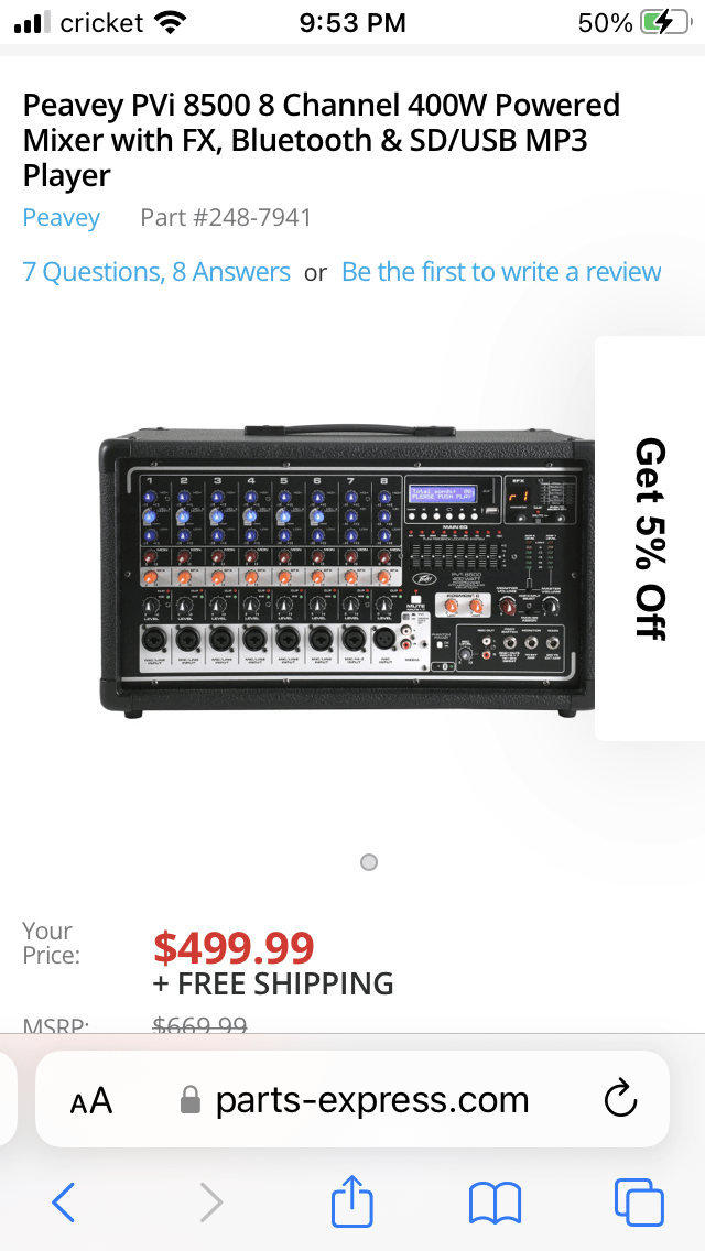

Hi everyone. Nice to be here. I recently purchased a new powered mixer for my gospel music ministry. I’m confused about a couple things. On the front of the mixer is a Jack and it’s labeled” Monitor” above the Jack and “to ext amp” below the Jack. And on the back, one output is marked “ Main Main” and the other is marked “ main monitor”. Ive got 2 speakers for the house, and 2 powered Alto monitors. Please help with the proper hookup! Thanks all!
Here you go. Peavey PVI 8500

The two unpowered house speakers connect to the back panel outputs. Those are badly labelled. The powered monitor speakers go to the monitor output if you want a different setting in your booth than what the house speakers are getting. The front panel is line level outputs, while the back panel are already amplified outs using TR sockets. Hope this makes sense
