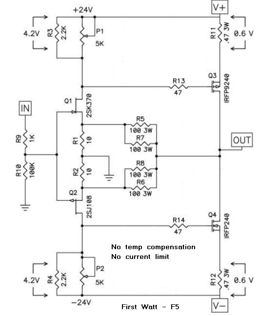

Thank for the reply Mega
Are there equivalent replacements for the 2SJ109 2SJ74 2SK170 & 2SJ74 that are suitable or do they have to be used.
Also when I meant cascaded I was referring to the concept below with more fet's in parallel for higher current...or am I being a numpty.
The concept I was playing on goes something like this. I know it is incorrect in many aspects, but it was all I could CAD up since my post. Criticism and/or ideas welcome. I know it is an AB amp, but I was thinking with enough bias and a decoupling cap it could operate as a class a. Either that or have a single rail suplly and run it in bridge mode. Again I am a class a newbie....sorry.
If the pic doesn't show please someone tell me how.

Most people here try to avoid opamps, if they can.
So while it might work, it may not be the best solution.

It's not that op-amps are bad...
My personal reason for avoiding op amps is their lack of ZEN. They may make the designer's life easier, but they are anything but simple on the inside. Most of the amps in the Pass forum are of a simple nature, much like your cascade--minus op-amp, and, philosophically (some would argue audibly), desirable.

Op Amps make me shudder. I can't get past the 741, which was "perfect"in the day. Op Amps have 60 or more db of open loop gain and 3 or more gain stages. The 741 started to roll off at 10 Hz. 😕 There are much better op amps (or so I have been told). To me, an op amp front end would be easy to do, but very hard to do right. I think a low parts count discrete front end is the way forward.
As far as capacitance, it depends on the size of the amp. For 25 Watt class A, look at the F5 and make the caps on the same order of magnitude and use the thermistors.

will you be water cooling the F5? If you live fearlessly then by all means....I built it this way, it worked great until I biased up to 3A @ 35V. You can parallel the outputs...which in hindsight is what I should have done from the outset. There's a schematic floating around in the F5 thread somewhere about it.

Well to be technically correct it's not watercooling....it's a non-conductive liquid called Feser One so we shall dub it F1cooling. Use it in my PC and works a treat. At full load (around 250w) runs at ambient plus 7 degrees.
that is almost three times the designers recommended bias current.water cooling the F5? ..............
.............it worked great until I biased up to 3A @ 35V...........
A dissipation of 105W/Q cf 33W/Q is rank stupidity.
Did you look at the SOA of the devices you overloaded?
Did you calculate the reserve power to drive a load at that bias current?
Did you think
Maybe water cooling is a miracle worker!
skimmed over it, made a paper airplane out of it.Did you look at the SOA of the devices you overloaded?
No calcs. Had 480,000uF, 1500VA transformer, then variac.Did you calculate the reserve power to drive a load at that bias current?
Totally over-rated. In the grand scheme of things, I did keep a fire extinguisher handy, so there was a least some thinking happening.Did you think
I knew full well it was on borrowed time, about 30 mins actually, and it sounded wonderful! Its DIY dude, if you're not blowing something up, you're not having fun. I did find some industrial cooling plates, so that definitely looks like the way to go.
