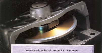

this suspension and anti vibration stuff is what a manufacturer is easyily able to do, not too expensive, consumer belive it improves something, and its usefull for the marketing guys... ok, maybe it helps - but does a well designed transport needs this addidtional stuff?
take a look at different transports.
http://www.daisy-laser.nl/
Mr. Thevissen from daisy laser explayned me, if i understood him right, there are two kind of transport. Those that sell for about 6 USD each if you buy >1000, and those that are >200USD each. One difference is software, another how stiff is the construction (have a look at CD PRO 2)
- and main difference if there is electronics behind the laser on the moving head (good, expensive, less errors) or is there only the laser diode on the moving head and a "long" (few inch?) cable to the electronics (cheap, head has less weight, weak actuators possible... and more errors because signal from diode comes with lot of noise or so)
