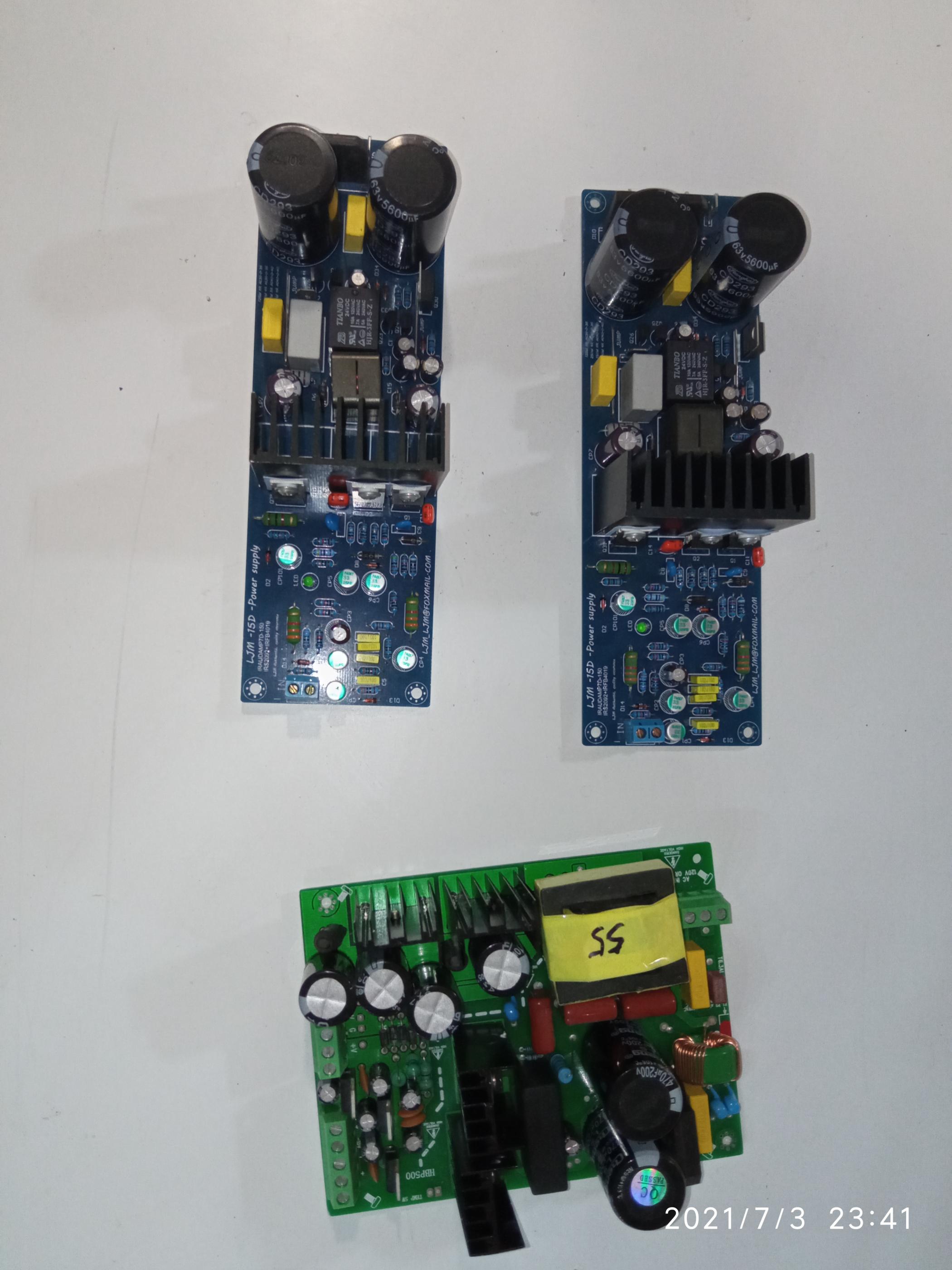

You always run into this problem if you connect some kind of sub to any system.
Talking about new gear, Amps have come a long way in 2021. I heard my first D-amp in 1985 by the way, from Sony HIFI. No new stuff.
This forum is full of threads about A, A/B, H, D amps, with transistors and valves, conventional and switched power supplies.
Any principle can give you perfect sound quality, without a chance to hear any difference between really good amps. Any other opinion is just that: opinion.
I give you a short, final and realistic conclusion: The worlds best amp, considered quality, will be a D-amp powered by a switching supply. An A or A/B amp could catch up on sound quality, but considered energy consumption, the winner is clear. Even A/B amps give better results with switched supplies, as bitter as it might be for fans of heavy amp's.
You will have many people who disagree, but that is fine. Just like talking about a good steak. Some will swear on a Scottish cow, some on the animal from Argentina, but in the end a good steak is a good steak.
That transfer to HIFI means you are free to take what sounds right for you. Today it get's hard to buy really crappy HIFI or PA amps, some really cheap stuff your aunt could spot, excluded. Alibaba, ebay and Amazon are full of such crap.
If I needed to do a decision for you, on the spot, I would point to two of the mentioned Behringer amps

Sorry, but your cousin can solder until his hands fall off, he will not build anything that is better than that, even if he had one year of time.
( I'm no Thomann fan boy, by the way, but they are really reliable, their service first class and prices hard to beat. Best, in their shop you find most products that are on the market today. Read what people write about the products, add a grain of salt and you know what you can expect. Competition between low cost PA stuff is incredible hard, the "t" stuff from Thomann and Behringer line are high quality for low money today. Forget what the old guys say about Behringer. That was 20-30 years ago.)
