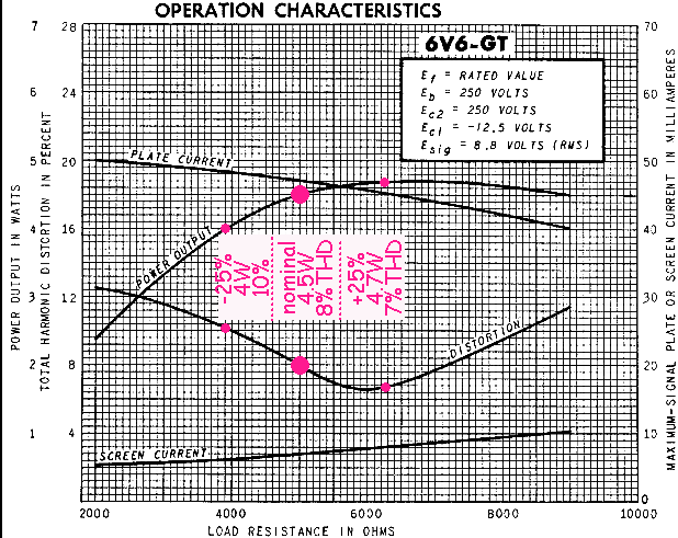

> amp to speaker matching is quite critical
Don't listen to innernet chatter from guys like Andrew, JM, orTubeLab. And especially that kook PRR.
Do tests. If you lack test facilities, use some of the heaps of old hand-compiled data collected when tubes were mainstream.
I attach the flawed data for 6V6. It needs a Torah's-worth of interpretation, but is not wrong. Going 25% either way from "book suggestion" gives very slight power difference, maybe 1dB (not 20%/2dB). If you are just 1dB short of your goal, you don't need 1dB, you need twice the tube so you are not so close to coming out short. Likewise the THD numbers (AT that point) can all be covered with one thumb.

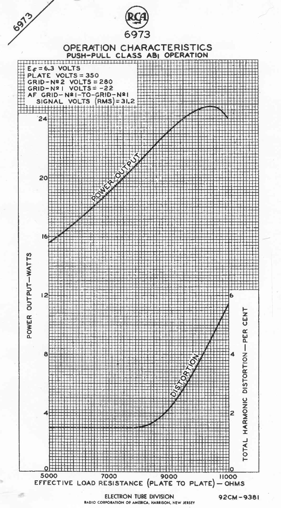

The 6V6 distortion curve PRR posted above is for class A, single tube operation I believe.
When going to P-P (class A or AB1) the 2nd harmonic distortion will cancel out, which was causing most of the high distortion at low Z primary (left side) on the 6V6 SE graph (from gm variation versus current).
Here is a 6973 tube distortion graph for class AB P-P versus load Z. Notice the lack of the left side incline (low Z primary distortion) now. What is remaining are the remaining odd harmonics: from screen grid current distortion (curved individual plate curves, affects more at high Z) and gm curvature with current (decreasing with higher Z). [Normally there would still be some smaller incline in the distortion on the left side, with lower Z loading from gm variation, not the flat line shown here. Maybe this tube is exceptionally close to square law (Vg1 to Ip) for its gm curve, ie mostly 2nd Harmonic gm dist., which cancels in P-P]
http://tubedata.milbert.com/sheets/049/6/6973.pdf
I've seen some tube data sheets that show the individual harmonic distortions versus load Z, but I don't recall which tube datasheets had that.
Using Twin/Crazy Drive for a TV Sweep tube produces near constant gm versus loading (load line tilt) with straight plate curves. (2nd pic) So loading accuracy is a non issue there. (there is still max power variation versus Z load though)

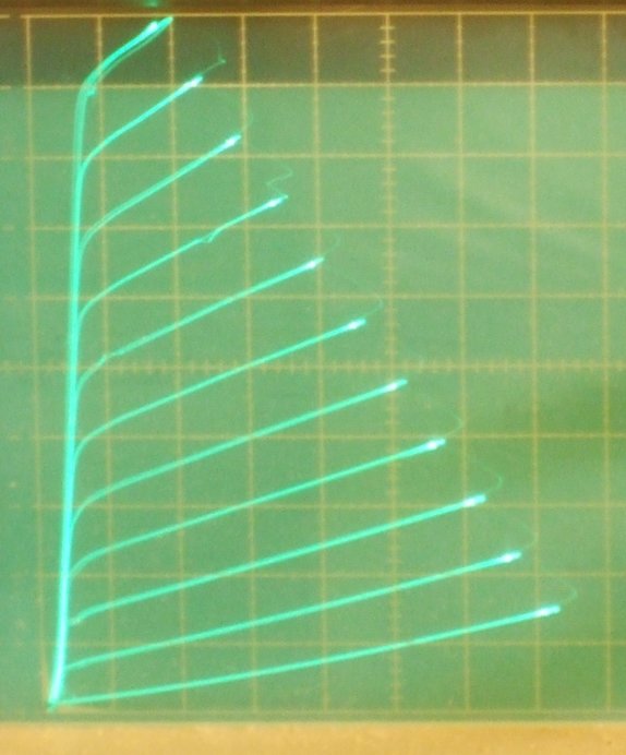

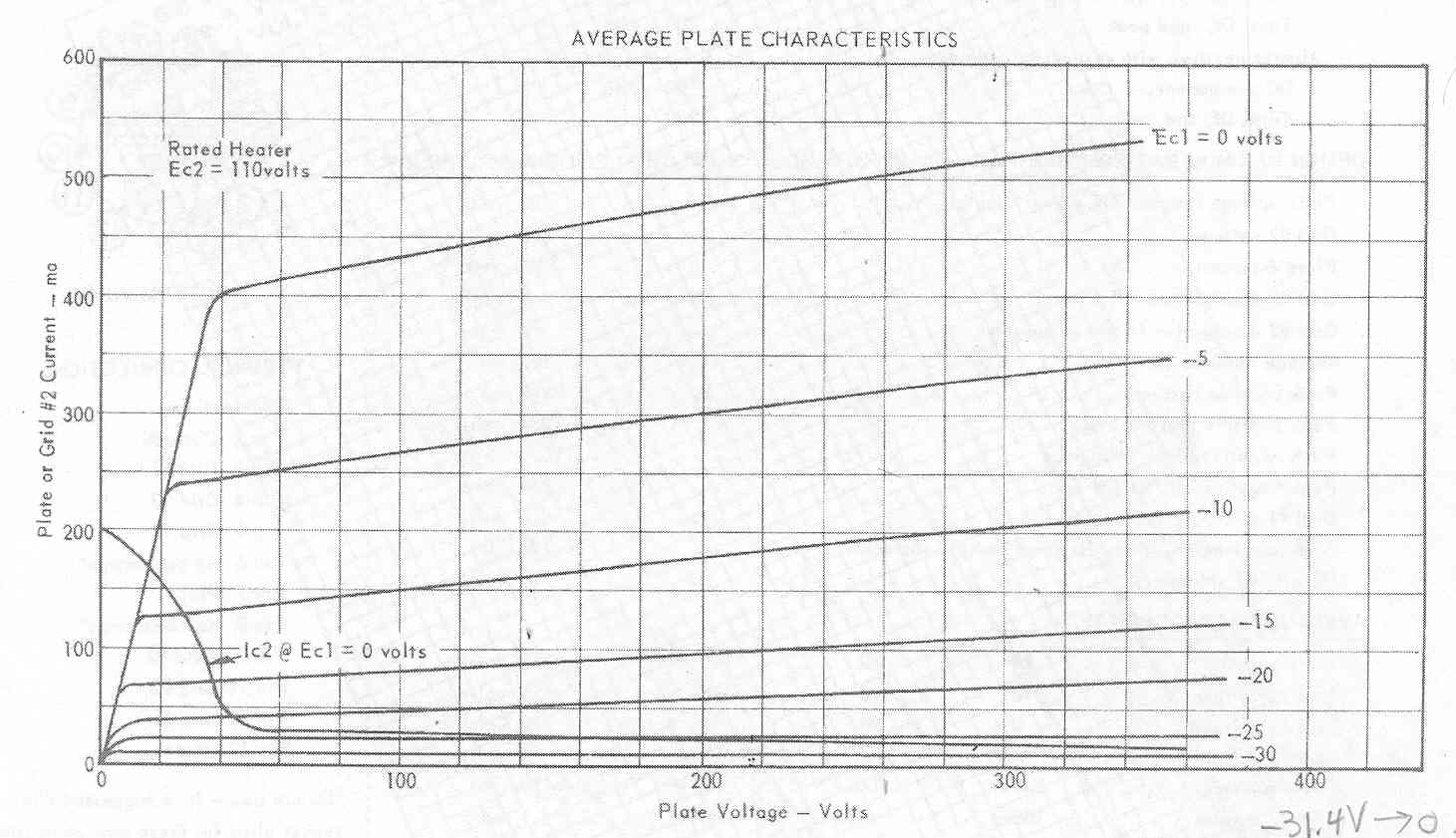

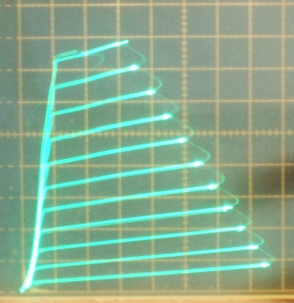

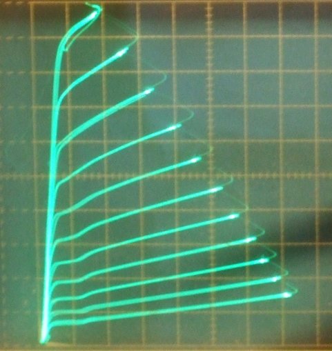

Late addition.
Here is the same tube (26LX6, as the 2nd pic above) with normal grid 1 drive. Placing any load line on this graph will show the obvious gm variation versus loading (ie, versus load line tilt).
Increased curvature in the individual plate curves also indicates/causes screen grid current distortion here too (ramping distortion at high Z loading). Although this tube has fairly straight plate curves where it counts.
If you believed tube manufacturer's datasheets, this (2nd pic, 6HJ5) would be the most linear tube on the planet (straighter than straight plate curves) when assisted by using Twin/Crazy drive to even out the gm. But, reality is not quite this impressive. (3rd pic, 6HJ5 using Twin/Crazy drive) Still a little curvature in the plate curves yet. Maybe this (4th pic, once a $1 tube) can claim that title.
