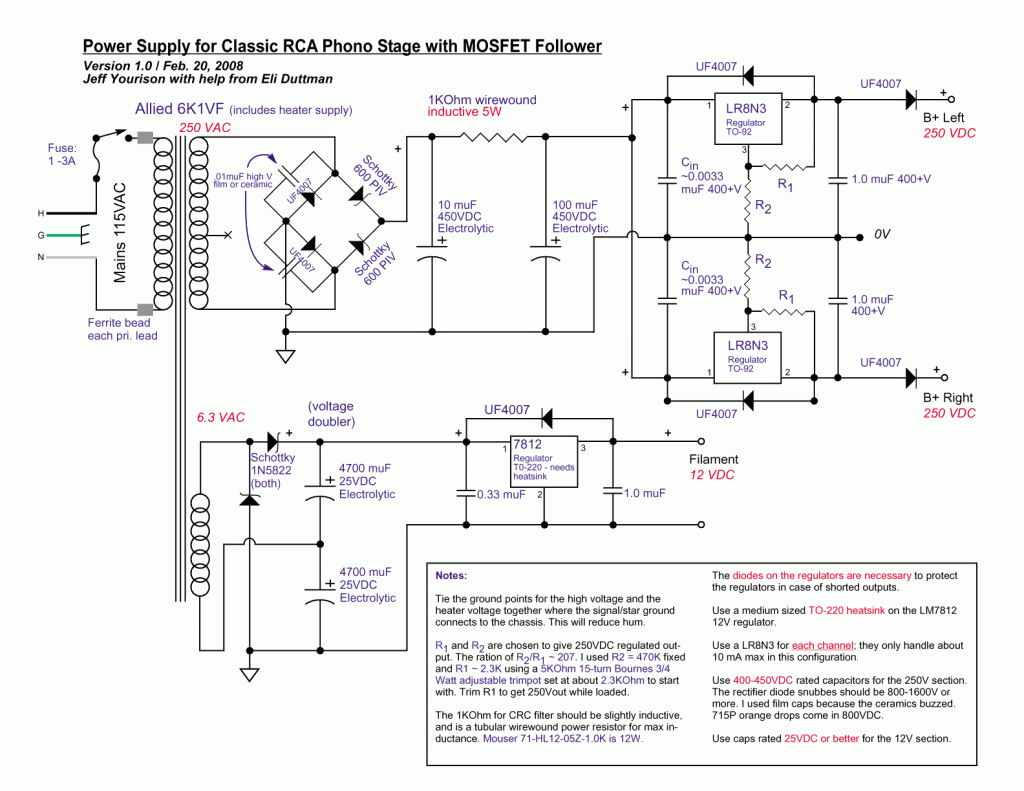

I built the schematic Rongon found and added the tweaks in blue after further discussions with Eli and others. These balance some changes made in adding the follower stage and grounding the second section cathode.
Either the 6n2p-ev or a quiet 12AX7 will work well. I have tried both the Sovtek 12AX7LPS and the Mullard re-issued 12AX7 long plate, and they sound great.
After blowing the follower MOSFET from (1) a static discharge and (2) detaching and reattaching interconnects while everything was on, I'd suggest adding back to back 15V 0.5W Zeners between source and gate.
The Panasonic 0.47 muF ECP-Q(U) bypass cap on the output is getting hard to find. The SBE 716P film and foil cap would be a good replacement (not the 715P, which is metallized film). The GE 5 muF cap is metallized film, and there are similar types that would work.
Eli recommended to me that the 30 muF decoupling caps should be motor run oil caps or at least metallized film caps, not electrolytics. I am using Solens at the moment, because of space available. They work fine.
There is an associated power supply for this build, attached. It provides 12VDC regulated to the 12AX7s and 250VDC regulated for B+. Change out the heater doubler and the regulator for 6V tubes.
Overall, this is a great sounding phonostage, and with a Shure 97xe MM cartridge with ~4mV output, the gain matches the output of a typical CD player, so no additional pre-amp is needed if you normally don't need one for a CD input.
