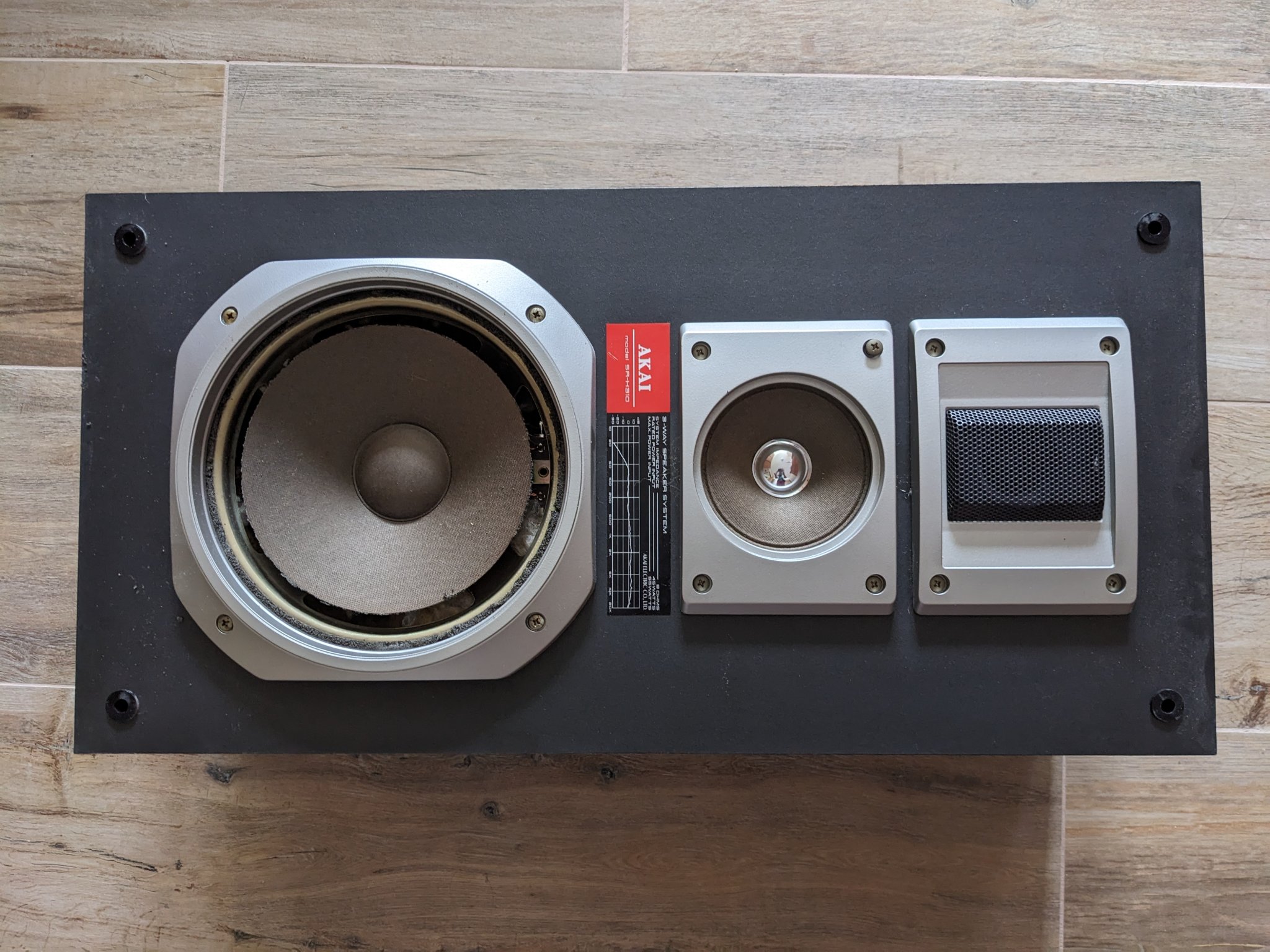

I'm looking for help on replacing an old speaker set.

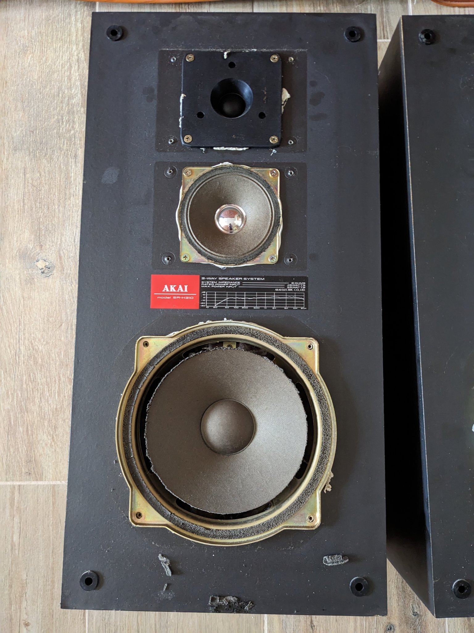

I have recently gotten an old speaker set from my dad. A pair of AKAI SR-H310's (Photo attached).
As you can see they aren't in the best shape.
I am looking for help on how to replace these speakers and with what speakers I should go with.
Or if it is beter to just buy a kit (speakers and cabinet)?

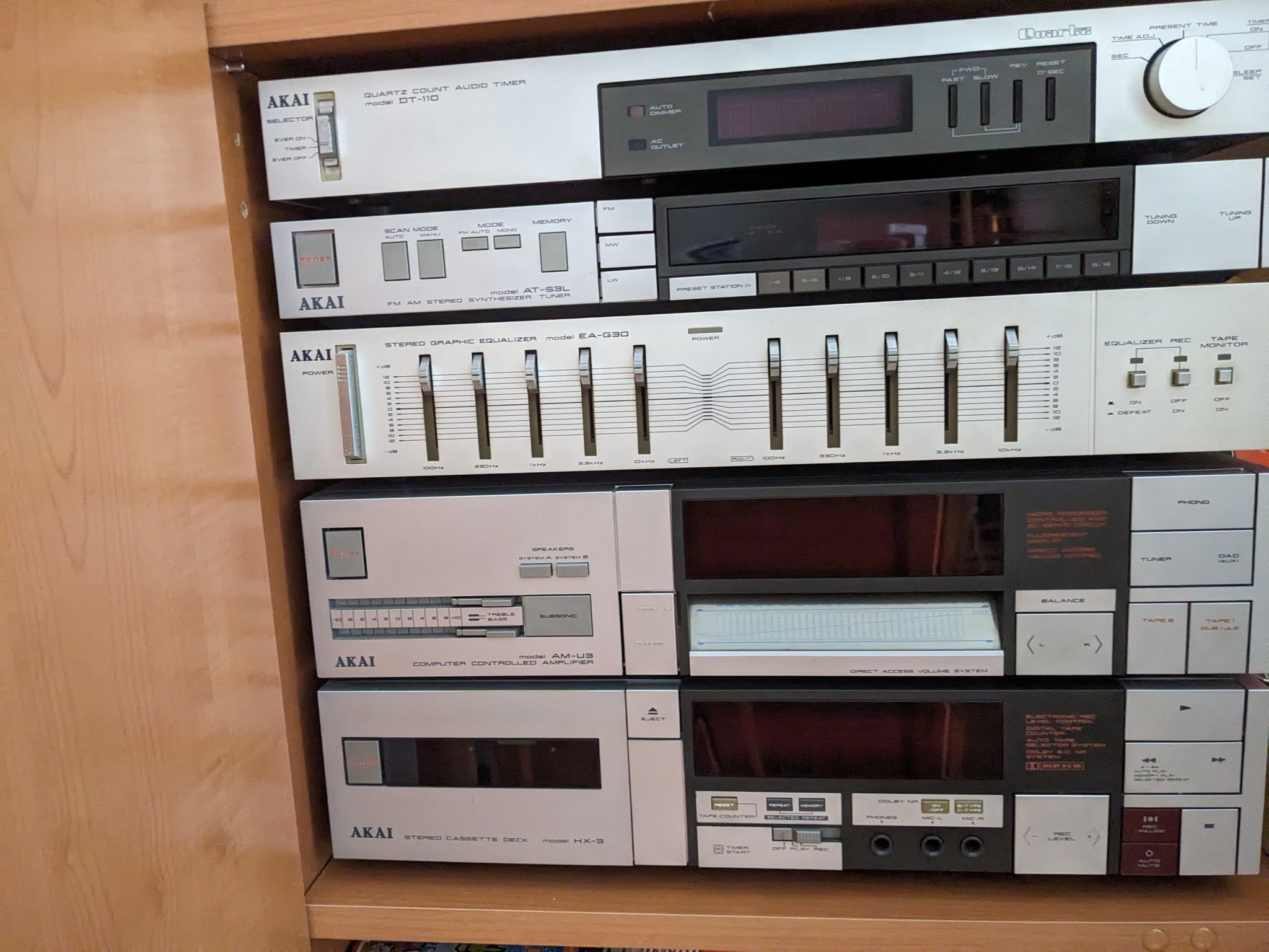

The speakers are going to be hooked up to the AKAI AM-U3 amp.
(See photo attached)
I do not have any experience on this topic so any help would be appreciated.

Hi, an interesting restoration challenge.
By the looks of things only the bass unit may need a re foam, the mid and tweeter drivers might be fine. If you have no sound from any of the drivers you may have to use a resistance meter to verify that the voice coils are still connected.
Firstly i suspect removing the trim rings will allow you and others here to see what the midrange and tweeter are like. The paper mid may have a paper suspension and hopefully that will be intact. As to the tweeter it maybe another smaller paper driver behind the fancy cover. Some more images will help.
For re foaming the woofer you will have to carefully measure the outer diameter and measure the width of any remaining foam and then measure the diameter of the speaker mounting basket with these dimensions you can at least search to see if a matching dimensions re foam kits exist. Possibly you don't feel confident about doing a re foam, so maybe a friend or local repair shop could do this for you and there are YouTube videos you can watch on how to do this.
If the other drivers are fine, but the refoam doesn't appeal we will have to know the speaker dimension's, easy when you have removed the trim rings to see the chassis. Then you will carefully need to unscrew any other mounting screws and gently ease the speaker out of the chassis to enable you measure the internal cut out dimension's/diameter. Also needed are the box dimensions and the approximate thickness of the box material so people can work out the box volume. Once speaker size and box dimensions are known somebody should be able to suggest a replacement and maybe a tweak to the crossover components.

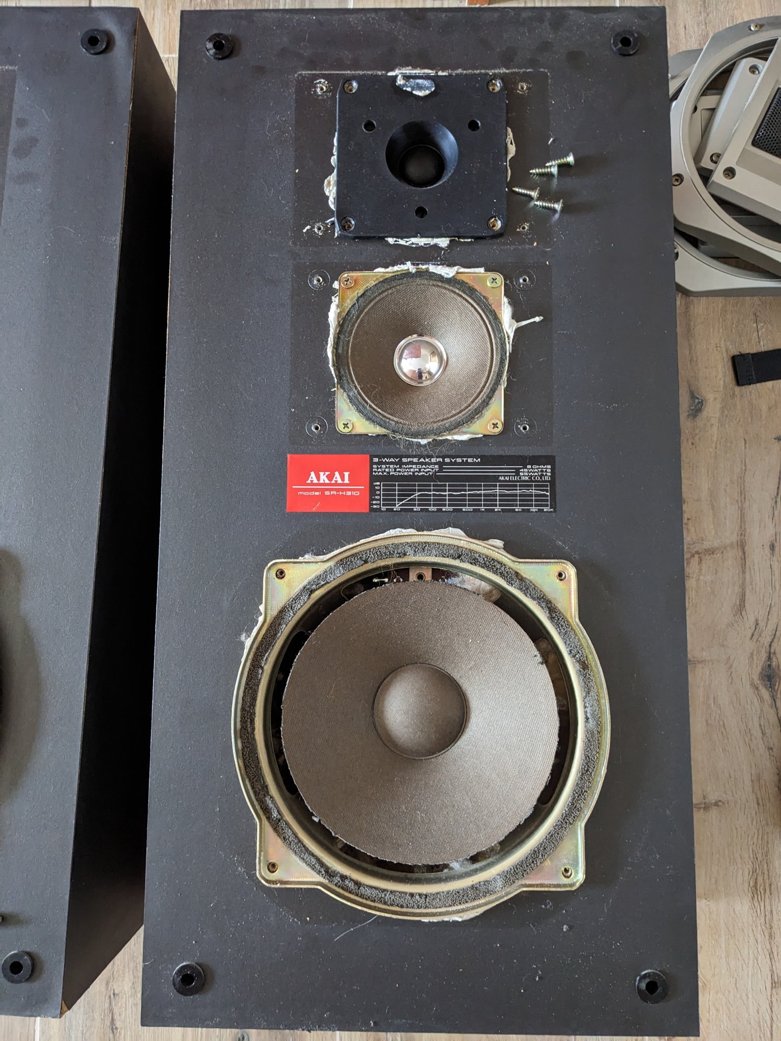

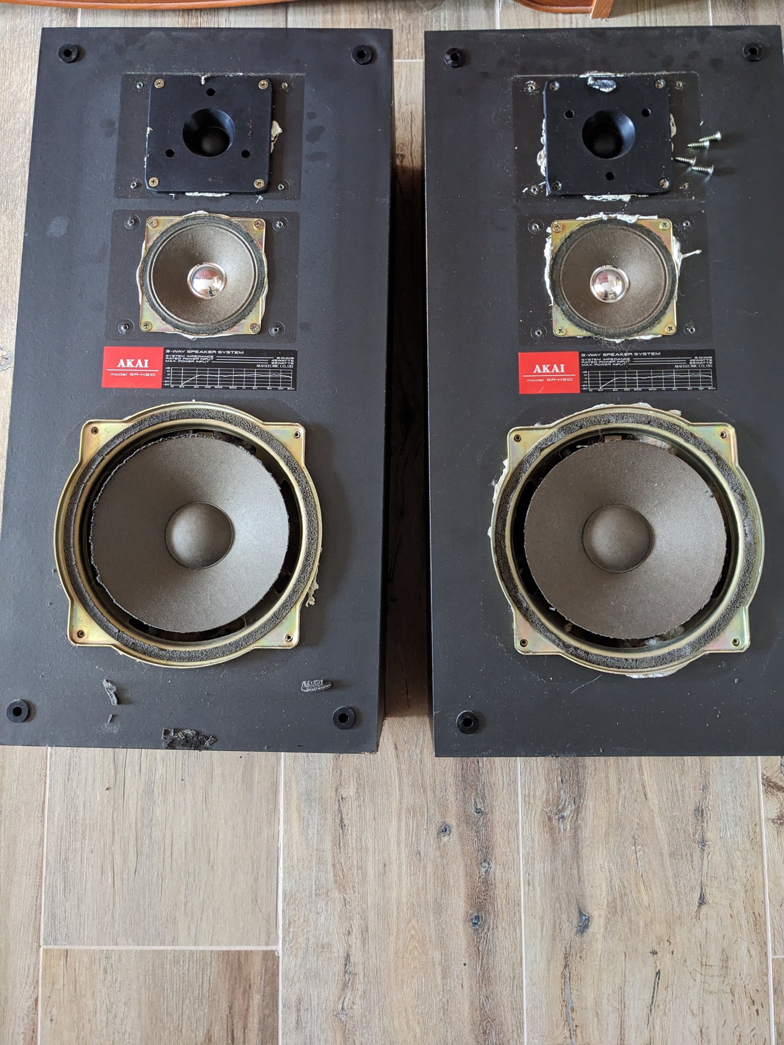

Hi
Thank you for taking the time to response.
I have attached the pictures without the covers.
I have done some resistance measurements on the terminals and one speaker gives about 9-10 ohms the other gives a infinite resistance value.
I do have the original documentation for the amplifier but nothing on the speakers.

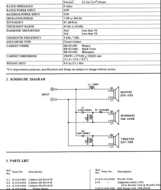

This is something i found on the internet.
Which suggest the Xover shouldn't be difficult to de bug.
If you can find which driver is broken or which wire has fallen off, or a component that gone open circuit that a bit more progress..

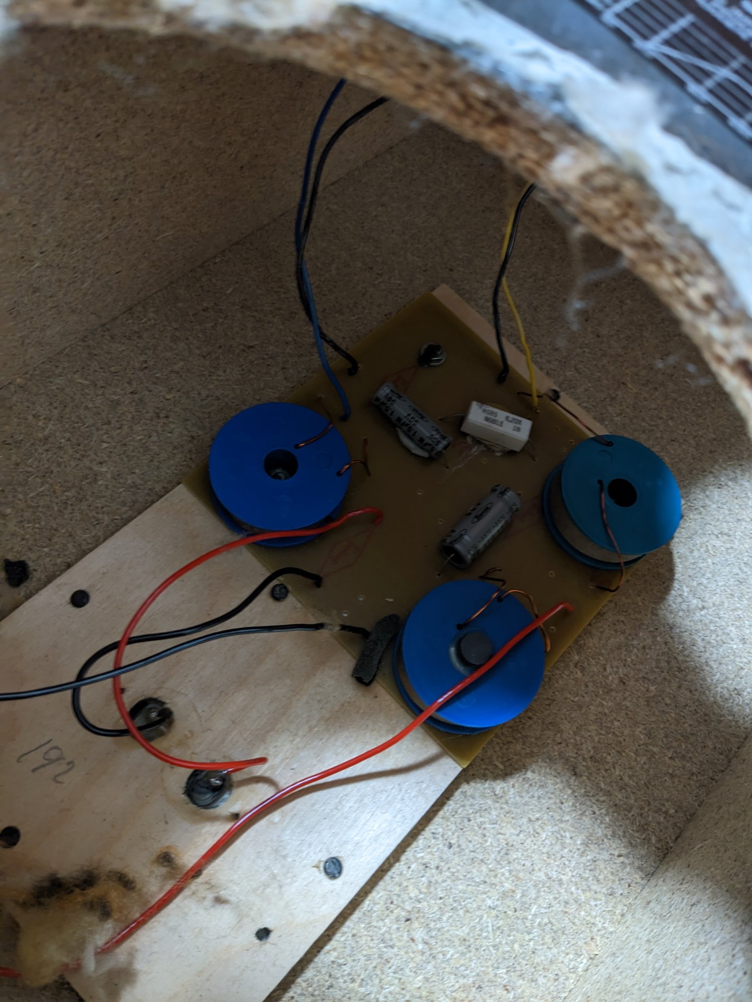

Just took out the speakers and one cable was missing from the woofer terminals.
So that is an easy fix to resolder that.
As for the components inside everything seems too look fine (See photo).
I did some measureing on the tweeter and the mid and the resistance seems to be all over the place and not stable.
Am I doing something wrong here?
To verify the drivers impedance or the resistive element you need to measure across the driver terminals without the Xover components being connected. if the driver is not disconnected for the measurement you will see the impedances of the crossover components and the capacitors being charged from the Meter battery which will give you an initial low reading and then very high resistance.

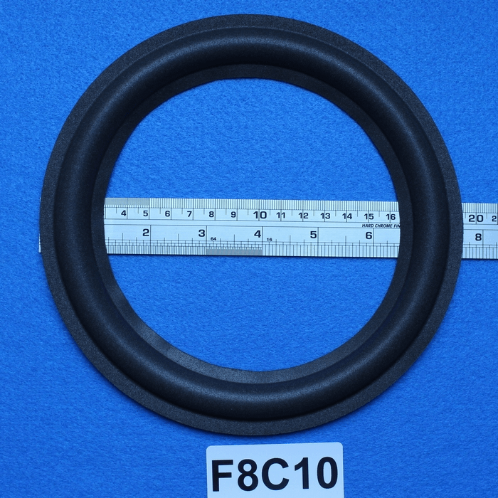

I have measured the woofer foam ring (or whats left of it) and these are the following measurements:
Basket diameter14.8cm
Outer foam ring diameter19.3cm
Width of the foam ring on the outside8mm

Would this foam ring work for the woofer:
Site: Foam ring
The exact sizes of this ring are, in CM: 19,25 - 17,85 - 14,8 - 13,7
This surround is angled.
The flexibility of this surround is indicated with number: 2.

I think that foam you have picked should fit your measurement's and the links you have provided look to be right, although the flexibility property is one that is a bit more tricky, but the value of 2 seems like a sensible choice with the sealed cabinet.
As to suitable glue they should suggest or sell you some with the foam surrounds.
I imagine you could also drop an email to the provider and tell him they are for your particular Akai design, he may have this information in his customer database or his own references. They are usually helpful in my limited experience of re foaming.
As to a suitable replacement for the bass speaker possibly a monacor SPM 205 (89dbs Paper and relatively cheap) or SPH 210, (90 dBs Polypropylene, more expensive, probably better for a completely new design) you will also need to check their dimensions.
