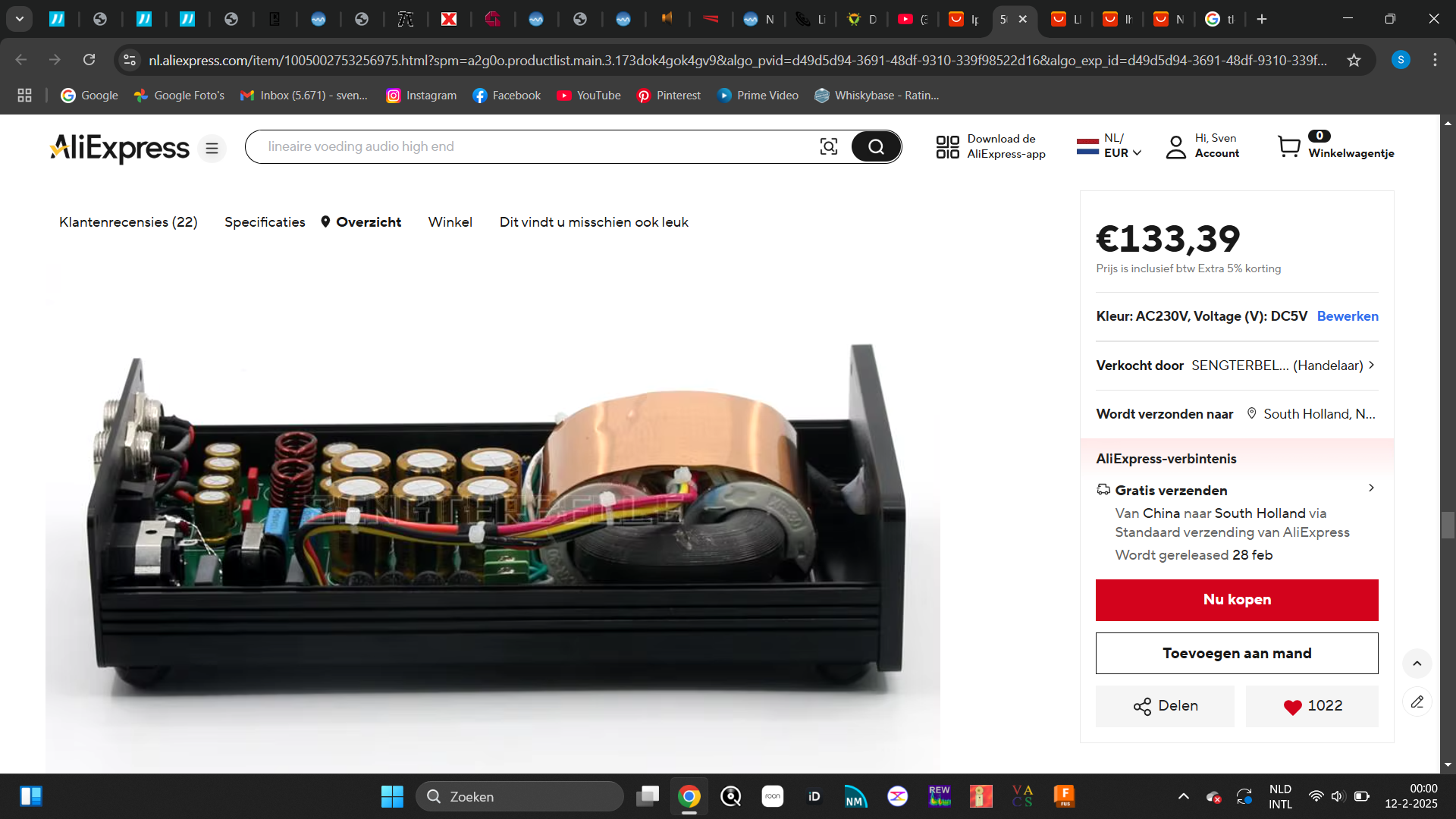

Would something like the internals of this be good for powering the opamps? It uses TL431 regulators. It's capable of 50W at an adjustable 5 to 24 V. Would something like this with an R-core transformer be best or would some smaller module do just as good for the application?
And still trying to figure out how to get a good functioning standby with no pops during powerup.
