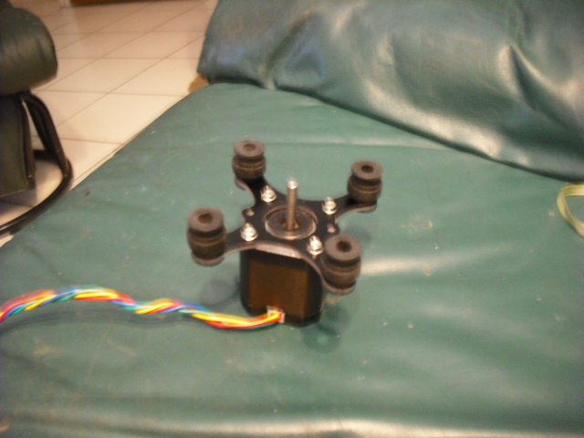

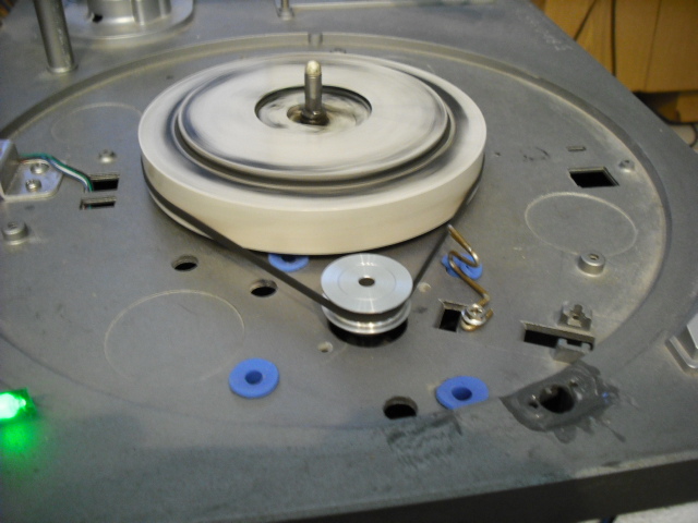

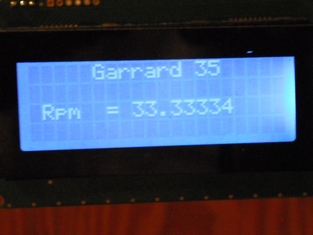

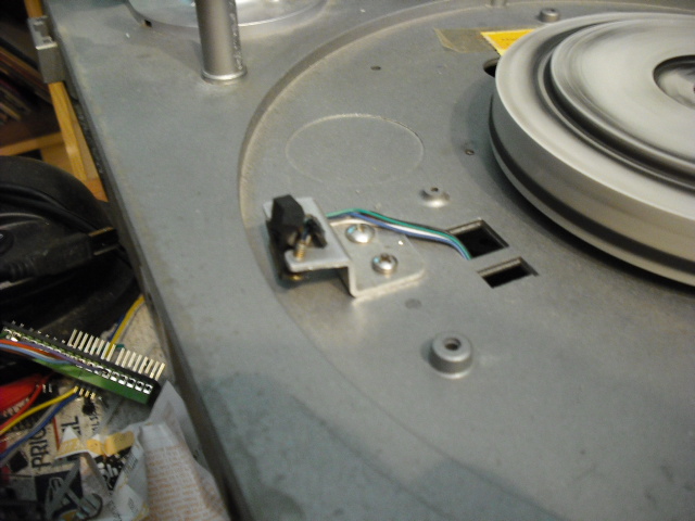

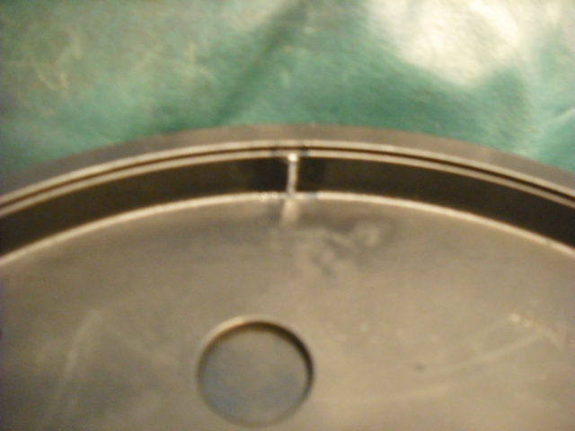

I had an old Garrard 35 turn table that I was going to discard it because a worn out motor. Then decided to see how to replace the motor and after some researched decided to use a stepper motor. To mount it used an RC helicopter fiber glass rubber mounting to hold the motor and reduce the vibration. Used a micro and easy driver to control the stepper motor speed to 33.3334 rpm. The speed it is control by reading an index marked in the platen with and infrared sensor. Then use the micro to calculate the speed of the platen. Every thing it is simple and easy to do project. It can be implemented in any turn table. It worked good and the sound it is good. Attached are some pictures of the controller, how the motor it is mounted ,the index marked in the platen and the sensor to read the index marked and the display.
