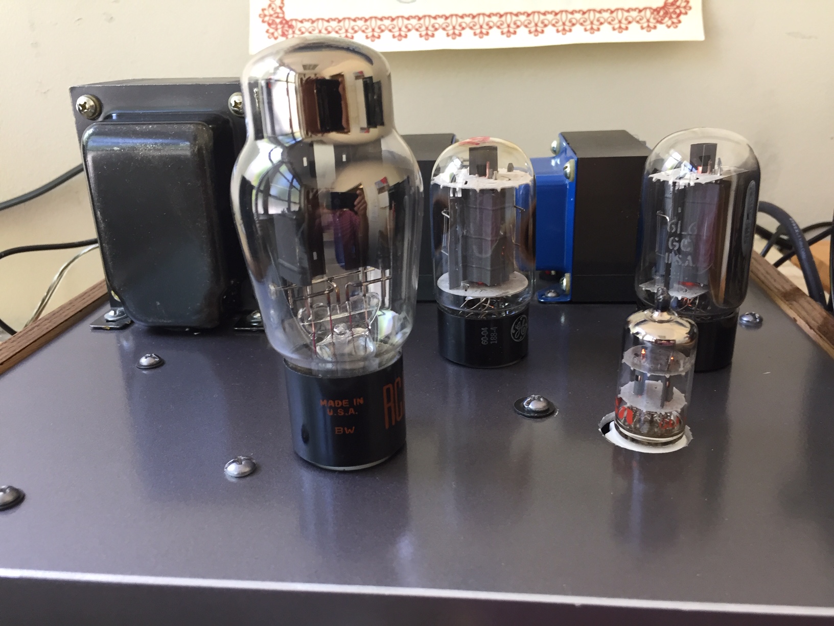

Greetings- I recently bought a Tubelab SSE from a DIY Audio member. It arrived in good shape and it's been on everyday for eight hours minimum.
Today I measured the the B+ voltage (at R4 near the end of the board). It measured 473.4 Vdc.
Cathode voltage of each power tube measured between ground and the end of R17 and R27 respectively +38.3 Vdc and 38.1 Vdc.
Cathode resistors = 680 ohms, so the cathode current is ~ 56 mA per output tube.
473.4 Vdc - 38.3 Vdc = 435.1 Vdc
435.1 Vdc X 0.056 A = ~24 Watts dissipated per output tube. I haven't noticed any red plating or bright spots in the tubes.
Is this too high a B+ voltage? Would it be better to run a different rectifier tube? I have 5U4, 5R4 and know that the power transformer 5V section is rated for 3 A.
Thanks!

If it's the one I think it is you have 6l6's in it .The max plate dispensation for that tube is 30 watts and the max. voltage is 500 volts.Your fine all around.

That transformer has enough filament current for any tube in that pic.Your limiting factor as far as tube choices will be the voltage and dissipation specs of the tubes.
The 6l6gc you have in there is ok(Its a Russian version).You would be good with 6550's ,EL34's (though the plate specs is 25 watts so it would be close,but then again it might bias up at less than 25 watt dissipation.).
The Russian version of the 5881 tube is the 6n3c-E.I've used these tubes with 450 volts and biased to 25 watt dissipation for years .Really a tough tube and pretty cheap through the auction site.
Also remember these various tube will all bias differently so you would have to check them in circuit.The two tubes you wanted to try just happened to be the weakest spec wise.

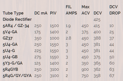

Here's a list of rectifier voltage drops .Might give you a good bit of leeway.(Click to enlarge)

Suppose I wanted to install a 5U4 rectifier tube using the Russian output tubes. I would need to watch for red plating and power transformer overheating, correct?
If you go from a gz34 to a 5U4 you should drop about 20 to 25 volts(drops more as the current through the rectifier increases) which should make the tube bias lower also.It should make the output tubes run cooler.A good thing.

With the 5U4 tube you should be about 400 volts across the tube (B+ to Cathode).I'd really only discount the metal 6l6 tube at this point.The 5881's you have are good with 400 volts or so as long as they dont bias too hot.(more than 25 watts).
Just realize the 5U4 doesn't have the slow warm up capabilities the GZ34 has.It goes to full voltage almost immediately .
