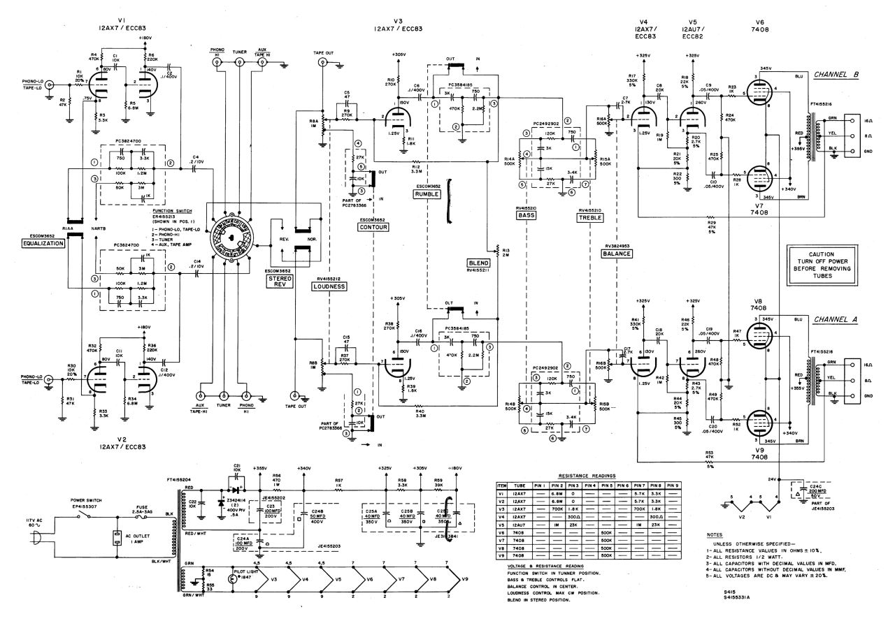

The voltages in the schematic don't agree with the data sheet.
And your measurement look like from worn out tubes.(or heater voltage to low)

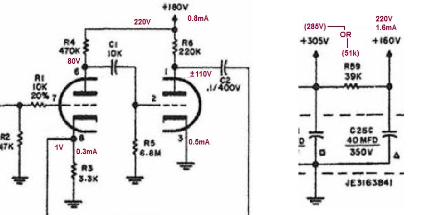

> V1 p1 140v (103v)
> V2 p1 140v (265v)
V1b/V2b is grid-leak bias. The exact plate current will vary a LOT with different tubes. In general the tube will adjust itself to a high-gain condition, which is what we want. The exact plate voltage should not be very critical, because signal level here is still small.
103 vs 140 is not to worry.
265V for 140V is clearly quite wrong. V2b is not sucking current. Suggest bad contacts. Also as-said, move tubes around: either trouble moves with tube, trouble stays where it was, or trouble vanishes (bad contact due to tarnish, "fixed" by working pins in sockets).
265V is double-odd because plan shows only 180V going to this section. "Dead" V2b explains some of that rise, and I suspect the voltages and parts on the plan are very approximate to how it got built and how it really works.
I would NOT rush in with wholesale part replacement. Tarnished tube and switch contacts, bad tubes, leaky caps... start with the things that do go bad with age.

1. Measure the voltage on pins 4 and 5 of v1 and v2. You need to see somewhere between about 11 and 13 volts there. As Eli posted, the heaters of the 12AX7s are powered by the current through the output tube cathodes. It works but you can do much better. Nonetheless be sure it is delivering somewhere near 12 volts DC from pin 4 to pin 5 in each tube. If the voltage is too low the 7408/6V6GT tubes may be tired. Let us know what you find.
2. Test or swap V1 and V2 for known good tubes if you get proper heater voltages. Clean the sockets well to ensure good contact - the tube pins too. I won't be surprised if this step fixes the voltage problems! Also, you can find good cleaning info here: https://www.audioasylum.com/messages/tubes/253369/
3. If you are measuring resistors and want to be more confident in the results you may need to lift (disconnect) one end so that the resistor is not in the circuit when you measure it.
4. I think you may have a measurement error on the V1 and V2 pin 7 measurements. It should be about 57K and the fact that you read 5.7K on both resistors (1/10th of the correct value) makes me think you misread your meter or such. Of course - being a big time expert I've never made that mistake. 😀😀😀
5. Just replace the 6.8 Meg resistors. They aren't expensive and the new metal film resistors are very quiet. Really after 50 years MOST small wattage carbon composition resistors are ready for replacement. The same is true for the capacitors in the unit - they are well past their normal lifespan.
Keep in mind you are probably encountering multiple problems. Solving one may not solve them all - but you have to start somewhere. I think that you have a usable game plan using the steps above.

so I'm reading 24v-11.4v-11.5v-0v going from 4-5-4-5. So heaters look good.be sure it is delivering somewhere near 12 volts DC from pin 4 to pin 5 in each tube.
yup, typo on the original post: pin 7 and 8 are 59 ohms😱
the high voltage (265v) follows one of the tubes on pin 1. So must be it's a bad tube?

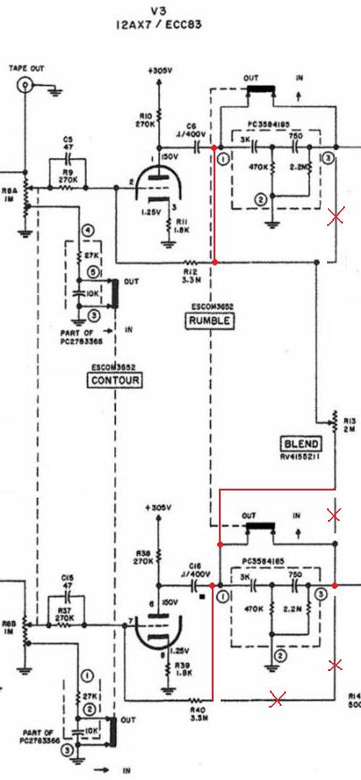

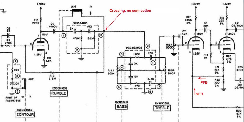

Yesterday i wrote that there is an error in the schematic, but it was me
Well it was late over here and the schematic is a mess 😀
They draw a NFB loop around the rumble filter, like that the result of the filter is compensated by feedback, no filter !
I suspect the real amp is wired like this ...
Mona
Mona
