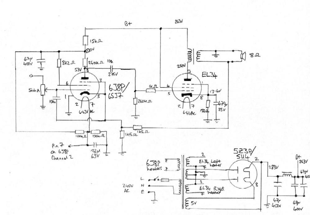

So, I've backwards engineered the schematics, which I think I've got correct.
What I plan to do is to add a much bigger capacitance to 260V B+ (currently 2x 47u in parallel). Or, is it better to change the cap on pin 2 of the 5Z3P instead/aswell? Similarly, I'm thinking of a bigger cap on the 230V supply to the 6J8P's.
I also plan to upgrade the volume pot to an ALPS blue velvet, change to 100n inter-stage cap for something like a Hovland Musicap, and replace all of the shielded phono cable for something a bit more expensive looking!
Anyone got any thoughts on the schematics in general?
I'd also like to know if potential divider arrangement to the 6J8P heater connection can be improved. It's also possible that I'll move change the EL34 heater arrangement to include a hum pot close to the valve instead of a common GND on the back of the mains transformer. The PCB and chassis is designed for this, but not fitted.
When I can find my 8.2R resistors, I'll measure it's output power too....

Just noticed, I made an error on the schematic.
The 100n cap isn't connected to the 6J8P pin 4 / 50K pot wiper - it should be shown connected to the 8K2R / pin 6.
C
C

You noticed the same as I did - it does look very similar to the Sun Audio SV-EL34, which is point-to-point wired. No offence taken. 🙂
That was one of the amps I was originally looking at... Having trawled around, there was some crud that I certainly wouldn't have given £250 for, irrespective of where it was made.
When I started to price up getting the bits in the UK to make one myself, and having to mess around making a chassis (I hate metalbashing), this looks like a reasonable alternative. I've got (what to me) is a good starting point for a bit of tweaking/learning.
I also doubt the transformers are Tamura. However, the mains transformer fills the case with only a couple of mm of clearance. The output transformers are also nearly as large.
From what I can gather of the Sun Audio EL34 offering, this isn't the same circuit as it uses 6N7GT instead of 6J8P's in the front end. But you're correct, it does appear that they've hijacked the aesthetics
😕 Maybe Sun Audio buy their metalwork in from the same manufacturer or these folks just changed the design enough to prevent copyleft infringement?

I found that originally the mains xformer and choke ran a little hot on 240V in the UK - just hot enough to hold in the hand. Most probably it is designed for 220V. So, I now run it through a 500VA 240V-to-220V auto-transformer. This has made it run a lot cooler to the touch. The heater and HT voltages were a little high when powered at 240V, but have now returned to normal on 220V.
It is currently driving an old pair of Roger LS7t speakers, which I believe are a fairly easy load. The frequency response measured on my 'scope into 8.2ohm resistors is fairly good and flat, and sounds fine across my hearing range.
I have replaced the interstage coupling caps, which helped. And also added an extra R-C stage on the main HT supply after the L-C.
Valve line-up is a pair of NOS Sylvania 6SJ7WGT (I think dated 1940-something), a NOS 1950's Russian 5U4 (can't remember what make but maybe Svetlana), and a pair of Svetlana EL34's which I bought new about 15 or 20 years ago.
I did toy with the idea of replacing the output transformers with some Hashimoto ones, but never had the time or spare cash to do it! Similar for replacing volume control pot with an alps.
