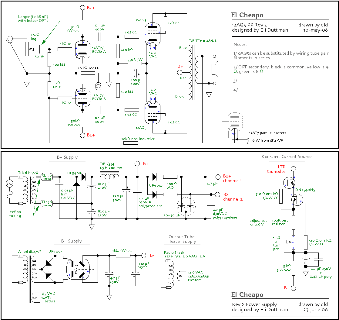

So 10 Watts will probably do but 15 Watts would perhaps be better (to achieve that 102dB).
300B SET will give you 7 to 8 Watts - probably not enough and expensive although if you decide to go that way give me a PM (I have power and output trannies and 300B's for such a project on my shelf in Adelaide, but never got around to it).
Pentode Mode Push Pull 6V6 or EL84 will give 14W and 18 W respectively but require a lot of feedback.
Ultralinear Mode 6V6 or EL84 will give about 10 Watts which may be enough.
Best might be Push Pull Class A Triode Mode EL34 for about 16 watts
Eli's "El Cheapo" circuit could easily be adapted to accommodate Triode Mode EL34.
For Pentode mode EL84 look for SY's "Red Light District"
For Ultralinear mode EL84 or 6V6 look for my "Baby Huey" or Morgan Jone's "Bevios Valley".
If you eventually build the speakers for a flea power amp then there are a lot more options, even a 6EM7 "spud" (single tuber) amp might be enough.

Ian,
I have my doubts about the "El Cheapo" small signal circuitry having enough "sock" to drive both EL34s and the NFB loop. OTOH, 7591 "finals" will be fine. I call such an arrangement "El Cheapo Grande". The amp could be built with triode/UL mode switches, to provide either finesse or power. 30 honest WPC should be easy enough from UL mode PP 7591s.
For several reasons, I highly prefer combination bias for 7591s. "Stand" each O/P tube pair on a 100 Ω/470 μF. network. The bulk of the bias voltage comes from a C- supply. Notice the very convenient test point. Also, only 1 trim pot./channel is needed.

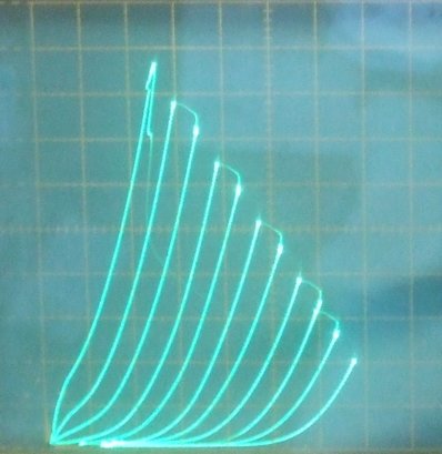

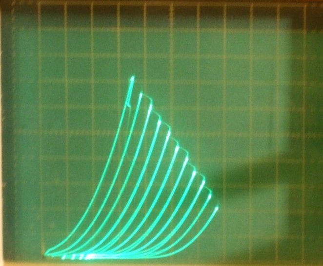

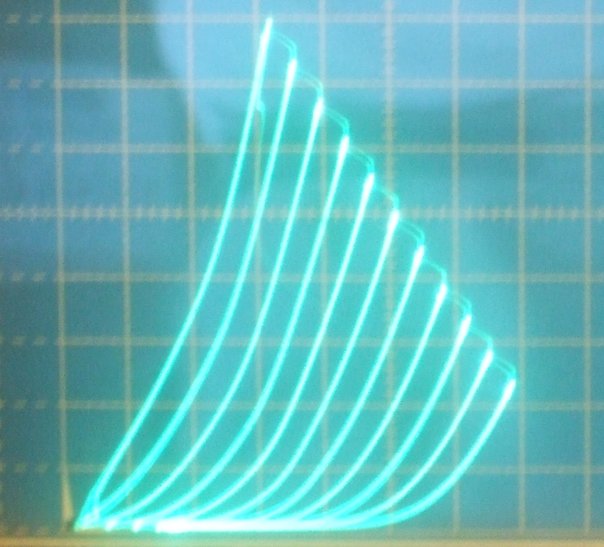

If you like triodes, you should be aware that "Schaded" feedback pentodes give better triode curves than the best triodes. And there is a long thread here on Pete Millett's DCPP amplifier which uses Schaded pentodes for output, and is easy to build.
George (Tubelab) has then taken it to multi-hundred Watt heights in the thread using cheap TV tubes.
http://www.diyaudio.com/forums/tubes-valves/151206-posted-new-p-p-power-amp-design.html
1) Here is a Schaded ($5) 6HJ5 curve set (50 mA/div, 50V/div), the amp can do 100 Watts output, leisurely, with a pair of these:
2) and a Schaded 21HB5A ($1 each, when on sale), good for 60 Watts out:
3) Schaded 12GE5/6JN6, 6JN6 is the original tube used with the DCPP, good for 20 Watts with original spec'd 8K primary, 50 Watts with a 4K primary
