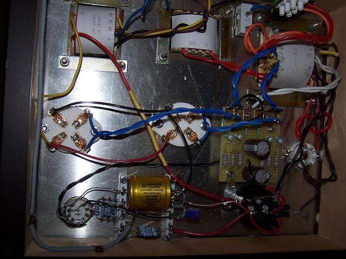

Here is two pictures of a too small a chassis with point to point...and another spaced out just fine (JE Labs).

Richard Ellis said:Here is two pictures of a too small a chassis with point to point...and another spaced out just fine (JE Labs)
I do have to ask, how many times did you burn yourself on that "too small of a chassis" amp.
