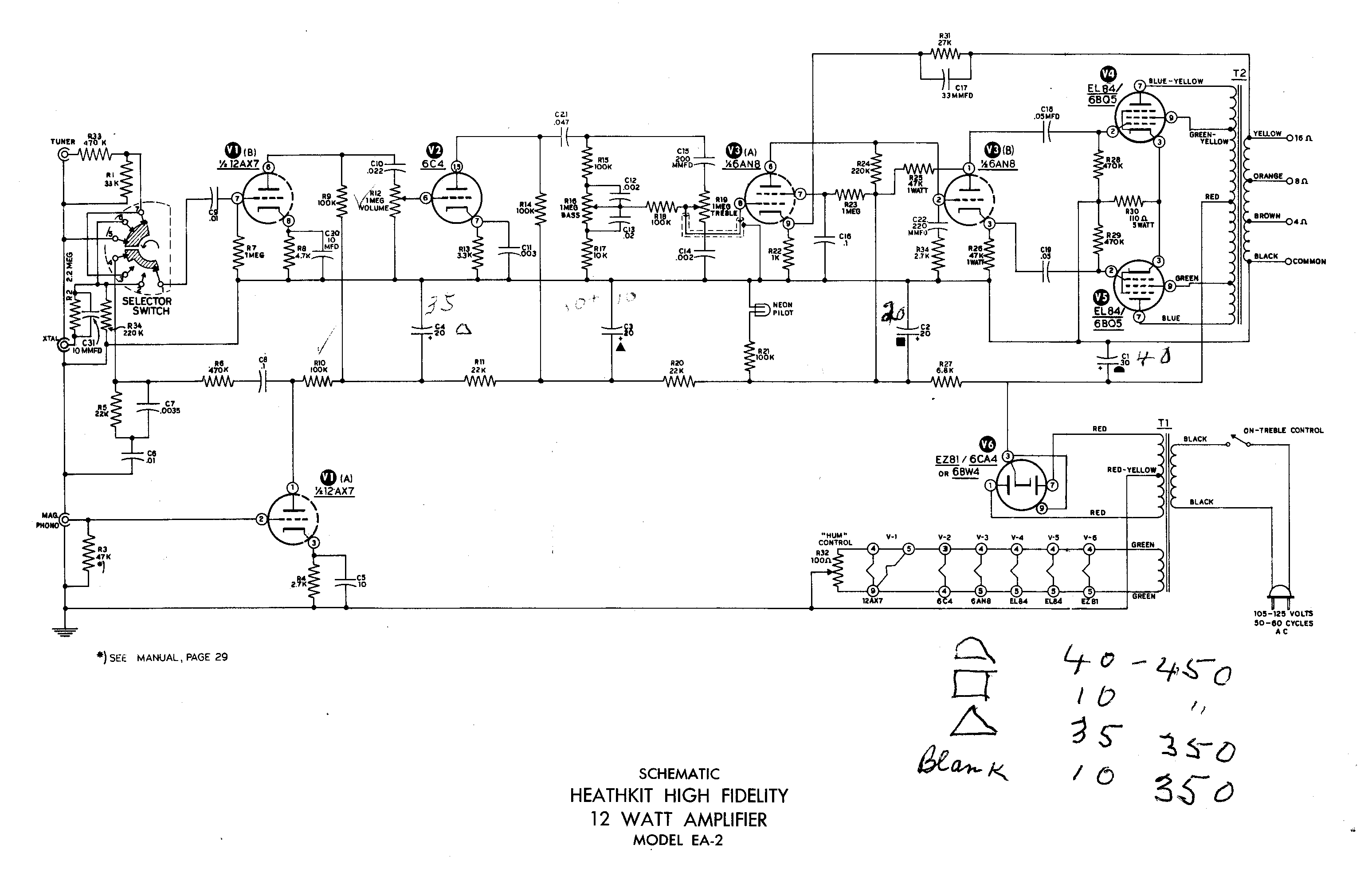

I don't have the heathkit schematic, but in most 6BQ5/EL84 circuits the plates (pin 7) each go to an output transformer winding, and the center tap of the primary of the output transformer goes to one of the high voltage pins of the big B+ capacitor. You may have to lift the wire off the capacitor to get a good resistance reading, as these old capacitors are often shorted, or measure partially shorted until "reformed". The first step of "reforming" an electrolytic capacitor is put the plus of the ohms scale on the pin, the minus on the chassis, and run it until the resistance is infinity.

Pins 9 of the El84/6BQ5 should go through a resistor (each tube) to a lower voltage tap on the B+ capacitor, going by the Hammond AO39 schematic anyway.

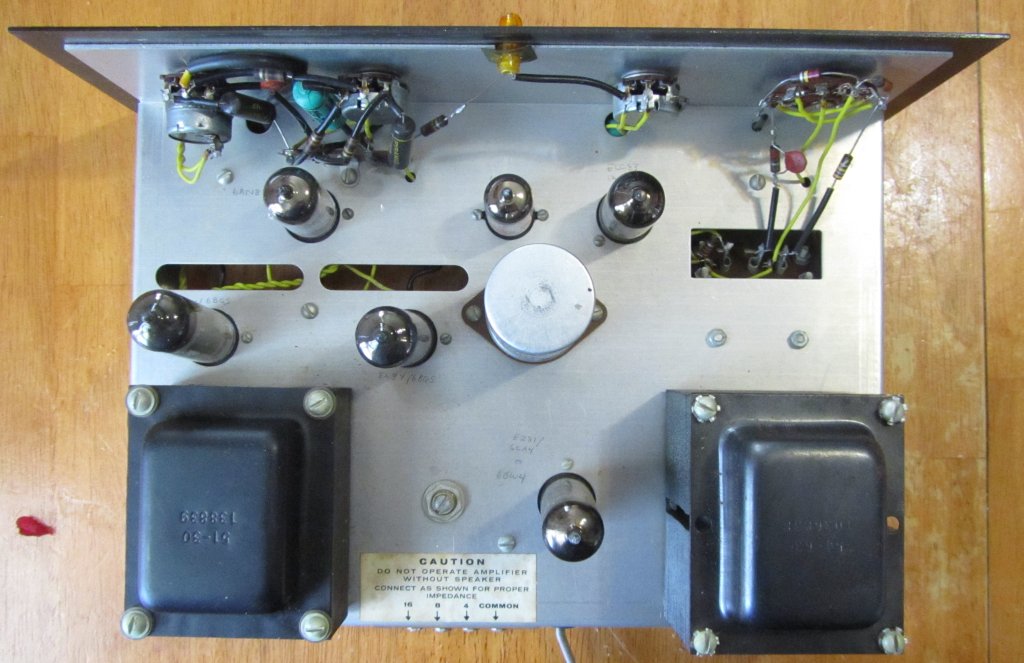

Welcome to the board with all of us crazies. What you have is a nice little audio amplifier that's good for about 10 to 12 watts and a good place to start learning. I will say that the output transformer is most likely OK. What you are measuring is DC resistance of the primary that gets physically larger as more wire is added. This means that it requires a longer length of wire to make the same number of turns as the "coil build" gets larger. This is normal.
Now it could be that the transformer is still defective, but you will not really know this until you get it going or make further tests. Having continuity between the five primary wires is good. There should be no measurable resistance between the primary and secondary and/or the steel core. That would mean a short.
Many on this forum will say the replace all the filter capacitors as a matter of course. (I have a slightly different opinion regarding this, but after fifty plus years of repairing electronics what the h*ll do I know.) This includes all electrolytic capacitors in general. In your amp these are C1-2 & 3 (the big metal can) C4, C32 (if there) & perhaps even C30. C16 & 19 should be checked for leakage once you get it up and running.
Is restoring this amp worth it? It's really up to you. If the amp is clean and you like it, then yea sure because it was free.

That the 6CA4/EZ81 rectifier is missing is not a surprise. The type is highly desirable. The schematic H/S uploaded is interesting, as it shows a 6BW4 being suitable. Unless you source a 2nd EA-2 specimen, investing the minimum amount of money in a learner project seems correct. A look at Jim McShane's site shows a new 6CA4/EZ81 costing $19.50 and a new 6BW4 costing $5.50. Buy a 6BW4! 😀
While it may be possible to reform the "ancient" electrolytic caps., it is a fact that modern 'lytics are superior. Also, 'lytics literally dry out over time. The "knee jerk" recommendation to replace all 'lytics is made (IMO) for good reason.

With vacuum rectifiers, there are published limits on the value of the 1st filter capacitor. Exceed the published limit and you risk arcing at turn on. Turn on arcing can destroy a vacuum rectifier.
The 6CA4/EZ81 data sheet is here and the 6BW4 data sheet is there.

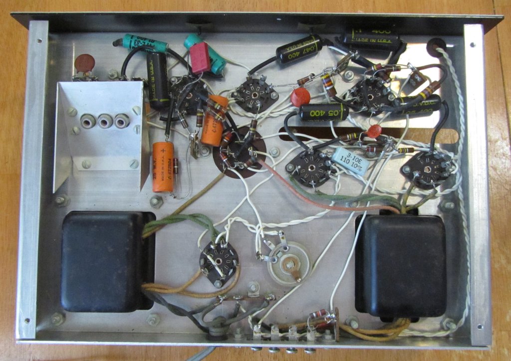

Yes you can.I do have a quick qustion. the 4 capacities listed on the can are 450 at 30mf, 400 at 20mf, 350 at 20 and 300 at 20. Can I replace all with 450 33mf?
In this case no, not at all. Decending voltage ratings in electrolytic capacitors back in the day was more of a size/cost issue. Today that's almost moot.Does the voltage rating change anything in the circuit?
The capacitor directly off the rectifier cathode is the critical one concerning value size. Leave this value close to what it is to prevent start up stress on the rectifier tube. Other values down the line, so to speak, can be doubled or more.Also i read that is is OK to go higher on the MFD rating as long as you don't exceed an 80% rise of the recommended value. Are these safe assumptions.
PIO (paper-in-oil) capacitors use some type of paper as the insulating dielectric that seperates the conductive material inside. Paper is a relatively poor dielectric and produces a capacitor that is "slower" then the more modern plastic dielectrics like polyester, polycarbonate, polypropylene & teflon. This means that they are less able to pass high frequencies easily. The result is a sound characteristic that is slightly different from the newer plastics. One could perhaps call it "tube sound" or a more mellow or vintage sound. It is also subjective to the individual.Also I see some talk abut the russian 40-y PIO caps for coupling. Any thoughts as to recap with sprague orange drops or the russian PIO
Replacing PIO's with plastics in the un-equalized audio stages usually does no harm, and can even be an improvement sonically. (again subjectively) But care must be exercised when replacing them in the equalized phone stage. For you that's C6, C7 & C8. Try to leave these alone if possible because changes here can upset the playback RIAA curve. The values chosen here could be based on the dielectrics used at the time of manufacture. This is a fine point in audio, and Heath may not have done their design work that carefully in this area. Still, try not to mess with them.

You can replace the EZ81 with a pair of 10 cent 1n4007 diodes. Solder them across the tube socket. This will raise the voltage up a little but this is mostly a good thing, especilly if you replace al the caps
Don't worry about the unbalanced resistance in the transformer. It is not broken it is just a low-cost transformer. That is the way it's made.

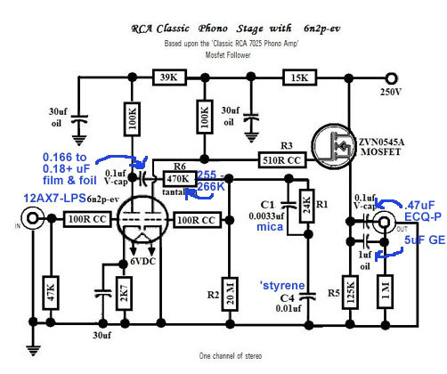

The RCA circuit Heath used in the phono section can be upgraded to be a superior performer. A schematic is attached. Heath used AC heating of the phono stage heaters. If you don't switch to DC heaters, the ONLY current production tube to use is the Sovtek 12AX7LPS. The 'LPS contains a hum bucking, spiral wound, heater and that feature is absolutely essential to having any chance of obtaining an acceptable hum level, when AC heating is used in a phono section.

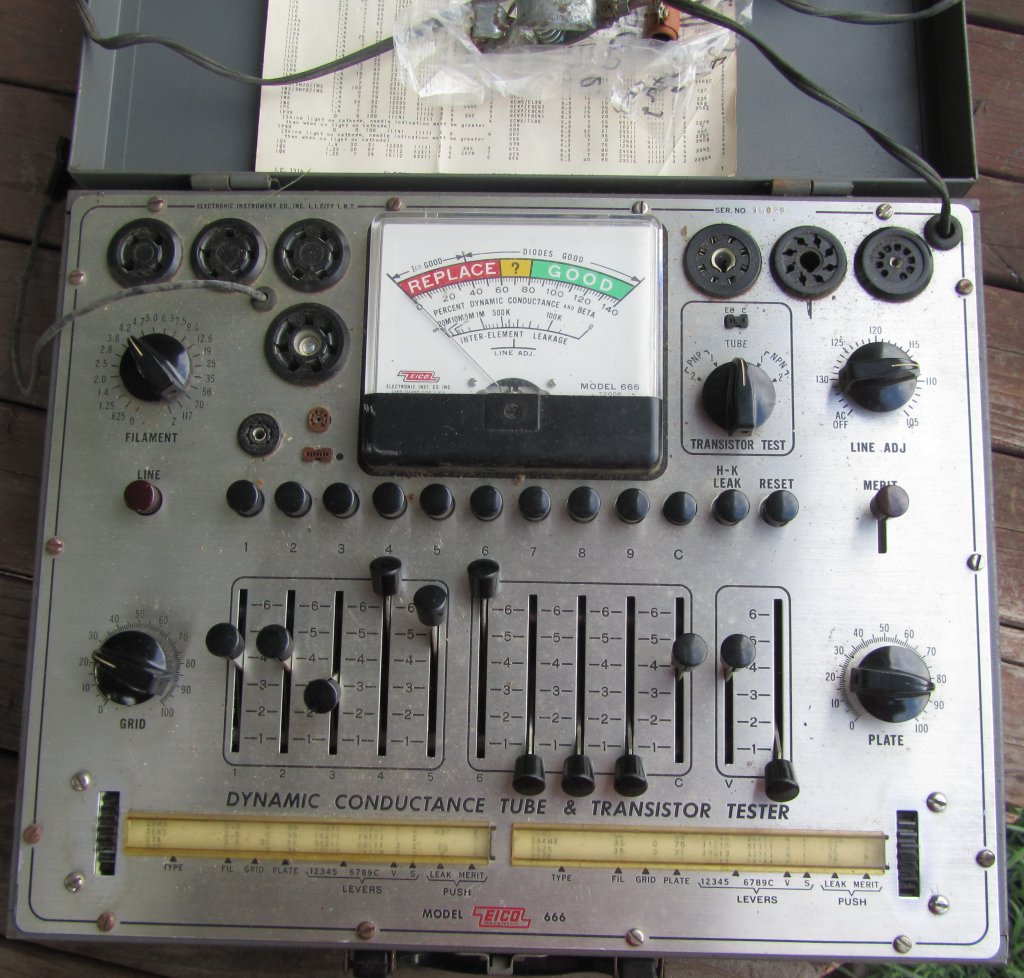

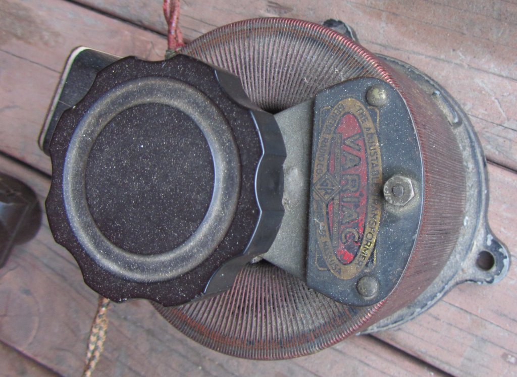

OK I am back from Vacation and looked at the Variac and tube tester I bought last weekend. Tube tester is EICO model 666. Variac is unknown. I have not put test equipment on the Variac yet but the wiring looks quite old, so I may replace with some newer cords. I think for right now I am going to use the 2 Heathkit Amps and run the 2 amps together for stereo. I am looking for improvements to the circuity for these amps as I rebuild them. Being that I am actually going to use them for my listening pleasure when finished I would prefer to make improvements now. I can always restore to original if I went to sell them but as these amps are my first project, I will probably never sell them. Once complete I will continue to listen to them as I build my next tube amp. Eli has made a few suggestions, one was to bypass the rectifier tube with some diodes, This seems easy and a no brainier as these are power supply issues and not actual signal circuitry. I also see Eli's suggestion to convert the heaters to DC to reduce the hum. I would assume a simple bridge with some caps to reduce ripple would work. I will do some research and post my thoughts later to see if I have learned anything. I also saw Eli's suggested circuit posted of a phone preamp but it has a MOSFET in it and I would like to stick to an all tube circuity for the signal path. I will do a little research on the tube tester as I have never used one and this one seems to have a bunch of levers and switches on it. I am attaching photos of the Variac and tube tester. Looking for any links to user manuals for the Eico 666 and any further suggestions for circuit improvements to the Amp without needing to change input or output transformers as I want to keep the iron I have for this first project
"glendalemanuals" on eBay will sell you a very high quality reprint of your "devil's" tube tester instruction manual which includes the latest set-up data. Well worth the $9.49 w/free shipping asking price.

Also, the FET in the phone stage posted by Eli is there to drive a cable when built as a stand alone stage. If you build it on the same chassis you could eliminate it by replacing R3 with a coupling capacitor to the selector switch pin 4.
True, but if the OP intends to record LPs, the FET is badly needed. The 'X7 triode can't drive anything resembling a serious load.
Tube testers are practically useless. You will never need to use it, not if you can test the tube in-circuit. The variac is us full for testing
One thing you might want to do is replace any electrolytic caps. with newer ones. They have a finite lifetime

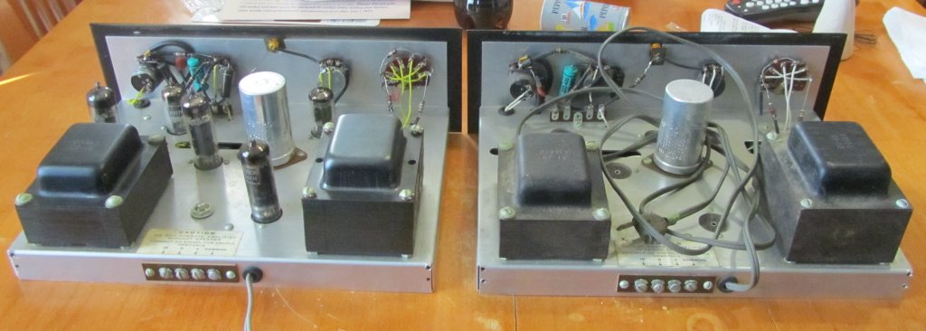

Just some photos of my stuff if anybody is interested. I believe they are both in pretty good condition. The unit I got from Ebay included original Box, Original instructions, original sales receipt 8 poster size diagrams of the wiring and parts and the unit looks mint as far as I can tell. Obviously I am no expert. Cost was 58.00 in 1959 and I paid 87.00 in 2013. The unit given to me for free has white wires for connections. the unit I got from Ebay has Yellow connecting wires. The 450v 33uf caps have arrived but they are still on my desk at work so that swap will have to wait for another day.
