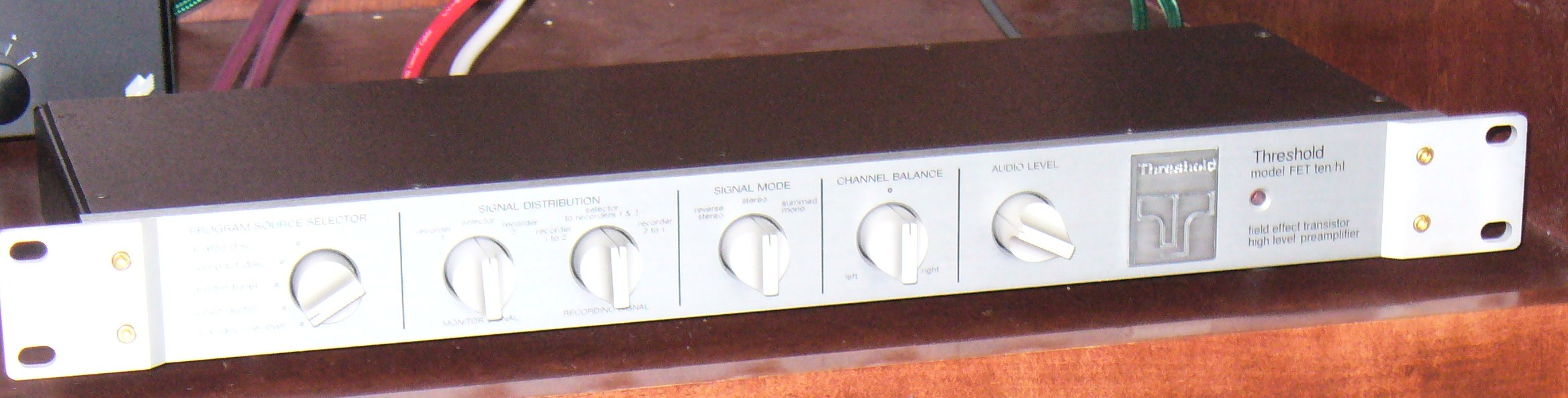

I just picked up a Threshold FET-10 HL for two channel playback, and all I can say is "WOW-What a preamp". This unit has provided a major upgrade for two channel audio playback.
I was using a Krell Showcase for all preamp playback, and while it is a fine preamp/processor, it's not in the same league as the FET-10 for two channel playback. The lite haze one usually hears with most audio playback setups is simplly not there with the FET-10.
For now, using the FET-10 with a newly refurbished Nakamichi PA-5, and the results are stunning with Legacy Signature III's. Can hardly wait to finish getting the two Nakamichi PA-7's refurbished.
Later this year, will be refurbishing the FET-10. The power supply would be a no brainer to refurbish, but how much and what should be refurbished on the main unit itself. Want to make sure to keep (hopefully improve) this level of sonic clairty.
Thanks in advance for any advice.

I just helped a friend refurb a FET-10. No electrolytic caps in the main unit to worry about. Some larger polyester caps could be upgraded, but I couldn't find any polypro caps that would fit, so I left them alone. I did replace the caps and diodes in the power supply. He is extremely happy and says it is a huge improvement over the Krell preamp he was using. He needs a phono stage, so I told him to wait for the Pearl 2 which I hope will start shipping soon..... (Hint, hint Wayne 😀)

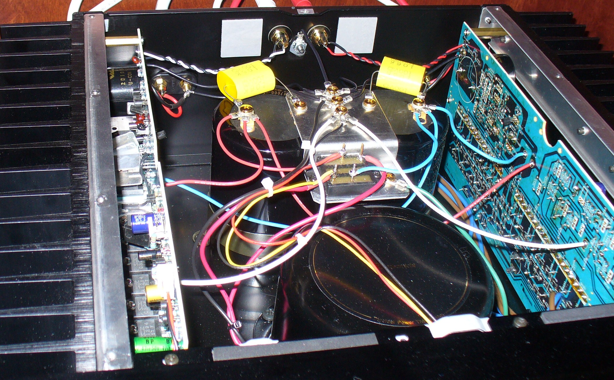

Here are a couple of pics: FET-10 and a recently refubished PA-5. The PA-5 had internal wiring replaced, most board caps replaced, and a new rectifier installed, along with the PS Cans bypassed. Made a huge improvement in sound.

What rectifier did you use?
I got the parts for this from my tech buddy, so not sure of the make/model, but believe it's a HEXFRED type. (You can see it pretty clearly in the pic). I do know that they go for 25.00 a pop, so it's going to cost me 100.00 to install them in the two PA-7's. They made the amp a fair bit quieter, as did replacing the internal wiring.
I'll ask him where he got them, and who made them. I'll post as soon as I find out.

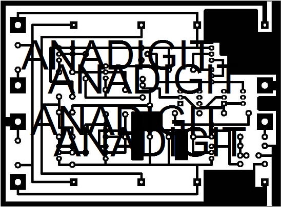

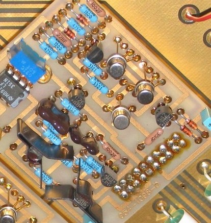

Found some pictures !
I found some pictures by Google !
There're many guy DIY this preamp so long time ago in Taiwan.
I hope we can modify ouput capacitor by use Panasonic Cap such as in Pass X0.2

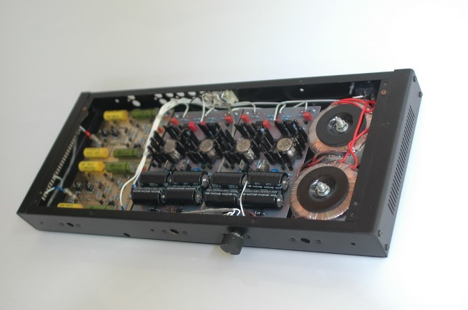

How is the FET9 vs the FET10 , well apart from having a phono stage ...
A phono and line stage in separate cases and an extra powersupply have better noise/separation numbers, theoretically.
The FET ten/hl, FET ten/pc, and FET nine were manufactured in the exact same period, no need to use other than the same line and phono circuits in the FET nine.
My favorite combo was the FET ten/e balanced inputs/outputs series, see attached pic for circuit details.
Biggy overhere : http://img380.imageshack.us/img380/4033/s6300714zx6.jpg
(the later Bladelius designed T2 preamp model is a totally different animal)
