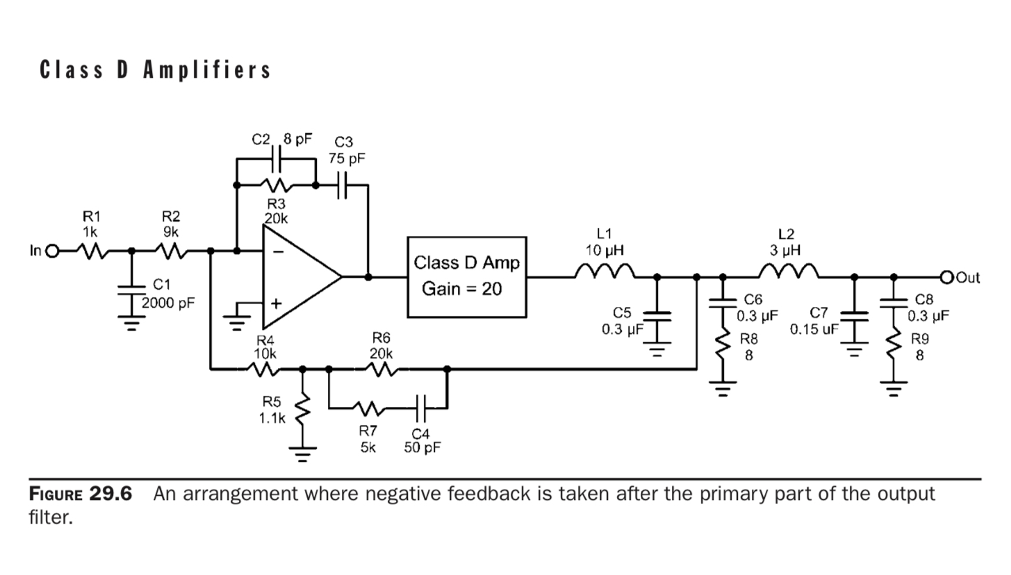

So, what is your definition of building a Class D amp? A Class D amp chip(set) and some PCB design software? Integrating ready made modules? Soldering components onto a pre-existing PCB design? Or do you want to build the class D circuit itself from functional components (triangle wave generator, comparator, bridge...)

I saw my friend built a Class-D amplifier with an IRS2092 IC. He calculated the lowpass filter, designed the toroidal transformer and PCB himself. Thus, I would call I’d like to build a Class-D amp chip(set), design the lowpass filter and power supply myself, and let my friend help with a PCB design software.
I found a peripheral circuit from a textbook. I have a thought that would it be possible if I were to build an amp using an IRS2092 as my friend used and equip it with the peripheral circuit as shown on attached? Is the figure be the universal peripheral circuit?
