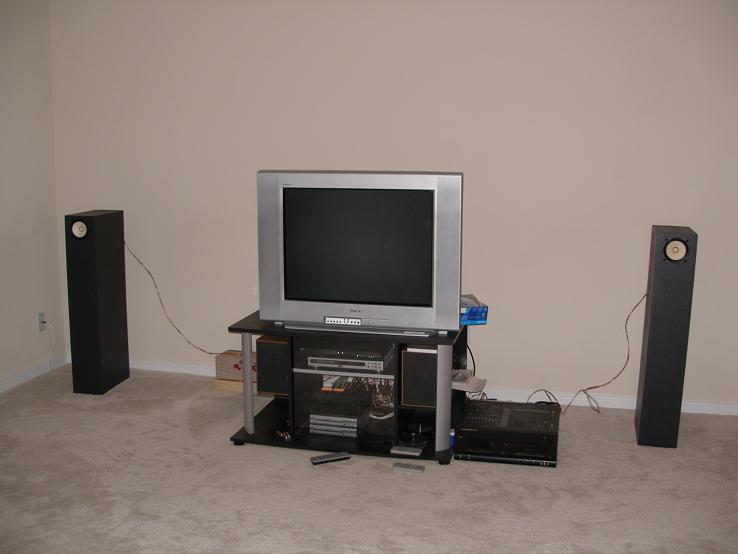

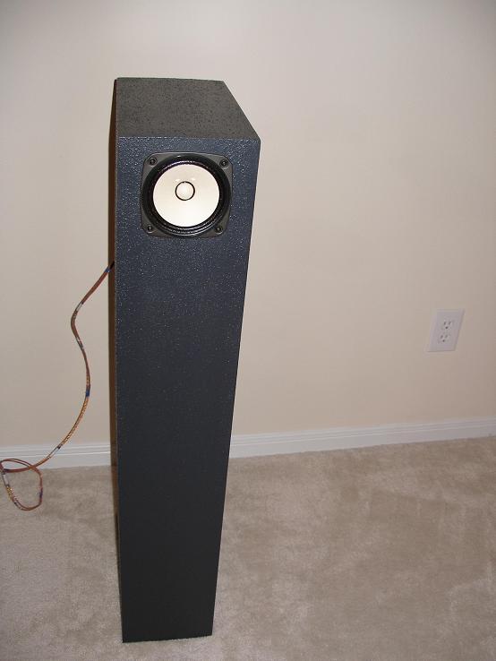

I had Scott at steinaudio.com built me a set of buschhorn II and I just mounted Fostex 126 on them yesterday. The sound is really great and bass is quite good for such tiny drivers. Anyhow, I am very happy with these speakers. Just want to share my joy. Thanks.

Those horns look very nice. Good work. How do they sound?
When you say Buschhorn II, do you mean the Buschhorn Mk2 ?
The FE126E is getting some very good praise, a lot of it coming from www.thehornshoppe.com They like the FE126E much better than the FE108ES! If I am not mistaken, thehornshoppe design is very similar to that of the Buschhorn Mk2.
What I don't understand is how one enclosure can be good for different drivers?
FE103 Fs=79.5Hz, Qms=2.87, Qes=0.40, Qts=0.36, BL=4.42, Vas=6.9L
FE108ES Fs=77 Hz, Qms=7.79, Qes=0.32, Qts=0.3, BL=5.2, Vas=5.7L
FE126E Fs=70Hz, Qms=2.96, Qes=0.27, Qts=0.25, BL=5.92, Vas=9.95L
I would have guessed that a larger horn would be required for the FE126E?

I did not do any modding to the design except make the hole larger to fit the 126 drivers. Whether or not the specs of the 126 fit well with the Busch Horns MKii design or not, the speakers impress the heck out of me and all the people who have heard them., and yes everyone who have heard them - like them very much.
