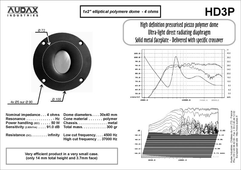

Hello!
Well, finally I managed to sort some things out and now
I am on my way to start my so long awaited speaker project.
So there it is:
- Audax HD-3P as a tweeter (no second thoughts about that one)
- Scan-Speak 12M midrange. Well, I am not absoloutely sure
about this driver, neverheless, I cannot anything more suitable
for this application. When U use HD-3P, there is a need for
a midrange that would cope up with frequencies up to 5 KHz
without any problem. I also thought about Audax's own HM100Z0, but realised that SS 12M would be better, more
wideband and more linear. Any suggestions here?

1st question. How efficient is the Audax tweeter? (audax site is unreachable for me at the moment to check)
midrange. I'd consider the Jordan JX92 or a Fostex FE108 or 168.

Hello Dave,
Well, are these midranges you mentioned really worth considering? Do they seem better to you than SS 12M ?
The problem with Jordan and Fostex is the fact that
there really hard to get here in Poland, and I don't want
to play with customs once again.
To be honest, I have no idea what to do with the baffle step loss,
well maybe cross at 400-500 Hz?
I'll tru to post hd3p data.
Greetz
Adam

Spherion said:Well, are these midranges you mentioned really worth considering? Do they seem better to you than SS 12M ?
They are actually all full ranges which makes them ideal for mid use with 1st order XOs.
Fostex i can understand -- the 108 has the same sensitivity spec as the Audax, the 168 would be too sensistive. The Jordans are made by Vifa so i thot you might be able to get them -- they are about 89 dB. I haven't heard a lot of SS, but what i have seemed to be a little lifeless.
The Vifa P13s are also worth considering. These have a nice smooth roll-off on the top, and with a budget that could get you the SS you should easily be able to get twice as many of these and solve your baffle step with a bi-pole (or bi-polish 1.5 way mids)
