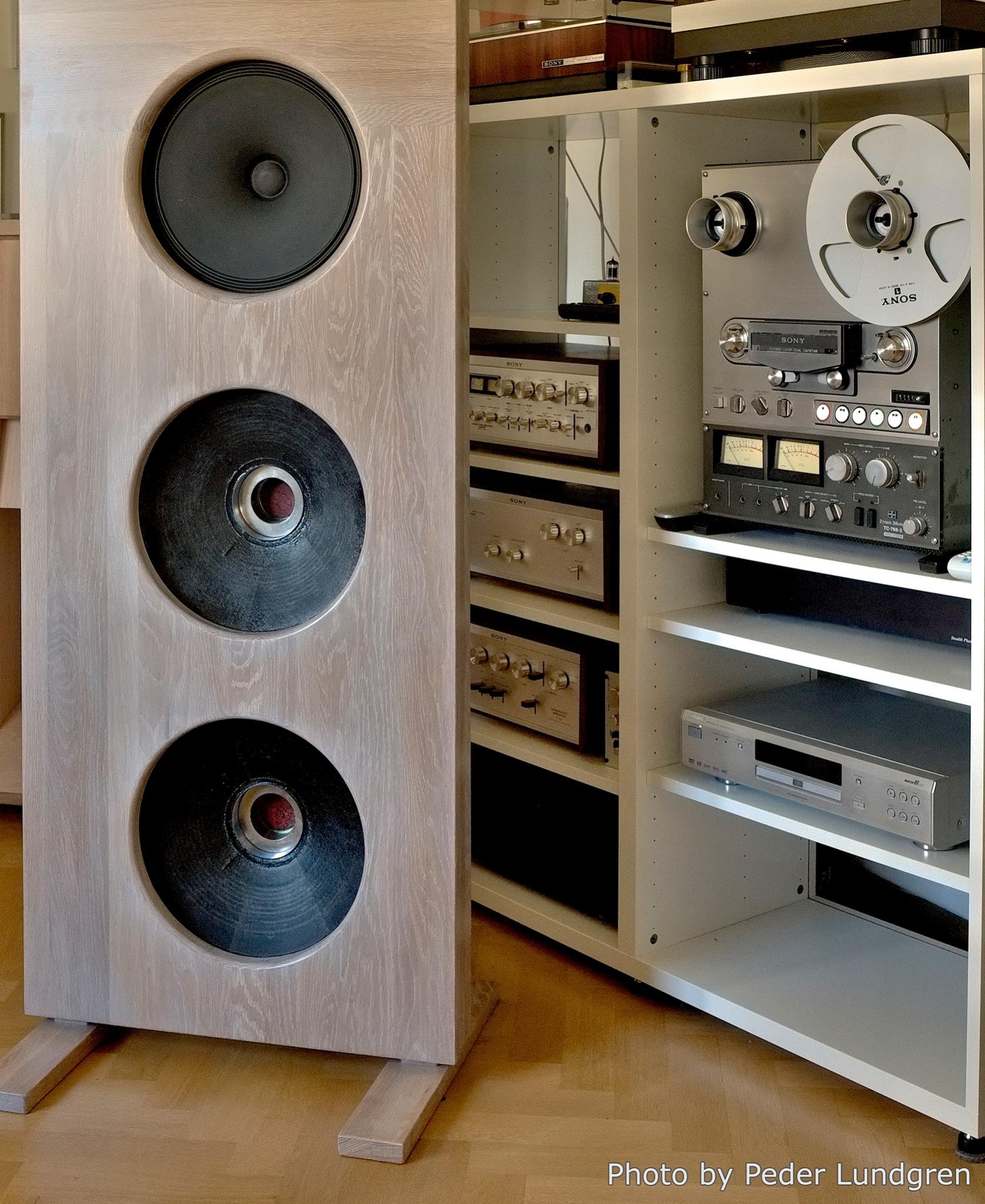

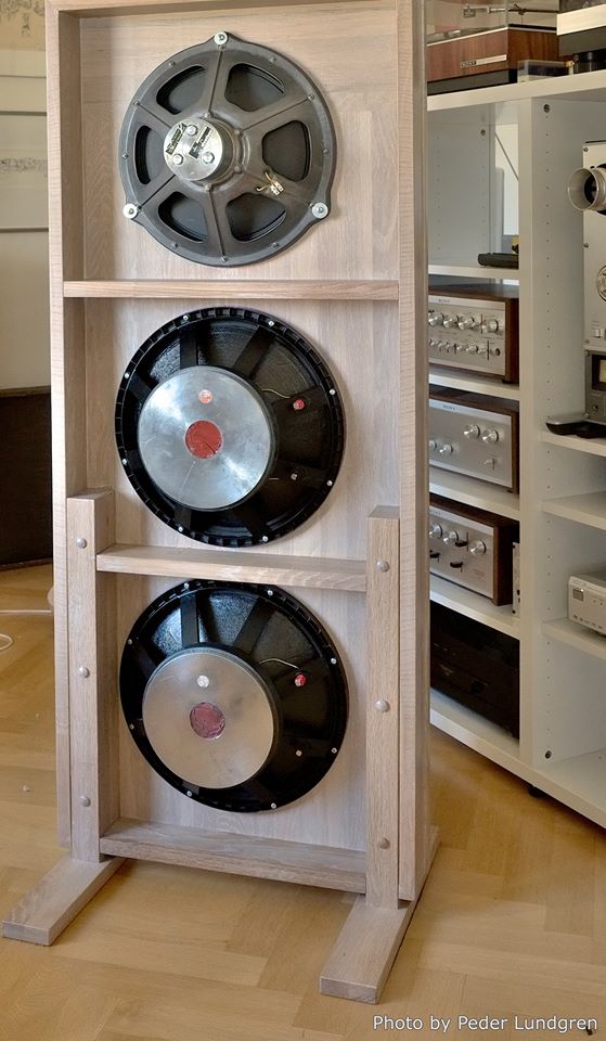

Hello, I like to find a new shape, maybe an oval, for my new set-up. For bass there will be an old 15" Audax PR38 S-100 in 8 ohm. On top of that a 14" Klangfilm KL L-405 full range with a little help of another Klangfilm 4" tweeter.
The woofer will be driven by a SonyTA-N55ES and the full range and tweeter by my trusty Sony TA-1120. The woofer will sing at 100Hz and below.
I have seen some ideas in an oval shape and I like the look. I do have som solid oak in 1" thickness that could work. Do you have any suggestions on my plans.

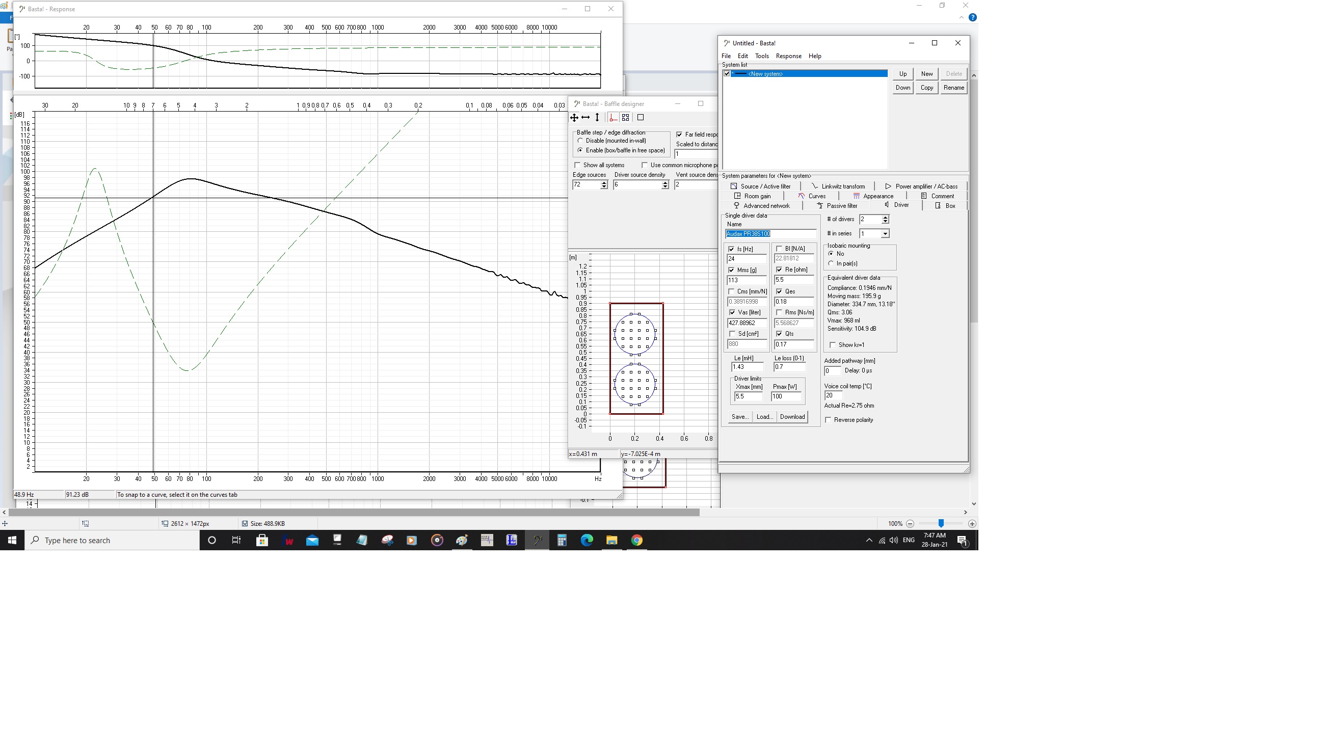

I'm afraid that Audax woofer is not very suitable for an OB, its Qts is much too low for that and it will struggle to produce any decent bass.
Maybe enter its parameters in Basta!, select baffle, enable room gain, then go to Baffle designer, enable box/baffle in free space, and see what the output will look like.
I think you'll be quite disappointed by the result.
My estimate is, with a LP at 100Hz, it will reach about 55 - 60 Hz with a great loss of efficiency,
OTH it might be a good choice for a vented enclosure, but I'm not an expert on vented speakers, so can not say more about that.
Good luck.

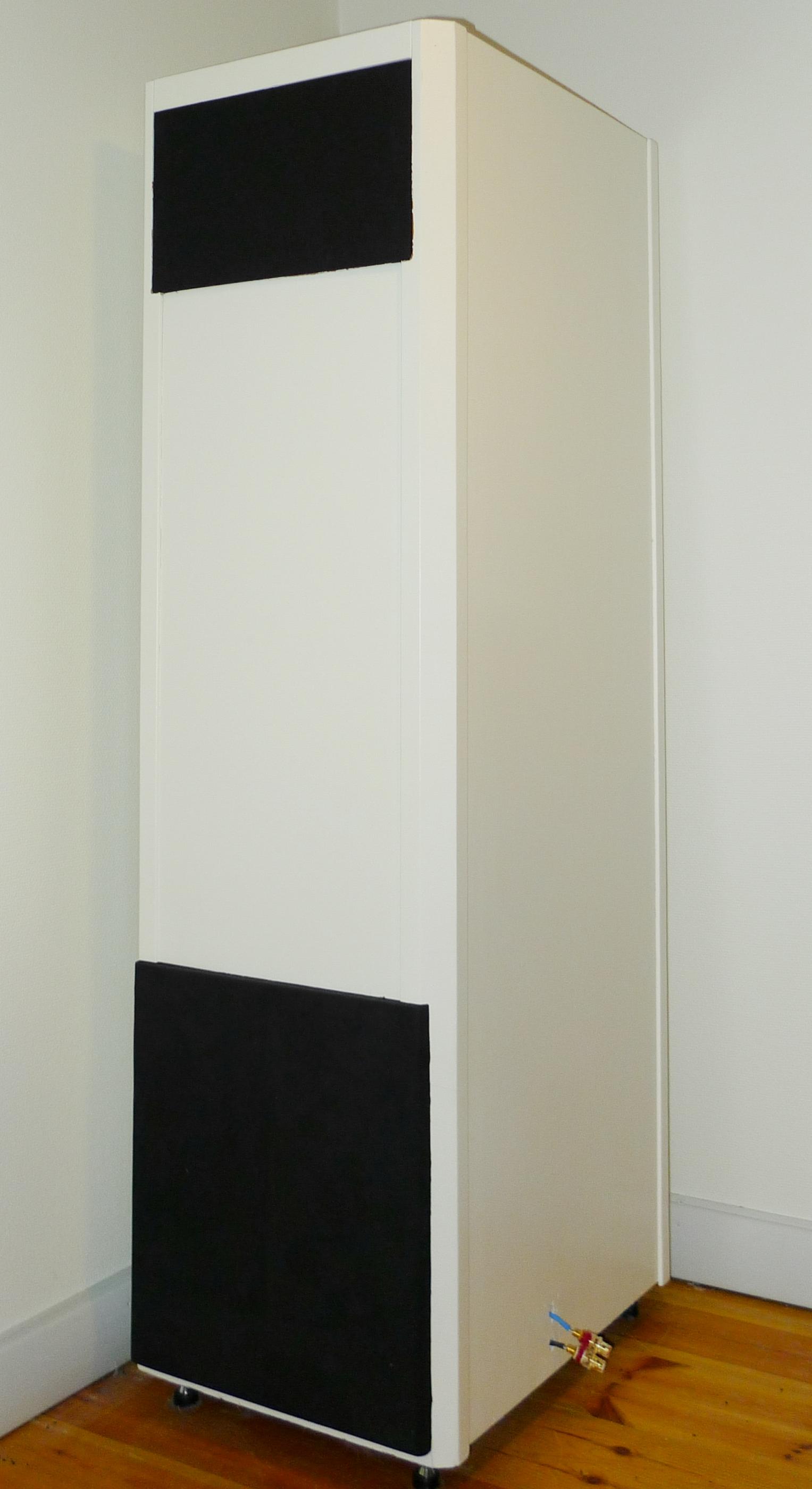

Nelson Pass, I got plenty of deep and tight bass from these old Audax. A couple of years ago I used them in som big horns but those took up way to much space in the room so that is wye I try to find a better and more discrete set-up. By the way these Audax are reinforced with kevlar to make them extra stiff and the cone movement is very little but powerful.
