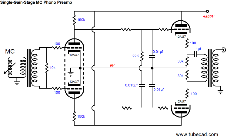

This is Broskies simple balanced phono preamp:

My simplistic mind brought to me that it would be just perfect, to use a 1:10 step up as Input transformer 12ax7 as gain tubes, ecc81 as cathode follower and as an output transformer a transformer voltage control, (by sowter with +6 and +12db tab) wich will give up to 1.225V wich is just what my power amp needs.
What do you think?

Mc with a 1:10 input trans and only one gain stage?
Think you need a step up as output transformer,
Reinhard
Reinhard
Where is the grid leak resistor in the first stage?
Grids are floating, see original article.

With an cartridge of 0,5mV
1:10 transformer -> 5mV
Ecc83 gain about 80 -> 400m
Cathode follower gain 0.9 -> 360mV
TVC with gain Tab +12db -> 1,4V
Not too bad is it?
Is the transformer not also getting 2x 360mV?
And where are the -20 dB for the RIAA - network?
Reinhard
There was my mistake!!!!
What would you suggest?
2.nd amplification stage, what else.
Reinhard
Lundahls LL1943 is a MC input with 1:16 or 1:32 wouldn’t that cover for the loss of the RIAA?
A second gain stage would mean many many more parts! :/
With 1:32 you get 10 dB more, not enough.
Redesign the cathode follers to a second diff-amp.
Reinhard

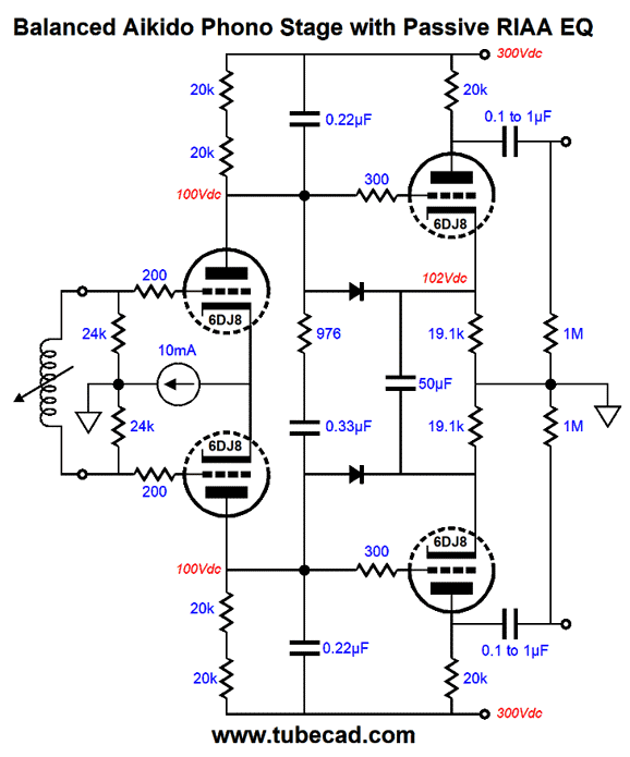

Or this more recent one maybe?
Return of the Triadtron & Balanced Phono Scroll down through the blog until you see the attached circuit. Would need an SUT. Might even be able to run balance right from the cart.
