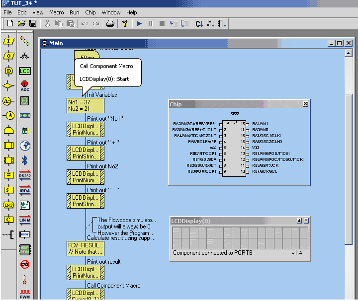

New programming toy for "C", PICs and AVR's
Janneman had mentioned "Flowcode" from Matrix Multimedia http://www.matrixmultimedia.com./
a couple days ago on the Anatech thread dealing with the GPIB/HPIB -- there's a student/home license version for 39 pounds (there are distributors all over the world, I got mine from Micro Controller Pros in California http://www.microcontrollershop.com/ )
You just drag icons from the left onto your screen, fill in the values, compile to "C", then compile the hex code.
I purchased the software and a USB programmer to (to replace my PicStart Plus which has gone missing.)
Here's a screen shot from one of the tutorials:

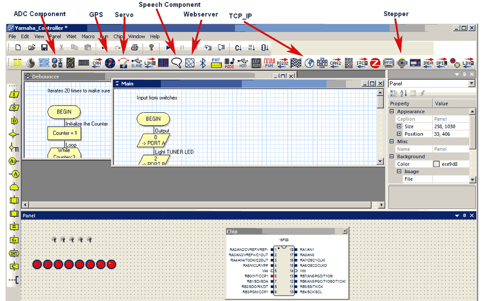

Well, my Yamaha A-10 "Project" Integrated Amp ran into a roadblock -- the input switching consisted of dreadful CMOS Mux's -- and the push-button controls were driven by a set-reset counter. I wanted to use Silonex LDR's for the input switching but no matter how I configured them there wasn't enough juice to completely activate the LDR without causing problems with the SR FF.
I didn't want to rip up the entire input board --(it is inevitable, however.) I wrote this little routine in a couple of minutes with Flowcode -- note that you are only limited to 16 macro's in the free-ware version -- but the hobbyist version includes a USB Programmer and a 16F88. You can get around the macro-limit by writing your own "C" routines to substitute for macro's.
http://www.tech-diy.com/Receivers/Yamaha10/Flowcode.gif
