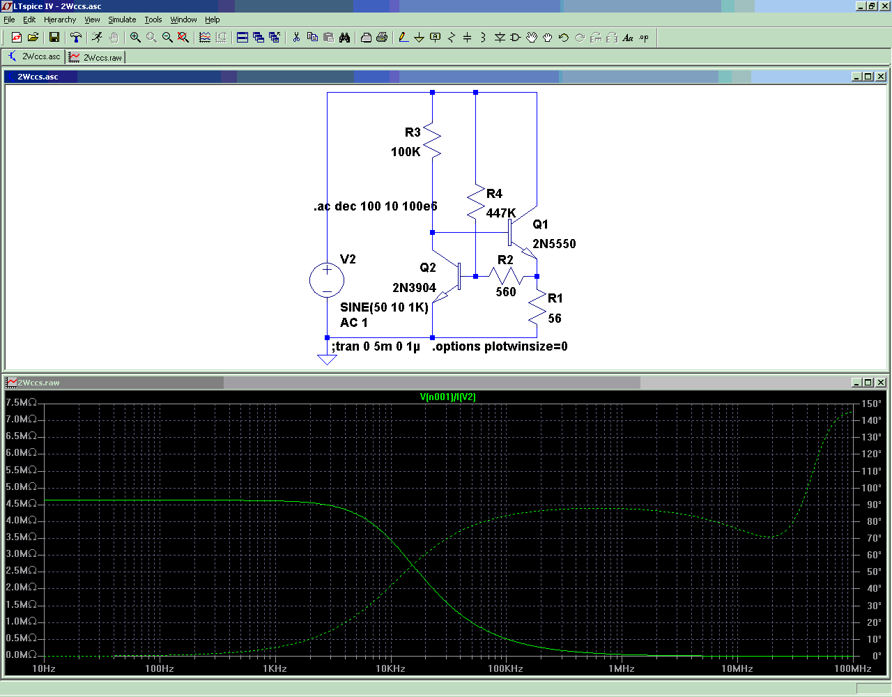

I don't know the specifics of your circuits, but when the 2W CCS is not overcompensated, it is pretty stable, predictable and well behaved on its own.
If you look at the impedance curve, it's smooth and regular, no peaks, jumps, dips or other "accidents"
Impedance starts dropping off at 10 kHz ?
That's not very impressive for a CCS, especially when modeling often looks better than the real thing.
No, it isn't. It is caused by the collector capacitance of Q1 and the high output resistance: 5pF x 4.5Meg.
Some improvement is possible by cascoding.
Many other CCS configurations also have several pF output capacitance, including the PNP ones.

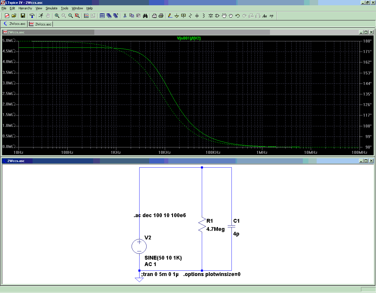

This illustrates what I said above.
Obviously, better results could be achieved by means of active cancellation techniques, but many plain vanilla CCS's will have an output capacitance larger than 4pF.
The apparently poor frequency performance is caused by the good performance of the compensation.
If you examine the absolute value of the impedance at a given frequency rather than the variation wrt frequency, you come to the conclusion that the circuit is not that bad after all.

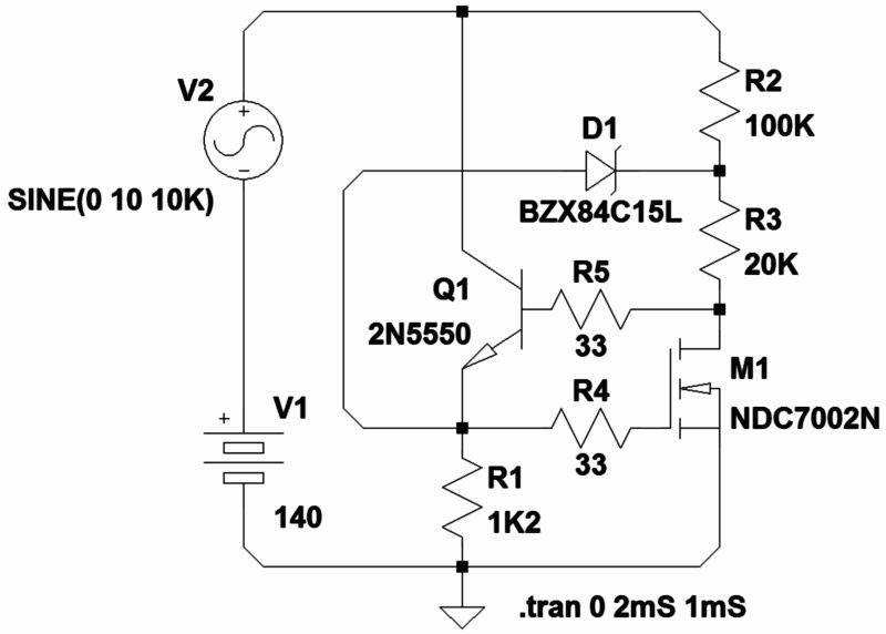

That's not too bad. And yeah, it's bootstrapped, so you can put it wherever you want, plate or cathode.
Some downsides: the 100k bias resistor must supply a minimum base current, which means saturation will necessarily be rather high. In this example, I found around 5V (more on this later). That's fine for a plate load. For a cathode load, it doesn't matter, because you wouldn't use this circuit: you'd use a circuit with more range.
Negative resistance is an obvious problem around reactances. Since it can be adjusted, this isn't necessarily a big problem, but it's something to be aware of.
Your analysis of ~4.5Mohm ignores some fundamental features of this circuit. For instance, it can do quite a bit better than this! The proof is in your negative resistance oscillator: if impedance can go negative, it must go to infinity somewhere inbetween. Unfortunately, such a point is likely only a balance point, with arbitrarily large resistance (positive/negative) on either side. The trick is to adjust that point so the curvature is as gradual as possible.

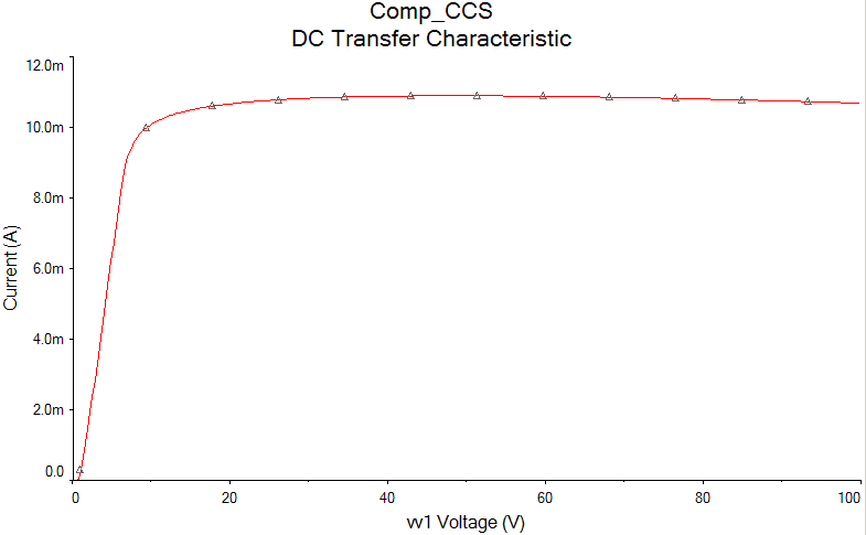

I have produced some DC sweeps which may be of interest. First: plain DC sweep, from 0-100V. This is using an identical circuit as shown above, using both 2N3904s for convienience (the model does not specify breakdown voltage, so the sweep can go beyond 60V quite easily). I cannot guarantee that my 2N3904 models are identical to yours.
The second graph shows a zoom on the saturation region, with two points highlighted. The red cursor is approximately the infinite impedance point, showing a peak of 10.8941mA. The current drops off on both sides away from this point. The blue cursor indicates a point towards the edge of the sweep, at 90V, indicating a change of -0.1479mA, or an average incremental resistance (ugh, what an abomination of terminology) of -281kohms. (The actual incremental resistance at the blue cursor will be smaller than this.) That's not very good, and a cascode will outperform it easily.

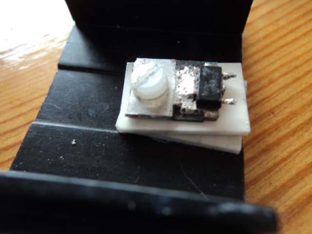

The SOT223 types need heatsinking to avoid runaway. At 20°C/W chip die to collector thermal resistance, I used a blown TO220 package with a double aluma-ceramic insulator for the lowest insulator thermal resistance and minimal "C". see pic.
richy
