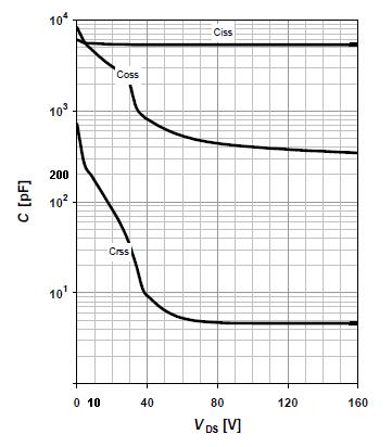

Looks nice, but the miller capacitance of just 5pF must be a typo
..looks like they specifiy this kind of low miller C throughout the series (just look at IPP200N25N3, IPP320N20N3 and so on...).

Capacitances always need be referenced to some voltage:
5 pF @ 60V, but
200 pF @ 10V
and then some...
That's the price for high transconductance/low Ron and high current capability.
Most ringing problems in class D output stages arise from series resonance between the output capacitance of the MOSFET that is turned off and with high Vds, and all package and layout inductances (the MOSFET that is on and supply decoupling capacitors are closing the circuit). Snubbers are often required to damp this resonance to a reasonable degree.
200pF at 10V is nothing to worry about, and 5pF at 150V with a good layout will resonate at such a high frequency that snubbers won't have anything to damp (above 100Mhz non-RF-specific circuits tend to be self damped due to high losses). Snubbers are probably still required, but just to control dV/dt at the switching node in the voltage transition that happens after body diode recovery.
