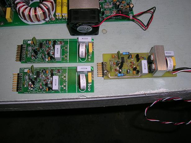

Sorry guy, I did the same 3 months ago for a multichannel amplifier...Mine is rated at 200W into 8 ohms and 350W at 4 ohms. Variable dead time, so that's mean low dead time at lo power and higher at higher power...Only thing, I dont have micro-processor to watch reliability...But never blow any module as for now. I will sell lot of these module soon, I have over stock...The pic is prototype with fews production module, unfortunately I did not have complete module on hand, all sold!
Fredos
www.d-amp.com

IVX: You are right, this prototype is hand soldered. When i get the production modules in, i will of course post some new pictures. 🙂 Sorry about that.

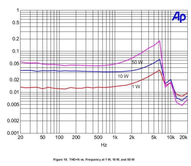

The measurements look good so far. Congrats !
Someone mentioned that he'd be interested in THD measurements at full power (or almost full power). IMO these are not THAT important. For a HiFi amp THD at 1 Watt and 0.1 Watt would be far more interesting.
Regards
Charles
