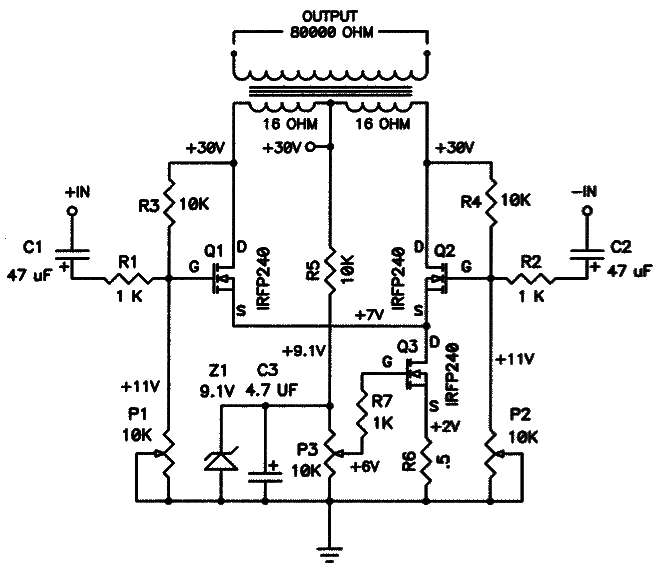

Magura said:Zen V7
I finally read that paper... looking at the very last schematic makes me think a pair of tubes might replace the mosfets... a single stage forced symmetry (Allen Wright) crossed with Super symmetry (Nelson Pass)
EC8010... could it be made to work?
I've attached the map i refer to from Nelson Pass' Zen V7 article on the PassDIY site.
dave
Hmm, I guess Dave got hold of the wrong map??
To me it seems like the the ZV7 for esl?? 😉
Magura🙂
Magura🙂
Magura said:I guess Dave got hold of the wrong map??
No that is the one i meant... the ESL OPT could easily be replaced by a PP OPT or perhaps even a pr of SE OPTs (which are designed to handle the DC)... except for the super symmetry i've already skirted around the SE idea...
http://www.diyaudio.com/forums/showthread.php?postid=55694#post55694
Take the SS feedback out, retool the CCS as required, adjust the windings on the OPT, replace the 2 MOSFETS with power tubes and you've got a single stage PP amp. I've not yet got enuff handle on feedback to get my head around that...
dave
