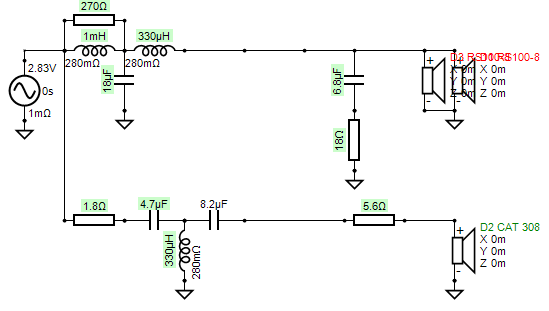

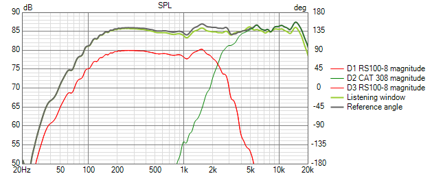

Hello everyone! Brand new to the scene and excited to dive in. I've spent the last 2 months reading and re-reading Intro to Basic Electronics, Speaker Building 201 & The LDC 8th edition volumes I & II. I have also been learning Vituix CAD and playing with Xmachina. My next steps will be getting testing equipment. Any recommendations on a cost effective setup would be great! I have a good selection of old speakers from brands of varying quality that I plan on disassembling to use the drivers for experimentation. I have been playing with the half space responses of 2 MTM configurations. Both use the Dayton RS100-8 mid bass and I have experimented with the Morel CAT 308 dome and Aurum Cantus G2Si ribbon tweeters. After completing a few test builds with the drivers I currently have, these will most likely be my first real shot at a quality loudspeakers. I am currently using Cambridge Soundworks and Triad MTM speakers scattered around my house that I can use for reference. I understand that the half space responses are not indicative of what I will be working with in reality. I am going play with the simulated diffraction in Vituix now as practice but I have some concerns with my current designs that I could use some direction on. For both alignments I have good frequency response and the phase and group delay seem appropriate. My concern lies with the impedance. The first alignment using the G2Si tweeter shown below dips to 2.8 Ohm and hangs at 3 Ohm from 200-1200 Hz low point. The second alignment using Cat 308 in my next post runs 3 Ohm from basically 200-2000 Hz. The second alignment is more consistent and has far less circuitry but I would like to try and build both. In both configurations the problem seems to stem from the large parallel capacitor in the low pass section. However adjusting this drastically effects FR. I welcome any feedback on these designs! My questions are as follows.

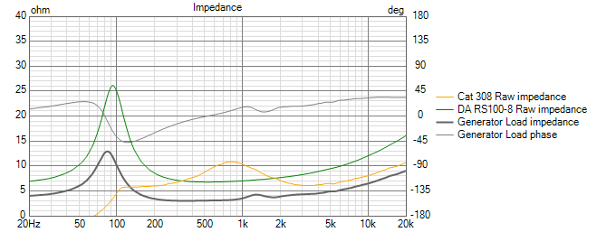

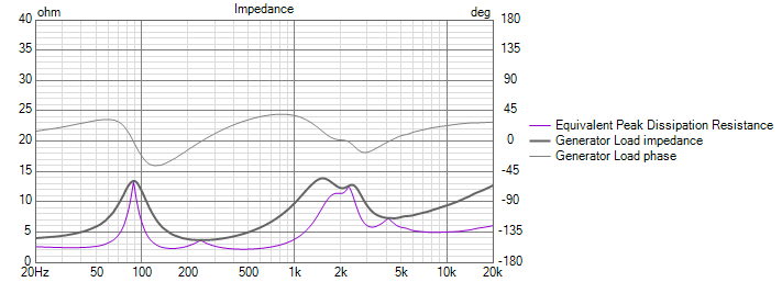

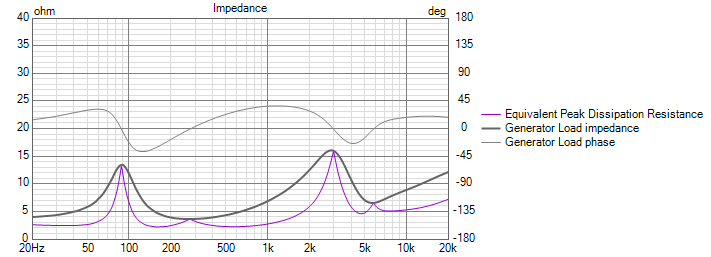

Are these impedances going to cause problems for a lower end amplifier?
Is there an easy work around to raise the total impedance that wont affect efficiency to horribly?

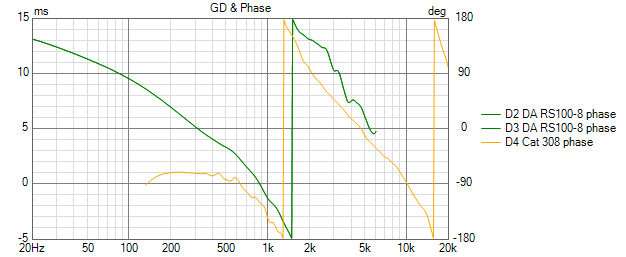

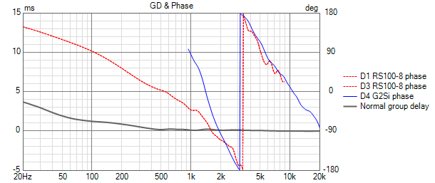

How does the load phase affect the impedance? The peaks in phase correlate to higher impedance levels, when the impedance is at its lowest the phase is close to 0. This means it is mostly resistive correct? Does this present less of an issue for the amp?

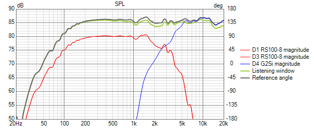

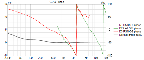

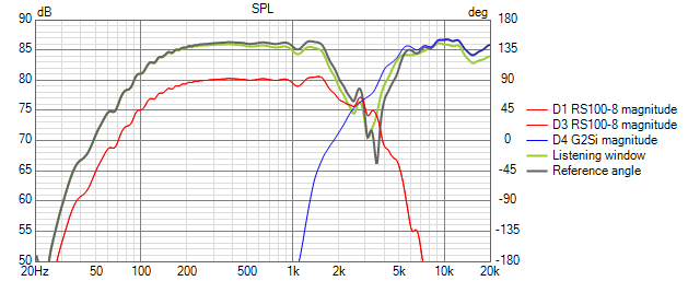

How does the acoustic phase look? Configuration 1 is 90 degrees out of phase in the low pass stop band. Is this ok?

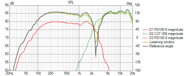

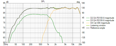

If I invert the tweeter I get a 6 dB drop at the crossover. Is that steep enough?

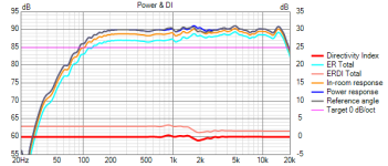

Does any of this matter as it uses half space responses not real world measurements?
Thank you all in advance! So glad there is a place where I can have access to the wealth of knowledge you all have to offer. I attached the Vituix project file as well as pictures of all the relevant graphs. Alignment 1 is crossover variant 1. and 2 is 2
Possibly. If you are talking about something like a home theater receiver, many of those aren't rated below 6 ohms. It's going to depend on the amplifier though. Some cheaper ones are fine at lower impedances.
If you just plot the impedance of your two midbasses on their own with no crossover, you'll see the base case for the impedance you are dealing with. Anything you do to raise that in their intended passband is going to cause a loss of sensitivity in some way. If you include a baffle step correction of some kind, it will likely improve the minimum in the lower midrange and up.
In Case 1, the minimum at around 1200 Hz might improve a bit if you get closer to a target roll-off for the tweeter, but I'm speculating. Looking at the individual legs of the crossover to see where impedance is for each will help show some of this.
Correct.
Large capacitive phase angles are typically hardest on a transistor amplifier, and they are more problematic at high frequencies. This is highly amplifier specific though. Some are much better at handling difficult loads than others.
EPDR (equivalent peak dissipation resistance) is the newer calculation used to combine the effects of phase angle and basic impedance into an equivalent resistive value. You may want to look at that, since I think it's included in Vituix.
Pretty good overview here about speaker loads

G2Si tweeter
The recommended minimum cross point on it is 2.5 kHz. Your acoustic result seems quite a bit lower than that since the initial roll-off is gradual, then it steepens. You may have issues on that front. Most true ribbons don't like being driven with lower frequencies than they are designed for.

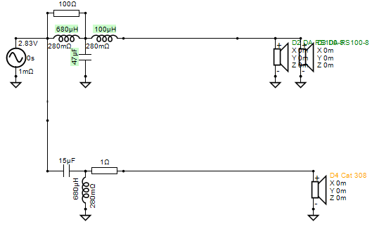

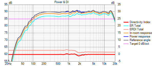

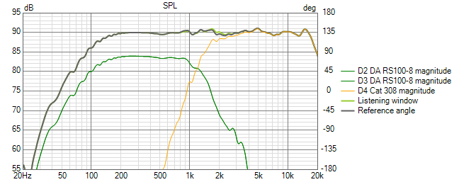

I used the diffraction tool to get me realistic responses. While the response is not as smooth it is still plus or minus 2 db. I am getting better impedance response with a minimum at 4 Ohm. The EPDR shown in pink however drops down to 2 Ohm. I am reading up on this to better understand its affects now. I was able to get the phase alignment very close with the biggest variances happening deep in the stop bands. I sacrificed a bit of linearity to get the Phase to where it is but nothing major. I have posted the 2 variations below.
What are peoples opinions of witch takes more importance, mostly flat response or properly aligned phase?

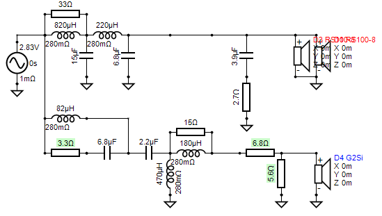

Var3 has a pretty complicated XO design, besides cost how bad is it to have 5 inductors? All but 4 a fairly small.
I will take any feedback good or bad it will only help me learn!

After reading the article by Keith Howard it seems like the standard measure of impedance is basically irrelevant. All of the speakers he tested the EPDR came in significantly lower. It seems to me that designing for a flat as possible load phase is more is more effective at limiting the strain on an amplifier then a higher impedance minimum?
Is it also true the amplifiers must be designed to handle dips well below there rated limit?
My current amplifier is a cheapo pyleusa 8ch 4-16 Ohm. It gets the job done but I will definitely be upgrading as I build more and more speakers. It is powering 7 MTMs spread through out the house. It did not like powering my 4 Ohm triad speakers in a location that required a 50ft run of cable.
How how the extra cable play into the EPDR? I would think it would raise the impedance from all the added resistance.
That's highly specific to the individual, but I think the majority would say very tight phase alignment is less important than frequency response.
That really comes down to how they are used, where they are in the circuit, and whether a simpler approach can accomplish nearly the same result. I generally try to simplify and eliminate very large resistances, very small inductances, etc. Some people are obsessed with ruler-flat response and will build very complex crossovers to achieve it though.
Also keep in mind that many crossovers are adjusted by ear in the end, so you may not wind up where your model suggests.
Looking at plots from a distance, I'd lean toward the simpler one (post #7 in this thread). Though I'd also look to see if further simplification is possible (that 270 ohm resistor caught my attention).
I'm also one that likes to get a speaker up and running as early as possible to get a feel for how it performs. I'm OK with modifying crossovers multiple times to get where I want to go. If you have a different approach, that should be kept in mind.
To me, it's more of a question of where you draw the line and how much complexity it takes to mitigate it. I'll generally try to keep phase angle from getting extreme when I can, but if there's a reason for letting it creep up, sometimes there's no easy answer to fix that.
Your comment that all the speakers he tested were significantly lower than their impedance modulus also tells you it's a pretty common issue. Stereophile has always commented on speakers that are particularly hard to drive, and it seems like there are more of those than there are ones that are really easy to drive. Many amps do OK with moderately difficult loads, so it's not a situation where you have to minimize the load at all costs (unless you have a very specific reason to do so, but that would not be typical).
The impedance plots in your two newer ones look reasonable given the use of two 8 ohm woofers in parallel.
That depends on the cable. Normal speaker wire where the conductors run parallel is typically OK even in longer runs, but there are some cable types that are more capacitive or inductive. The longer they get the more it can become an issue with an amp that's borderline stable into the speaker load you're asking it to drive.
If the extra cable is mostly just adding resistance, that would make things easier for the amp in general, but that's not the only effect.

Another thing we haven't discussed is the driver locations in your models. They look to be at 0, 0, 0. To accurately model a speaker's response, you need to use real driver locations (including Z). Sometimes you get lucky with these on a flat baffle, and sometimes you don't. If you're trying to do the crossover right the first time, all of this becomes more critical.

As for driver location, are you referring to the xyz settings of the driver in the crossover section? I set a delay for the woofers in the drivers tab estimated by comparing driver schematics. Would changing the Z location further affect that delay?
I modeled the driver separation in the defraction tool. Will separating the Y coordinates in the xo schematic affect the modeled FR?

Unfortunately, I don't use Vituix, so I can't give you specific instructions. I just wanted to make sure you were aware that how the drivers are "physically" laid out in the model matters if you want everything to be accurate for the off-axis behavior and the summation around the cross point. If done correctly, it will calculate the differences in arrival time based on how the baffle is laid out, what angle you are on, and for the acoustic origin of the individual drivers (Z offset).
