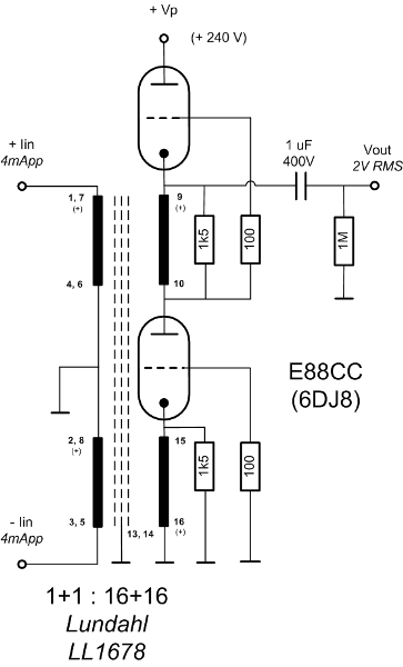

The only scheme I believe I have seen that doesn't violate the 25mv voltage compliance is the Laszlo's PP:
http://www.diyaudio.com/forums/attachments/digital-source/83747d1176897162-laszlos-valve-output-stage-lundahl-transformer-dac_tubeout.jpg
Unforunately it actually outputs 4Vrms which is too much. But it seems to be a design that could be perferected and more popular. Why has this stage met such obsucrity?

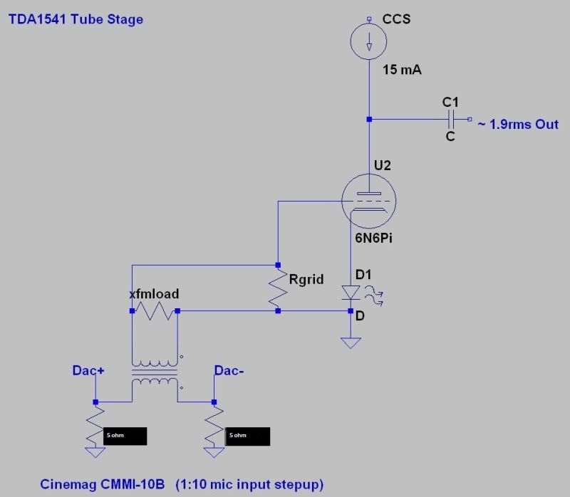

This is what I am trying to decide on building vs using a 1:10 cinemag input transformer with the passive IV and only one tube gain stage. I guess I would prefer the two gain stage idea simply because I don't have to come up with a scheme to kill the 2ma DC offset to be able to use the step-up transformers.
I know a lot of builders (as in overwhelming majority) just ignore the max 25mV voltage compliance spec when using a tube stage after the TDA1541A, but if one is going to all the trouble to DEM reclock, I2S input, etc, it seems crazy to dump the TDA1541A output into a 50 ohm I/V resistor (I know any design is a compromise though.)

The input impedance is 5 ohms (load seen by the 1541)! Much lower than any common/grounded grid scheme.
This is an order of magnitude lower than a typical tube DAC stage. Not saying it is unique, it is a very typical topology for mm preamps, just can't understand why its not used for DAC's? I mean it is such a common scheme to amplify low amplitude signals, yet I have never heard of anyone trying it with a DAC, why ??

I/V Transformer Calculator
I made a calculator for the following topology:
DAC - Transformer - Load resistor to GND - Common cathode tube amplifier stage
You can enter values in the yellow cells. n is the secondary/primary turns ratio. Rpri is the (AC) load impedance seen by the DAC output. Vpri should be within the voltage compliance of the DAC (+/-25 mV for TDA1541A, i.e. 50 mVpp).
I haven't ruled out the D3A, I am a headphone person, my headamp is a simple 5842 SE OPT, I think I have enough gain for the D3a stage. But even then I think I would have to go a bit over the 25mV compliance. Now according to testing in the following linkTDA1541A passive I/V distortion: the IMD isn't too bad until you get above the 50 to 70mV range. but its still probably a compromise and it looks like he is using a 2ma ccs along with the passive iv to get these numbers (also reinforcing that the TDA1541 would be unhappy outputing into 3V's.)
But I have these Cinemag 1:10 mic input stepup transformers. http://www.cinemag.biz/mic_input/CMMI-10BRevB.pdf With the TDA1541 being offset 2ma sink I would need to setup the TDA's for differential output (ie. 2 DAC's.) This way I can input the stepup transformer as in the schematic below below and cancel out the offset ( transformers like these can't stand any dc current on their windings.) I would even get some CMMR out of it. What I am finding the problem with this plan is no one seems to sell a PCB for balanced TDA1541 output, anyone know of one?
