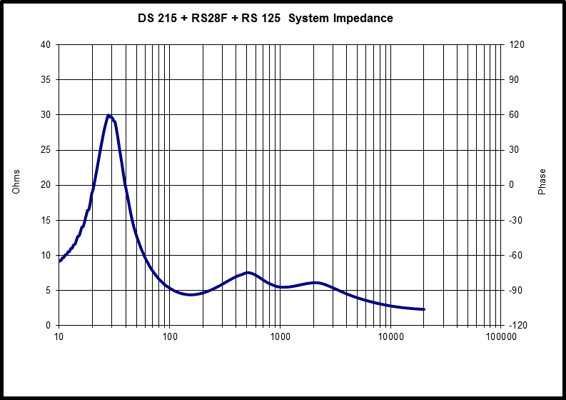

I've been experimenting with the Dayton combo in PCD, although I managed to come up with a reasonably flat response, phase tracking is all over the place. I use the provided FRD and ZMA files from Dayton, unfortunately no such data is available for the Visaton tweeters.
My layout is somewhat complicated, as I selected 3rd order for all drivers. I would like to stay above 5 ohms, however the RS28F is 4ohm and impedance falls under 5ohms at 3000 Hz. I suspect its not going to be a big issue, since there is little energy in the high frequency range but can't be sure. My component values look (at least to me) wierd, caps in the range of 50 to 100 uF with coils in the ranges of 0.1mH to 4.2mH. I don't know, I'm looking at the frequency response to be max flat.

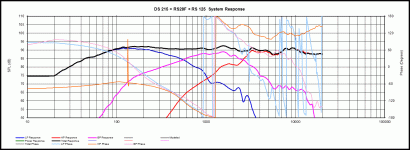

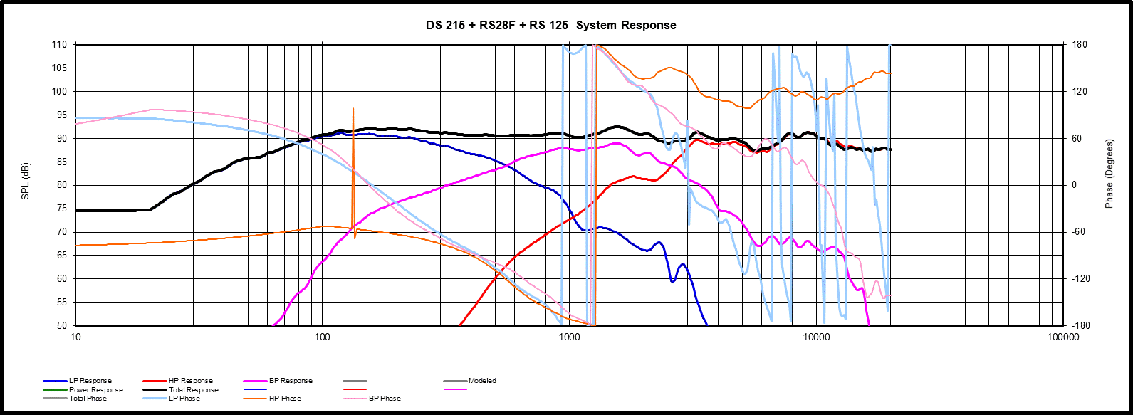

Update: I fiddled some more with PCD and came up with a 2nd order design for a proposed crossover layout. Will simplify construction and will bring the cost somewhat down.
I still don't know whether phase tracking is good or not and I cant seem to tame a small peak in the midrange. I would prefer to level the high section a bit more, but this might be due to the particular tweeter selection. Also, I don't know how important Zobel and LCR compensation networks are in a design like this. PCD suggests a 10mH coil in the LCR section for the midrange, which I think is overkill. Any thoughts?

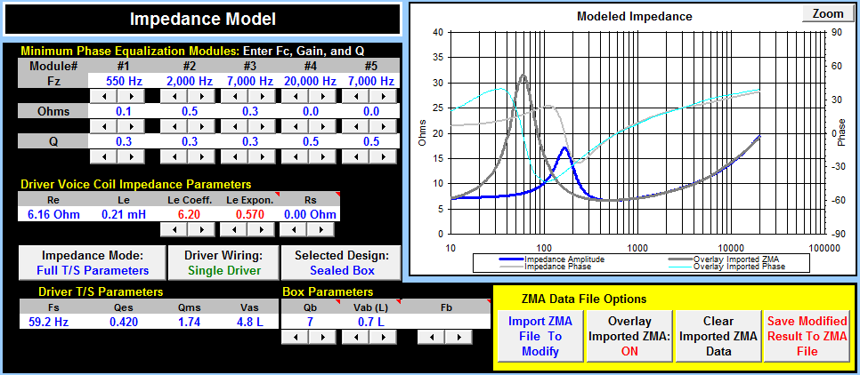

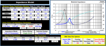

Gotta get yourself Response Modeler spreadsheet to generate baffle step curve that you will add to your Dayton graphs. In the Impedance model you can create zma files of your box and the small volume for the midrange. Import the zma files of your drivers in the impedance model and overlay it to the model created with TS parameters, then you can shape it with the tools ( minimum phase EQ modules, Le and Le expon.) until its inductive reactance part is exactly like the one from TS parameters except for the resonance peak, depending on particular case. Read the User Guide in the spreadsheet.
I'll post a .zma file as an example for your midrange.
The grey curve is Dayton zma of the driver measured free in air, and the blue one is modeled as shown. Now you'd only have to save it and your midrange impedance is pretty good for the sim.

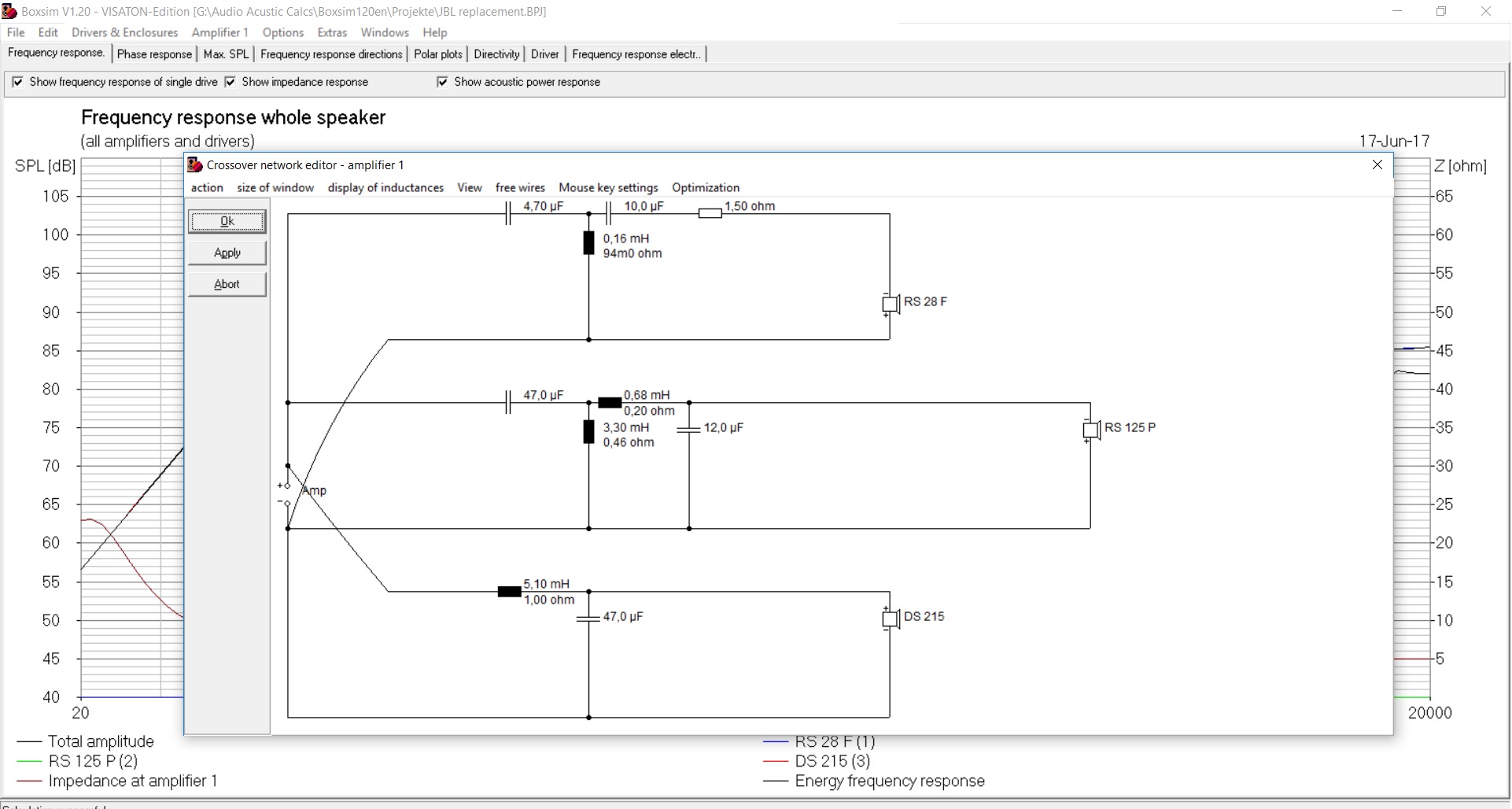

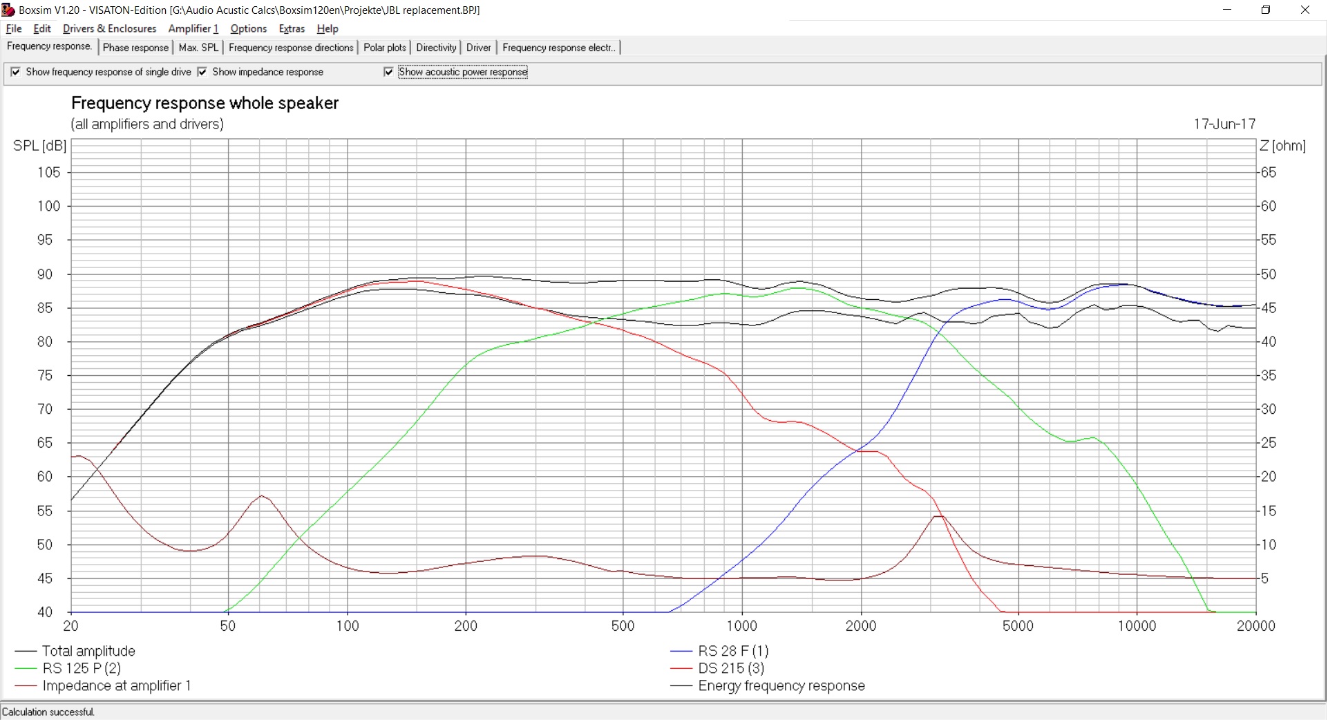

In the mean time, also gave Xsim a go, nice little program if you know what you're doing. Me, I'm just clicking and playing with component values and looking like a kid in a candy store.
At this point I got really frustrated, having spent more than 2-3 hours and no results. I picked up a program that some here may have heard about, others maybe not. It's called Boxsim 1.20 and its available on the Visaton site. Basically their own software for their line of drivers, however it allows for T/S parameters and FRD and ZMA files to be imported. It doesn't allow you to do quick checks until ALL speaker data is entered. It calculates baffle dimensions, driver positioning, damping, box vol and type and provides for a passive or active filter.
So I did model the whole box as measured, with the Dayton combo, put in the FRDs and ZMAs and made it work. However, the resulting crossover is somewhat different from what PCD comes up with. Basically I plugged the numbers from PCD and there is a little nice extra called "crossover optimizer". Selected components can be optimized to meet certain criteria. Can't seem to export results in a meaningful format, so good 'ol print screen. 🙂
Any suggestions on how to fix Response Modeler? Please don't tell me I need to go back to Win 7 and Office 2007.
P.S. I switched the mid driver to the Dayton RS125 P -8. Note reversed polarity on mid and tweet. Tweet is 3rd order.
