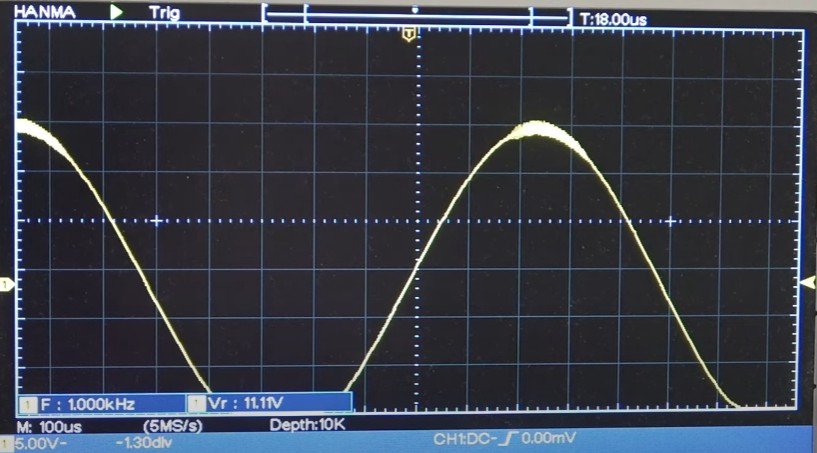

NEW L12/2 version 5. I have just received a pair of these amplifiers, I stopped testing because the boards are unstable
Disabled Account
Joined 2019
NEW L12/2 version 5. I have just received a pair of these amplifiers. I stopped testing because the boards are unstable.
Full details of my tests can be found here. Has anyone else tested these yet?

I can't tell from your photo of the sine-wave response if the waveform oscillates on the negative portion as well. Does it? Also, is the amp connected to a load? Do both boards behave in the same manner?
You mention (in your video) that you bought pre-stuffed boards. Do you know if their idle currents were set as a part of that? How does your experience compare to your friend's?

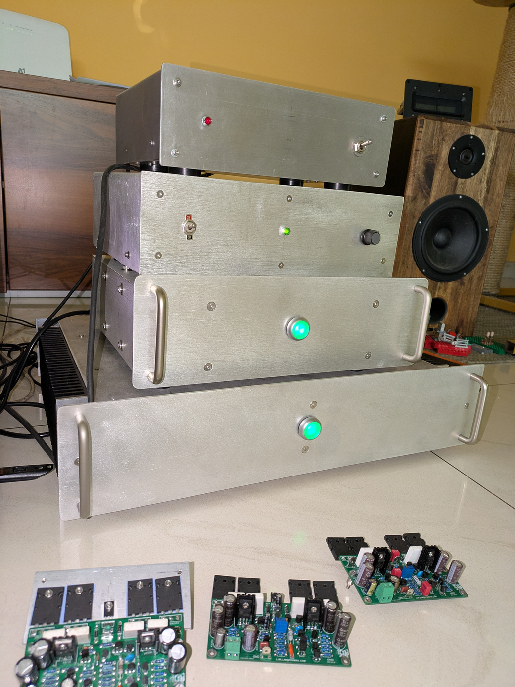

Yes, quite a few, and I have published test results here, at this forum. Most of them ended-up in trash. Meanwhile I went into my workshop to see if any is still there - just three boards have remained, the rest of them are now on scrapyard. Look at the snapshot below, these three remaining LJM boards besides my current system consisting entirely of DIY components (from the top to the bottom):
1. DAC based on Xingcore board
2. Preamp with 2-way Linkwitz-Rilley cross-over
3. Amplifier based on UPC2581V - for tweeters
4. LM3886 BTL Amplifier based on 12 chipamps in series/parallel configuration
All of these components are strictly Hi-Fi and I know that because I measure them.

For example, these asymetric oscillations look like unimportant details but they hurt the very core of the amplifier: even though they look like small enough to be ignored, they may degrade the sound signifficantly. These oscillations affect small high frequency signals "riding" on large low frequency waves. It is important to realize that these high frequency detalis are the core of stereo illusion. Once the amplifier reproduces high power signals these oscillations destroy important high frequency information and sound becomes dull.

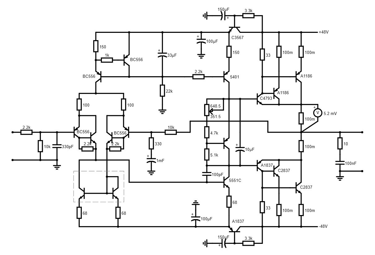

OK, I review the schematic from https://www.diyaudio.com/community/threads/l12-2-cfp-output-amp-120w-2-8r.196089/post-3373053
The signal ground and the power ground are separated with R24. It expects your signal ground and power ground are shorted at another place somewhere in the system, usually at the power supply or at the metal case. If not, you should replace R24 with a wire. Try it to see if the issue is resolved.
It is often overlooked when you test it outside the metal case.
If they are not shorted, the input ground is bootstrapped by the feedback network, which is positive feedback. It might oscillate.

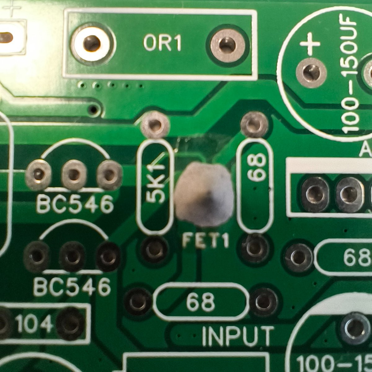

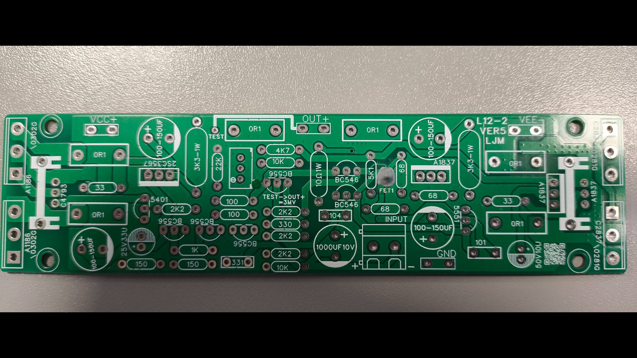

Before going into de circuit I need to say that I am a fan of LJM designs, I have a MX50SE and three L12-2 Ver 4, one of them working every day for a few years. This new L12-2 Ver 5 caught my attention righ away. As I am passionate about this topic, could not avoid the chalenge of finding how it works.
Now lets go to the circuit:
After examination it looks that the "Wart" is the current mirror of the input stage composed of two NPN BJTs (inside the box on schematic), this design seems to shares the input stage of the L20SE, the VAS has the traditional design with the 5551C (ECB) and the Miller compensation capacitor of 100 pF, the output stage is the CFP (Sziklai) configuration that is the brand image of the L12 design, this time with the drivers sharing more current.
New big difference to the old circuit is the two kind of capacitance multipliers in each rail feeding the input stage and VAS, perhaps a solution to improve stability on that area.
With simple simulation tests, and adjusting the voltage across the 0,1 ohm resistor to 5 mV, it shows a current on each power transistors arround 16 mA and 19 mA on the drivers. The current on the imput stage and VAS is 4 mA.
The solution of instaling the Vbias transistor to only one of the drivers to thermal coupling simplifies the circuit.
The current source circuit for the input stage and VAS shows a different aproach, usualy the cap (in this circuit a 33uF) negative pole goes inside two 10K resistors and this time is connected directly to the base of the transistors and only one 22 k resistor to ground, this design seems to have some oscilations during simulation.

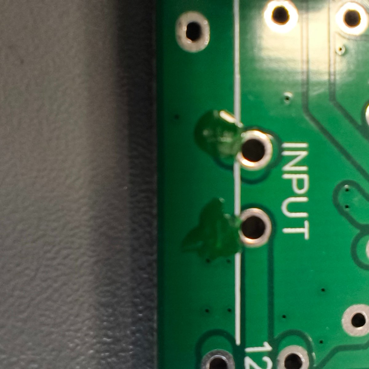

To avoid reverse engineeing other tricks were used besides the "Wart", green glue strategically placed to avoid see trough and two dead ends on the circuit tracing.
Now I will solder all the components and do a "dyno" test on the bench, the results will come soon.
Everyone with additional information fell free to comment. Thanks
