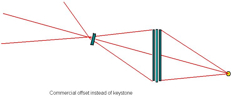

thats exactly how my OEM sharp xge690U projector adjusted keystone. It had a fresnel after the lcd that tilted up or down to adjust keystone... then it would be bounced off a first surface mirror and then through the lens...
so its an idea that has been proven to work.

good to hear is has been used by commercial Projectors. I will try to find some simple/cheap stuff to make a keystone adjusting device

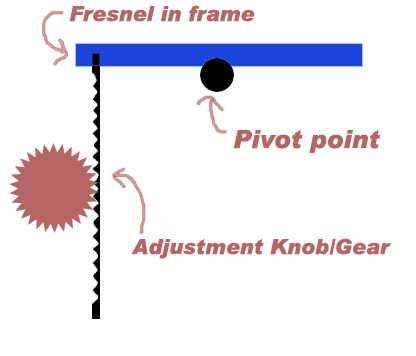

Ok, so I'm really rought with photoshop, but I think you'll get the idea of what I'm proposing here for an adjustment mechanism.
I took the mast off my OHP built my own, all the parts I would need to build this mech could be swiped off that mast.

Maybe you could just fix the frame with bolts and nuts in it's position once you've set it . I mean DIY projectors usually are not moved quite often.

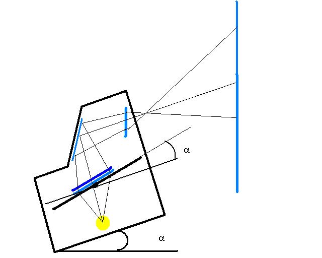

well guys i got my infocus lp220 today and i found out it has a keystone for those who are interested it has 2 frensels, the front one tilts for the keystone about 10deg maybe 15 at most but at full keystone at such the small degrees it makes one hell of a big impact on the projected image, so for those who are going to get into the keystone thing i think the tilting of the top frensel is the way to go, a simple cam is suficient for this, for those who are interested ill draw a pic of how the one in the infocus is set up if you guys want it.

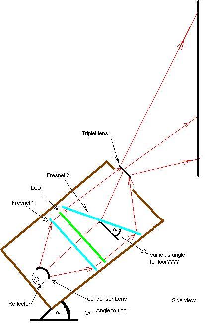

Ok, I want to ceiling mount my projector. I want to mount the PJ 10' from the screen, giving me an 8' by 6' screen. I am trying to figure out what angle to mount the PJ from the ceiling, and therefore the front fresnel, as the angles are congruent. Anyway, i have a couple questions and any help would be appreciated.
First of all, is it just as simple as tilting the top front fresnel (top) and leaving it at that, or do I also have to tilt the projection triplet? I have read through all of these posts, but it is not clear. Second, Anyone know the correct angle to mount the PJ from the ceiling in order to get a 8x6 screen that is 1 foot from the ceiling (therefore the center of the screen is 4 feet away from the ceiling)? Also, since i am mounting on the ceiling, will the fresnel be tilted perpendicular to the ceiling? I hope these question make some sense. It is kinda hard for me to know the best way to word these types fo things. I guess it would be easiest if someone would whip up a drawing. I appreciate any help.

I just tried it on my PJ, and got it to work 🙂 I will probobly be working on making a more permenent way of tilting the fresnel, but it works for now. One thing you need to watch out for is your fresnel size. I didnt see anyone mention that if you rotate your fresnel 30deg, you will only be able to consider its width to be 86.6% of whatever it was initially. To find the percentage for your given rotation, just take the cosine of your angle. Luckily, the width of my fresnel is large enough to compinsate for this reduction in 'usable' width, and so this works for me. Also note that you will probobly not be rotating your fresnel 30deg... you never know... Just take the cosine of the # of degrees you rotate. I was able to get everything to work by simply rotating the fresnel. The projection didnt seem to need rotation.
Im not sure about the relationship between the angle between your PJ and screen and the angle between your LCD and fresnel.
