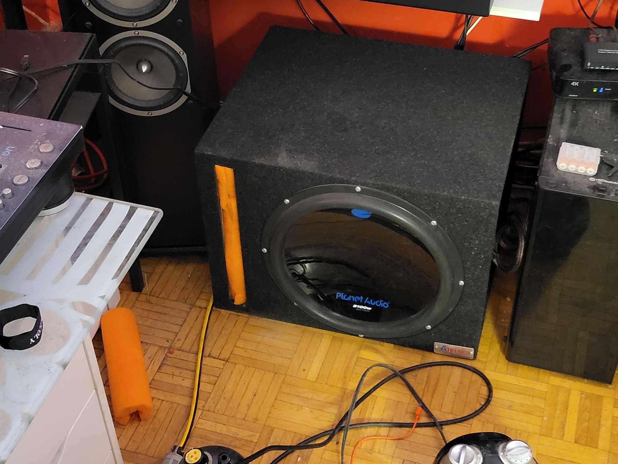

So I decided I want to play with a subwoofer in the house but I didn't like the price/performance of any of the powered subs for home I saw that were affordable for me.
But: I used to put subs in my car, and I have a Yorkville AP1200 sitting around so...
I bought:
https://atrendusa.com/products/15-single-vented
and
https://planetaudio.com/product/ac15d/...
I'm going to use a CX2100 active crossover that's dialable down to 10Hz, and the Yorkville can push almost 1kW into 8R in bridge. I have a small apartment so efficiency isn't important, just low frequency. My main speakers are 31Hz -3db so this will just fill in the bottom for things like explosions in movies or super low notes on some music.
Even including what I paid for the Yorkville, this build cost less than 300$ since I had the crossover.
Thoughts?
It arrived, and I put it together.
Pretty good. Thinking I'll cover the port slot with acrylic to "seal" it though - massive chuffing at 10Hz.
