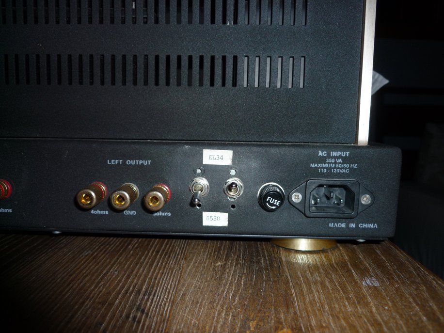

I recently bought a used jolida 302b. I’m the third owner. I was told it has been modified but the last owner isn’t sure what was done to it. From searching this forum I read that there are quite a few mods for this amp. I was hoping someone could tell me the funtction of a couple switches that were added . I also noticed that an extra pair of RCA output jacks were added.
I’ve included some pictures of the outside of the amp to show switches and output jacks. Based on two little labels, I think the switches have to do with types of tubes. I can add an internal picture later.
I was told by the previous owner that the balance control had been bipassed and he didn’t know what the switches were for and just never used them.

I've learned that this amp was modified at the factory. I emailed jolida the serial but haven't heard back yet.
It makes sense to me that the switches would be for different tubes. They should either both be up or down not one up and one down right? Sorry for the simple questions, i'm new to this stuff.
Where can i find a manual for the 302b? They are not posted on there website.
