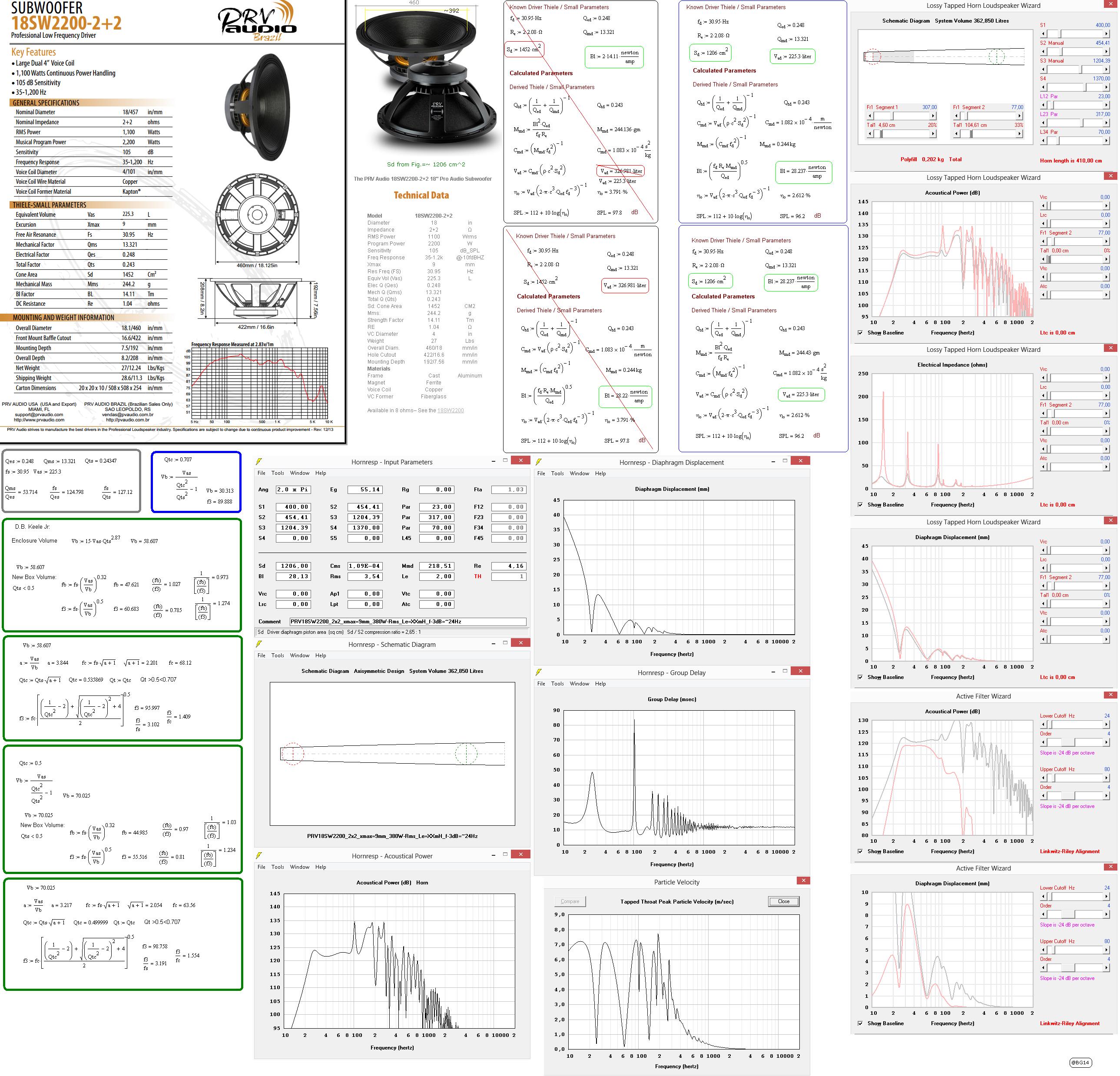

New interesting PRV 18" driver.
May work for someones special project.
Link
Overview
PRV Audio's 18" 18SW2200-2+2 subwoofer performs at many levels above its price point. 9 mm of Xmax, a 4" diameter voice coil, dual spider, and cotton M-Roll suspension all combine to form a subwoofer that remains linear at power levels up to 1,100 watts RMS! The class leading 105 dB sensitivity (2.83V/1m) offers the performance of up to four 18" subwoofers in a single driver package.
the specs seem a little wonky (SD in the 1400s? really?)

Anyway, did you notice that the Qts is a wee bit low? This is the "trick" for high SPL drivers - they are overdamped. This is fine for a 10" that will be used as a midrange, but for a subwoofer this means that the bass will be rolling off in a large box, or require a higher than usual tuning frequency to remain flat in a smaller box. So if you are looking at this for a home subwoofer I would check it out using a box modeler first before buying to make sure it will perform as low as you would like.
Also, 9mm Xmax is not all that much. You can get a Dayton UM18-22 with twice that much for about the same price I think but with vastly different SPL (much lower) and Qts (higher) values that are more suitable for home use as a subwoofer.
Yeah, specs are a bit of a mess since this is really a nominally 6 ohm driver with series VCs, so I calculated Sd……..

edit: missed that the specs were with parallel VCs

Anyway, did you notice that the Qts is a wee bit low? This is the "trick" for high SPL drivers - they are overdamped. This is fine for a 10" that will be used as a midrange, but for a subwoofer this means that the bass will be rolling off in a large box, or require a higher than usual tuning frequency to remain flat in a smaller box. So if you are looking at this for a home subwoofer I would check it out using a box modeler first before buying to make sure it will perform as low as you would like..
That's not too much of an issue when driven under power though. Unless the BL curve is ruler flat, which I doubt is the case, Qts will be higher as soon as the coil starts swinging in and out of the magnetic gap. The more excursion, the higher Qts rises due to Qes itself rising. It would not be a surprise for me to see Qes double as the coil is nearing Xmax under substantial wattage.
Yeah, ages ago on a HT forum someone had built a then very low, powerful sub system array and decided that if 'x' power was getting him 'y' peak SPL in a 2 m ground plane measurement that doubling the power to match the speaker's 'music power' rating would add 3 dB, but I claimed that it wouldn't play as loud as it currently did due to thermal power compression, which was met with a bunch 'tongue clucking' and a general questioning of my technical knowledge.
To the sub owner's credit though, he posted the new 2x peak power measurements, which showed that the system was fully 6 dB down from the original measurement!
Due to material, manufacturing improvements since the late '90s, I imagine the losses wouldn't be as great, but designing a system that keeps the VC heated up due to high power/lowered efficiency must be factored into the design to reliably meet the app's performance goals.
