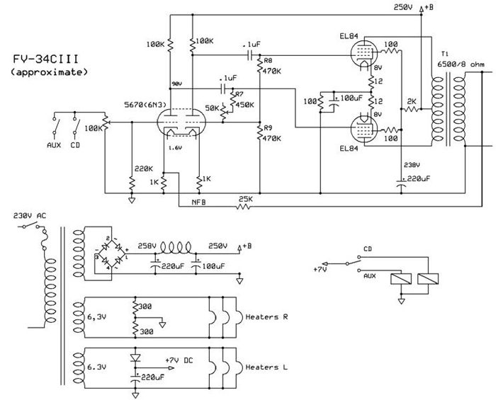

#1 Welcome. Looks like you have a great deal for around $75.
#2 In your amp, there should be two AC balance trim pots inside, one for each channel. I would put the JJ back in and use this trim pot to see if the sound improve first. Note: For inexperienced, going back may take time (or not easy) once you touched that. You can take an ohm meter and measure the previous value before you change anything. Also note which tube go to which location.
Here is a version of the schematic for your amp.

Thanks Alllensoncanon, but the Fv34ciii is fitted with an auto-bias. Already spoke with the retailer and his answer was to skip the JJ's. "JJ's are perfect tubes, however not with the FV34CIII", he said. His advice was to stick to the Shuguang EL84 tubes and go for the STR version of them...... Don't know where STR stands for....

The trim pot in your amp is not for DC bias. It is used for AC balance (to balance non-matching EL84). It is possible that your two JJ EL84 (or the previous old EL84) are not exact match. Hence the tone difference. Unless you are doing the tube matching yourself, I wouldn't expect much. I would also make sure the circuit is tuned the way it should, before rolling any tubes.
