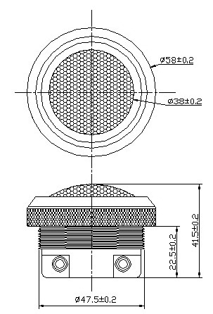

hi,damage :

I am speaker and box design engineer, so this is my own design and manufacture.
but, I think it's not good, want to ask everybody to give me advice and see if we can do better.

jam-steven said:hello, everybody:
Recently, I made a HI - FI tweeter for car audio,Please give me some advice,(Including the appearance and SPL curve) Because I want to do better.
The SPL curve is not so good!
thanks very much!
It looks spectacular to me.
The mount doesn't quite match the cosmetics and quality of the CNC'd housing, a machined mount would look better, but I'd be very proud as it sits.
As far as FR graphs go, yours looks great. What are you unhappy with?
Is that a Vifa XT diaphragm & phase plug?

Thanks for your reply,
this sounds very exciting,
but, my customers and I think it is not flat, (2.5 -3K, after 20K), we hope can do more smoothly.🙁
Yes, this is the study of the practice Vifa XT.

Is the frequency response graph with or without the cover?
Also what are the dimension of the driver?

hi,guys!
This is the test of standard baffle, test condition is 1 meter 1 watts

Can you re-post the FR graph with a more conventional SPL scale? Say, 40dB to 110dB (or perhaps the same scale as that used on Zaphaudio.com site). That will give a better representation of the frequency response.
The phase plug looks a little shorter than stock, did you modify it?
Can you post phase response?
And maybe a Frequency response without the grille in place?
