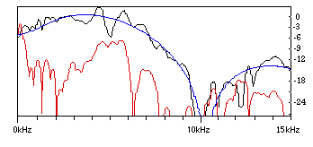

Now, you have chosen a woofer that may be a challenge to work with. I have never tested your exact driver, but I have tested another 6.5 inch Audax Kevlar. Its breakup pattern is consistent with many of the Kevlars on the market, so I expect yours to be similar (but not identical).
In the attached graph, the conventional frequency response is drawn in black, the decay response in red, and the onset response is in blue. The driver has a generally rising response until most of the output is coming from a variety of resonance structures.
While I evaluated the driver in the graph, I did not build a loudspeaker with it. The problem is finding a tweeter that will sound nice at the bottom end of its range to cross it over to this woofer before its resonances begin to dominate.
If your driver follows this response pattern, my best advice is to equalize the rising response and then roll off the woofer fast (24 db per octave, lots of people would go for a Linkwitz-Riley).
Good luck, keep us posted, and try out the SpeakerWorkshop software.
Mark

Thanks for the information Mark!
I've been doing some searches online and have only found 2 designs utilizing this woofer. After seeing the response curves i'm starting to understand why that is! I have them mocked up in a ported enclosure and have noticed the harshness in the x-over region (which is around 3K and is mated to a beyma tweeter). Admittedly i'm only using a 2nd order x-over which isn't going to be steep enough to attenuate the nastiness this woofer has (i assume it's a result of the carbon fiber cone).
Is this woofer worth the trouble??

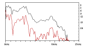

Scott,
Every woven "fiber" cone I have seen is a laminate. The fiber mat is embedded within sheets of thermoplastic. I have not done enough research to say with any certainty, but my gut instinct is that the break-up is as much a consequence of the plastic as it is the "fiber" mats.
I have attached a graph of a woven carbon fiber driver by another manufacturer.
Mark
