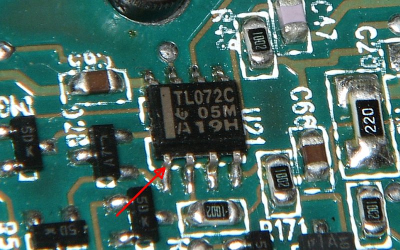

I have done some searching and it appears that U21 is a common failure that causes this type of problem, which would be a new experience for me. Aside from U21, the amp specs on crutchfield say a 4 gauge wiring kit is required along with a 100amp fuse. Could my 8ga kit and 50 amp fuse cause the protect mode?

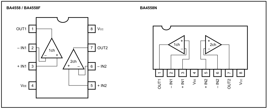

When checking the U21 pins, do I put my black probe on the amp for the ground also?
Ok here are the measurements assuming I did it correctly, black probe on amp ground, red probe on each node of U21, vehicle running. I'm not sure the correct order so imagine U21 is written at the top then numbered left to right:
U21
1. 5.02 2. -9.69
3. 7.82 4. -8.82
5. 8.35 6. 7.77
7. 9.66 8. -8.32
Ground to REM: 14.45
Ground to B+: 14.44

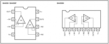

Copy and paste the following list. See attached photos for pin configuration and pin 1 reference.
Pin 1:
Pin 2:
Pin 3:
Pin 4:
Pin 5:
Pin 6:
Pin 7:
Pin 8:

I have a soldering iron, but need a new tip for it. I have soldered some 14ga wire for some automotive wiring and that's about it. If I had to I could find someone with better soldering skills than myself.
From previous research where I saw you both provided input, I think I remove it with some Chipquik, clean it up, and then resolder?
Consequence of doing too many things at once, I think I made a mistake when matching my numbers to your schematic. This may change your diagnosis but maybe not the solution:
Pin 1: 5.02
Pin 2: -9.69
Pin 3: 7.82
Pin 4: -8.82
Pin 5: 8.35
Pin 6: 7.77
Pin 7: 9.66
Pin 8: -8.32
