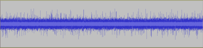

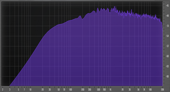

Extra thanks added for these graphs, VERY useful.
The first one shows me that the "crackling added to plain pink noise" I heard is actually there, those WAY louder than average peaks.
I am not into Hi Fi or PA but Musical Instrument amplification, the frequency distribution shown will be very useful to me on 2 counts:
1) the bass rolloff somewhat mimics MI output.
2) the increased HF peaks do not exist in Rock Guitar sound, which typically roll down 24dB/oct above some 3 kHz, but are *great* to test extended range Bass Guitar cabinets, when used by Slappers.
Which are a great part of my customers ... so much so that my Bass preamps include a "Slap" button, go figure.

Actually, the spectrum is flat down low.@ JMFahey

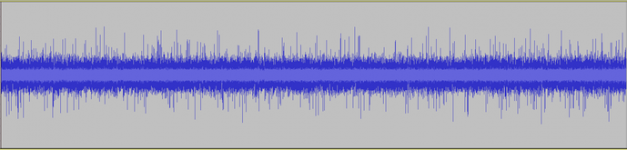

Here's a couple of screenshots
Just yesterday I downloaded the .wav and used it as output from Clio.
I´ll test some speakers next week but the 17,5dB CF makes me a bit scared - my test amps are either an UcD180 (40Vp) or an UcD2k (140Vp😬).
