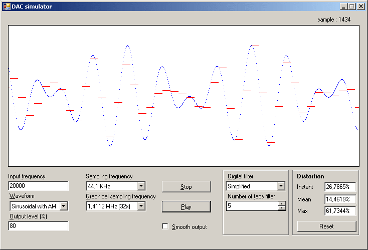

Hello Oliver,
The simulator is written in C#, (µsoft .NET 2005) it is not and ended project, I add function to have wide comprehension of digital audio. If you are interested in, we could share this project. Final version will be free to download.
Eric
With the simulator, you could see real output samples. Testing digital filter with various, non cyclic, input waveform is very interesting. Instant distortion is often greater the theory.el`Ol said:...But if your simulator has some useful features I can`t easyly implement in Mathematica I can calculate the filter coefficients.
Eric
On the actual DAC simulator, I implement a simplified digital filter like you could find in Wadia and of course standard Sin(x)/x filter.
I will mail you the coefficients. How much oversampling? 8x? 16x?
Center on a sample or between two samples?

Hi Olivier,
Eric
2x oversampling between two samples. I think, like over filters, to obtain 8x ovsl you cascade filters.el`Ol said:I will mail you the coefficients. How much oversampling? 8x? 16x?
