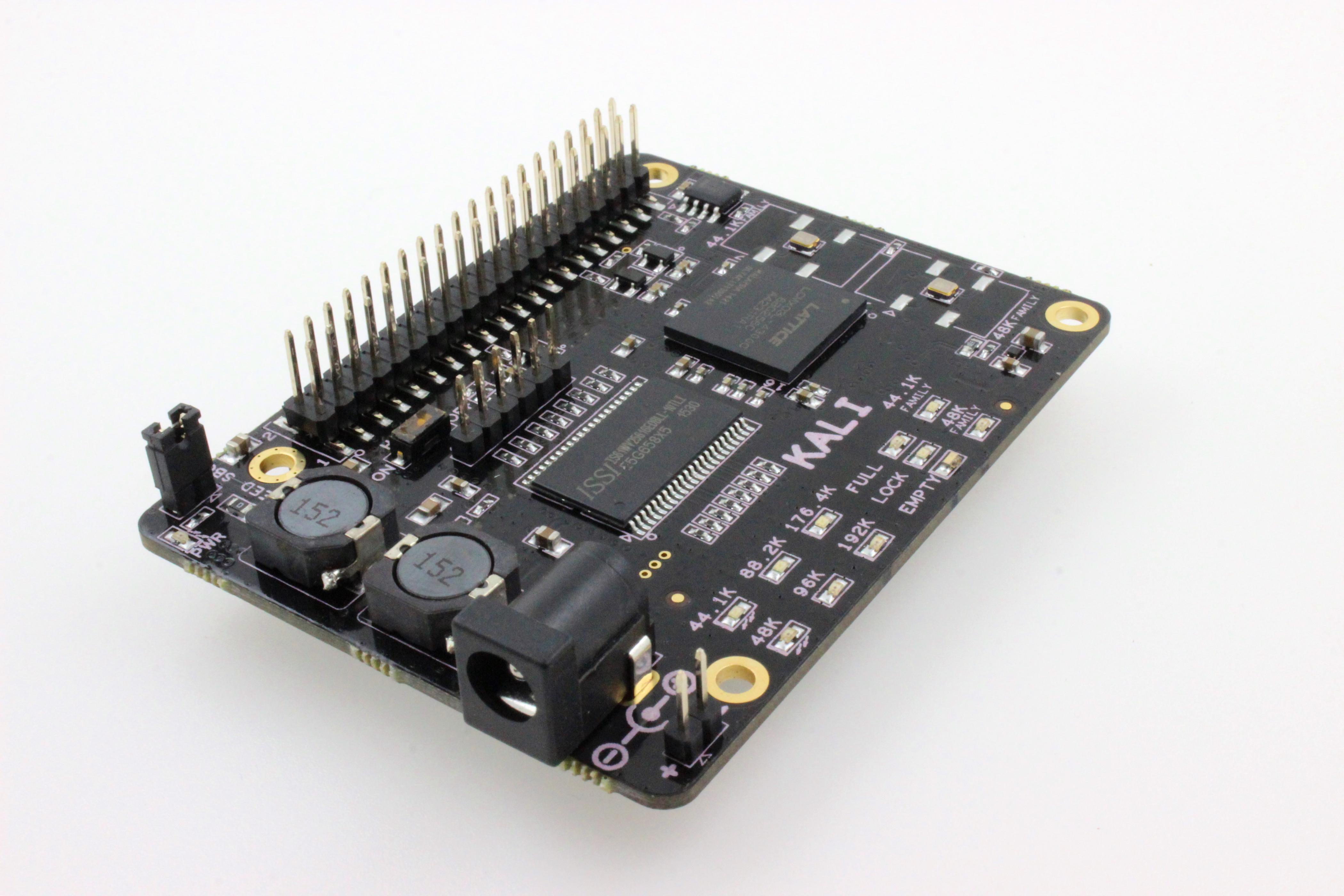

in the past few months we have worked very hard on a new shield for RPIs/SBCs.
Basically the main idea belongs to Ian's. His hardware is actually superior to ours , mostly in the way he implemented the clocks and to the attention of the detail (like mounting xtals on a pcb supported by elastics ). So we credit Ian's idea and his great design.
Our hardware/soft is not a copy , its an implementation of the same idea. We use a FPGA and sram to buffer the DATA and we reclock bclk/mclk outside the FPGA using NDK (or Crystek) . The board has an eprom but its not HAT complaint (because of the space). FCC will be available for the board.
Main reason for making the board was to try to correct the audio clocks of SBCs and bring high quality audio to anyone that has an SBC around..for a great price.

Can you please tell in some articulated way, why you assume that the 40-pin connector of Raspberry Pi Single Board Computers (SBCs) can't deliver a high quality full duplex I2S digital audio stream?
Do you assume that the 40-pin connector Raspberry Pi can't deliver a high quality full duplex I2S digital audio stream :
What about playing the audio through SPDIF? What will happen in case the SPDIF speed is not exactly 44.1 kHz or 48 kHz?
You wrote that you rely on a FPGA and SRAM for buffering the audio data, to be reclocked outside the FPGA using some Ultra Low Phase Noise Quartz Oscillator.
What is the advantage of relying on a FPGA and SRAM, compared to relying on a SRC4382 chip like there is in the $45 MiniDSP DIGI-FP ?

RPI has an on board xtal of 19.2Mhz. For the 44.1Khz audio the LR Clock must be running at exactly 44.1KHz, but this is not possible since the frequency is not a multiple of 19.2MHz. So RPI will either run at 44.138 or 44.036Khz
With a FIFO buffer everything is re clocked with one of the 2 xtals on board (with the correct value)
Regarding under/over run yes that's possible, but we calculated the file has to play continuously for a few hours before it can happen. In that particular case the buffer will be reset to initial condition (about 0.7s )
Otherwise as soon as a gap is detected (between songs) the fpga will reset the buffer.
This shield its meant to work only with SBCs i2s RPI connectors , so no USB/SPDIF for the moment

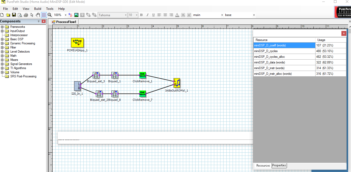

New DAC for RPI with subwoofer out (2.1 or 2.2)

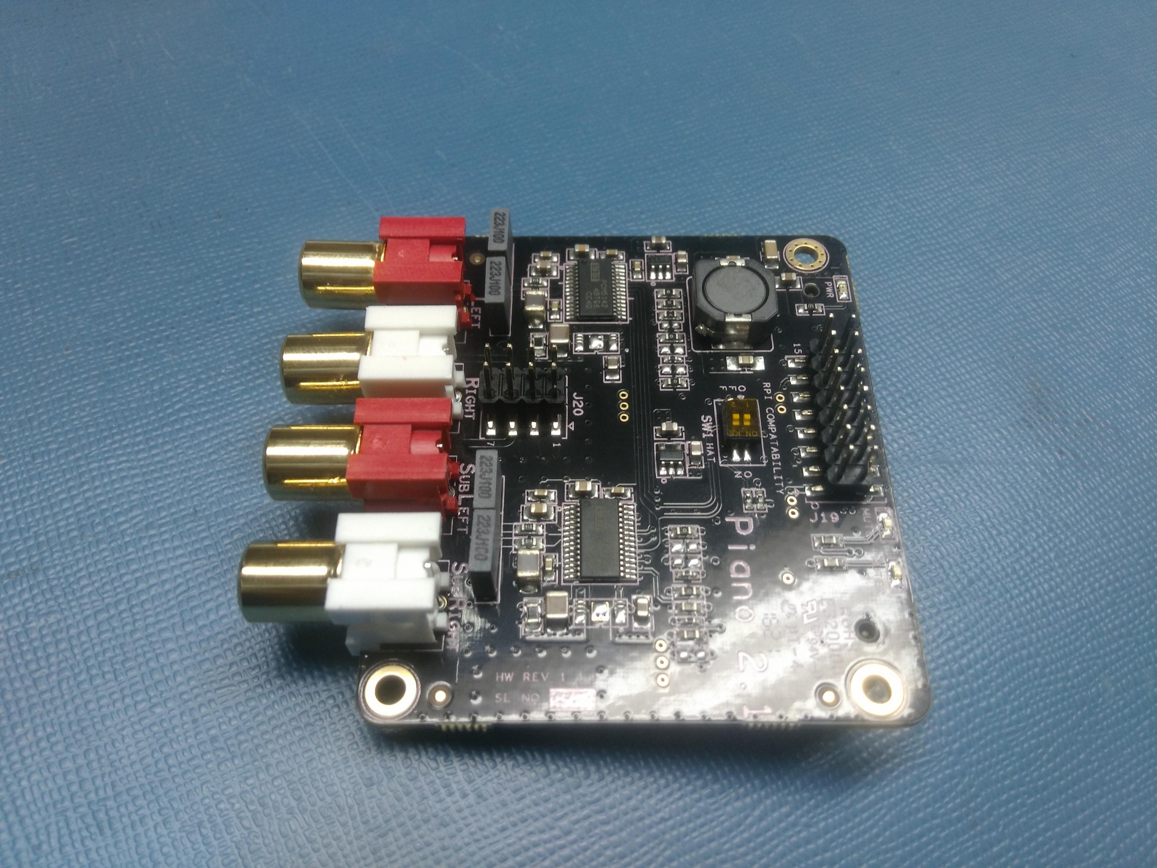

We have designed a new DAC working with any SBC/RPI (i2s)
We are using 2 DAC ics PCM5142 with integrated DSP. The PurePath software from TI is available for download (registration required) and can be used to create specific filters and other audio functions.
The board will come pre programed as a 2.1 output (but you can create your own custom design and load it the board and can access the xover frequency directly from linux (we made a small app)
Hardware wise , we have split the digital and analog side with LDOs and we feed the analog side using an extremely capable (low noise ultrahigh psrr) LT3042. Basically each board has 4 LDO (2 for each DAC ic) (note that digital side uses cheaper LDOs)
Of course , on the analog side we used only thin film resistors and poly caps in audiopath.
This DAC has RCA outputs but also a small connector that will connect to our TPA3118 AMP shield (only LR)

For an increased selling price say $99,
1) Is it possible to hook four STA326 I2S-in Class-D power amplifiers or two TDA7801 I2S-in Class-AB power amplifiers ?
I'm thinking about two 10-pin headers conveying the following signals :
Please note, the FPGA should issue four I2S lanes (with same master clocks).
2) Is it possible to hook two stereo ADCs for carrying 4-ch audio measurements ?
I'm thinking about one 10-pin header conveying the following signals :
IMO, the 11 LEDs are a waste of real estate.
Better keep one or two of them on board as debug, and have a 14-pin header carrying the 11 LEDs signals plus VCC plus GND enabling to built front panels, also featuring a 3-pin 36 kHz infrared receiver.

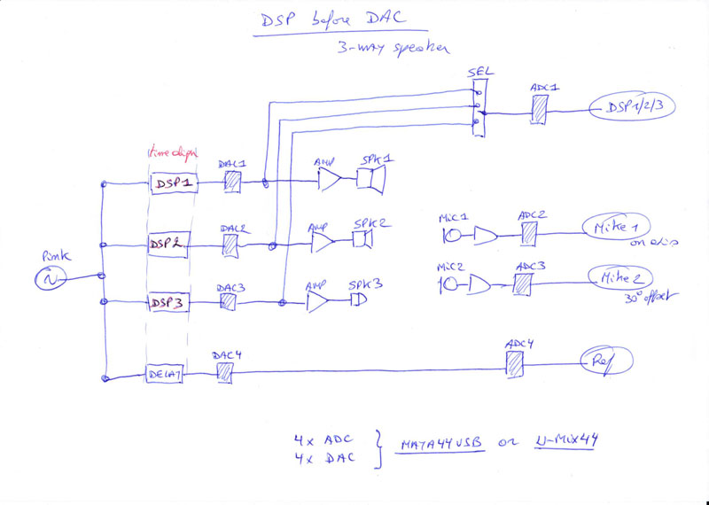

Attached is a .jpg explaining why during the microphone-based setup, it is recommended to feature four analog inputs (two identical stereo ADCs).
1. The bare speaker transfer function is equal to Mike (1 or 2) divided by DSP (1 or 2 or 3)
2. The DSP correction that's currently in use is equal to DSP (1 or 2 or 3) divided by Ref
3. The global transfer function is equal to Mike (1 or 2) divided by Ref
