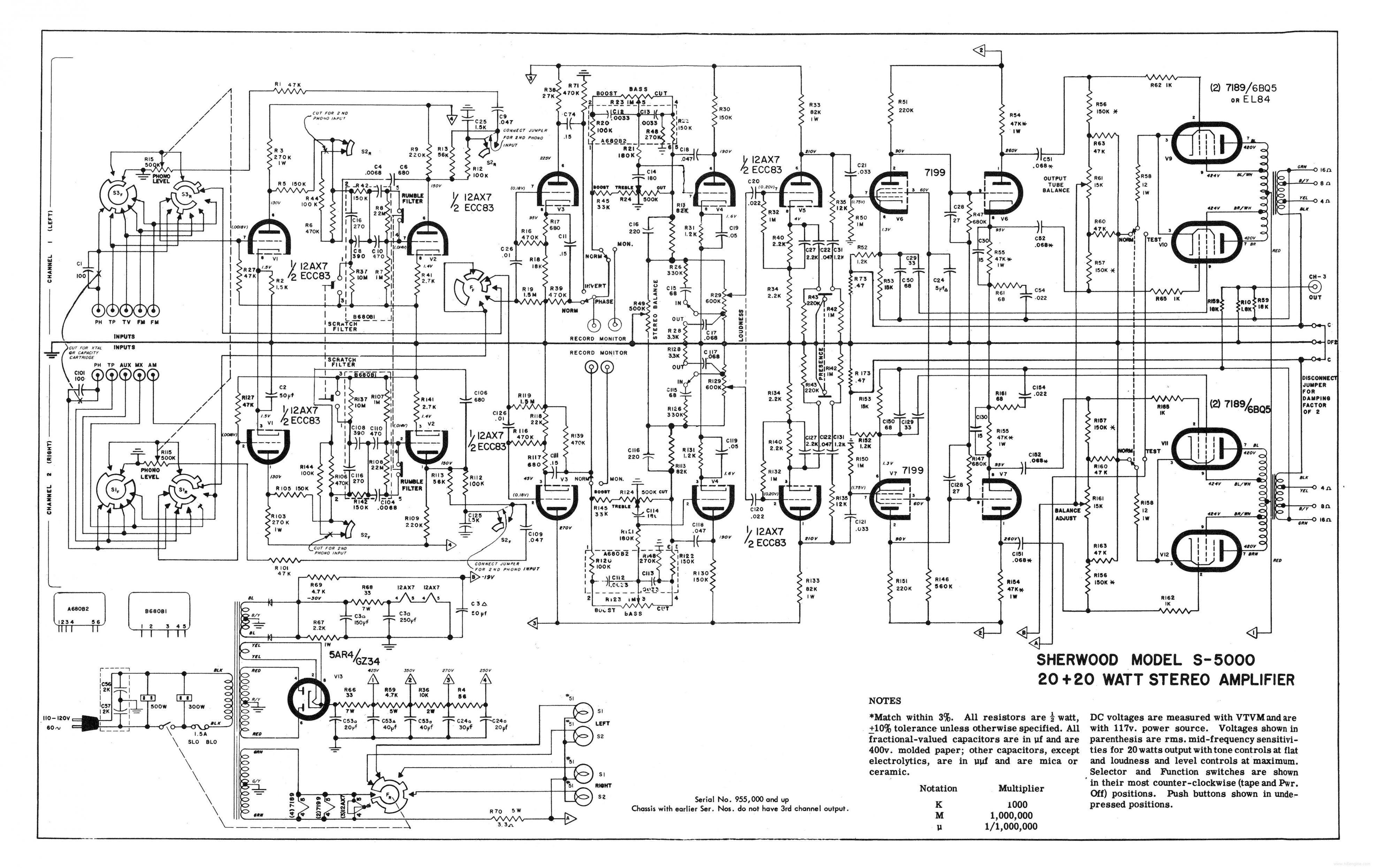

Although these are apparently quite common around here (made in Canada by Electrohome for the US Kinsman organ company), I have had troubles finding a schematic. I have posted one image of a likely possibility. I don't have these in my hands yet so I will post more pictures later when this becomes possible. Pretty sure most of the music related circuitry is already gone - hence the empty tube positions.

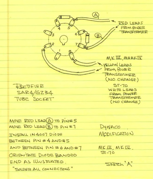

The B+ PSU is easily "goosed up" by using Sovtek 5AR4s, with the series SS diode tweak, instead of 5V4s. Heating current for the 2 types is the same at 2 A. However, the 5AR4 exhibits a smaller forward drop and is more tolerant of a decent sized 1st filter capacitor. 🙂 UF4007s, instead of the 1N4007s shown, are inherently quieter, but the vacuum rectifier will block SS diode switching noise from entering the B+ rail. Given my "anal retentive" mindset, I worry about noise sneaking into the power trafo. Less noise, from the outset, can't be bad. If at all possible, make the B+ filter CLC. The affordable Triad C-14X is rated for 200 mA. and the 5V4 is rated for 175 mA.
The Russian 6Π14Π-EB (6n14p-ev), AKA EL84M, is a nice, true, 7189 equivalent. The 6Π14Π-EB exhibits decent sonics and is "tougher than old rubber boots". :up:
Modeling the power section of the Sherwood S5000 is (IMO) a good idea. The 6GH8s you already have, along with the 6BL8 and 6U8, substitute satisfactorily for the made of "unobtainium" 7199 shown in the schematic.

Definitely I will be using a half of the Sherwood 20+20, configured with one 6HG8 driver∕phase splitter. I have a couple things I need to solve however. Hoping the folks here might be able to share some insight with this Sherwood S5000 circuit...
In the attached mark-up I have outlined the amp section, or the circuit I will be creating for each monoblock:
Sign in to your account
If I don't want the Damping Factor control, is it correct to delete the wire shown in blue, and eliminate the 0.47 Ohm resistor R73 at the driver pentode cathode?
Is it possible the 1W resistor R58, 12 Ohm is a typo in this diagram? It seems odd that a 12 Ohm value follows the 47 kOhm (R60∕R63) and fraction of the 15 kOhm trim pot (R61) in series... Seems like this would be more likely 12 kOhm, and not 12 Ohm.
Also the notes at the bottom concerning the capacitor values are a bit confusing. It says '* Match within 3%... ... All fractional valued capacitors are in uF and are 400V, molded paper; other capacitors, except electrolytics are in XXX and are mica or ceramic' (can't read the XXX, looks like uuF, which makes no sense). Also every cap on the schematic uses the symbol normally applied to electrolytics - so I am left wondering which should be electrolytics and which ones should be ceramic∕film∕mica etc.
Thank you everyone, as usual - any input is much appreciated!
Best regards,
David
That XXX is μμF., which is how pF. used to be expressed.
