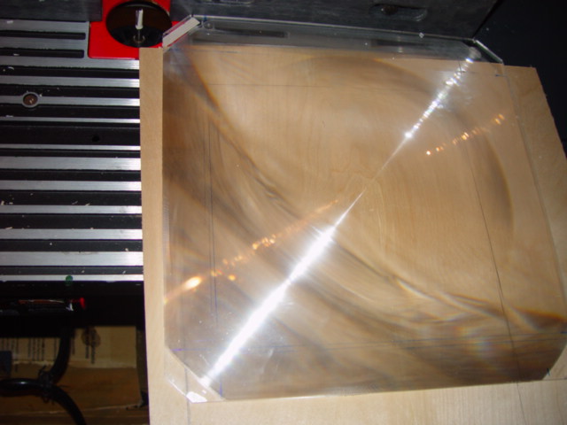

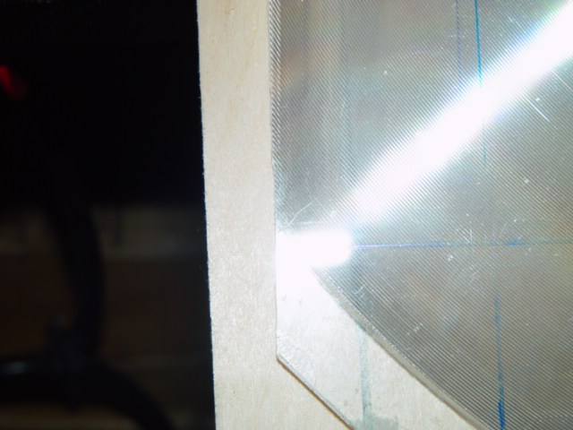

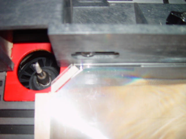

I would be interested in seeing that, I would hate to bust a brand new fresnel by a spliitng attempt the wrong way.
mhelin said:Could someone take photos on splitting the fresnel, with the tools to do the job etc.?
heres the way i did it i tryed the dremel and it does work but the razor sharp edge you get from a router is "the catz ***"
