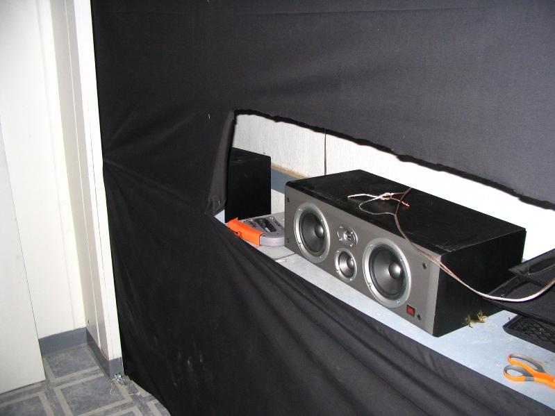

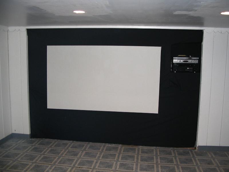

i took some pictures to show everybody the size of the closet and my intentions...
In the first pictures you will see the size of the closet, to give you an idea of size the screen pictured is a 90" diagonal screen.

Don't sell yourself short, it looks like you have an awesome setup there.
Unfortunately, it looks like you have a hard floor and ceiling. This is a big factor in favor of MTMs, since the reduced vertical dispersion should help limit floor and ceiling interaction. Also, you'd want to have some flexibility in mounting height for the speakers. You might need to move the up or down by several inches, even a foot or more, from ear level.
You do have one advantage in that dedicated closet; you can put all kinds of acoustic foam on the back and side walls without having to look at it.
How acoustically transparent is the screen? Can you maybe have the center channel mounted vertically in the center of the screen? The horizontal orientation is really only preferred because it lets you place the center speakers closer to the center of the hard TV screen. With a suitable projector screen, you no longer have that problem and can place the speaker in its ideal spot.
I think that if you can have them all standing up, three natalie portmans across the front would give you awesome sound, and all the SPL you could ask for. Oh, and the system will be good enough that you'll get a noticeable upgrade in sound if you should ever have a surplus of cash and the desire to upgrade your receiver.
