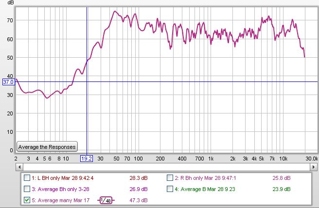

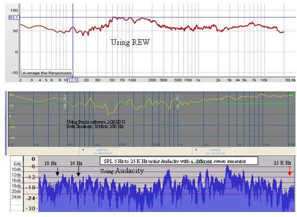

Hello to all. been reading post on your site for over a year. finally decided to build a set of speakers. I need help. I do not understand why the results for a 1.3 cu ft speaker can possibly be like this.

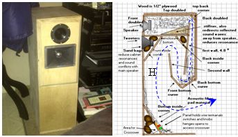

The only way to get the low distortion and high efficiency was a horn, as it had to be small I designed a 40” ¼ wave folded exponential horn using as much of the box as possible. For added bass used bass doubling by setting them on the floor and rear firing to use doubling with the back wall. The main speaker, to help the SPL is front firing.
The speaker size was already determined. My wife said small or not at all. When she met me I had a pair of 5’ speakers with 12” drivers. They sounded great but…I was replacing a 16” cube subwoofer and two 8 X 6” shoebox speakers. Not counting the 3” stand alone super tweeters this gave me 4, 672 in^3 for two speakers. 24” tall, 12” deep and 8 “ . this left 25 in^3to spare
To have a low distortion, High efficiency, small driver at about $25, I chose the Dayton Audio RS100-8. A horn uses the driver as a piston so the low freq cutoff can be way below the f0 of the driver if it is low mass, long excursion, with a large magnet and phase plug for low simbiance. I wanted a 3” driver as distortion is inversely proportional to size.
I wanted to reduce Doppler distortion and IM as well as have the mid & hi fq SPL match the level of the horn I had to crossover to a horn tweeter. The Pyle PDB78 had the low distortion and 112db Sensitivity required to match the horn, and a price around the $25 target.
The horn simulation software and my own figures showed the bass horn to drop off at about 1000Hz and the tweeter would not come up until 2000 Hz so I decided to use a second order Butterworth to give the extra increase at the crossover freq. Then using the component formulas I split the crossover points 2000 for the main and 1000 for the tweeter. This eliminated the one octave notch. I bought a ready built crossover on eBay that included the binding posts and changed a very few components.
I have been analyzing them for two weeks using REW, VA, Praxis and a few other analyzer software packages. I hardly turn up the volume control for very loud audio ~ 86db. I watch a 10 Hz note coming back from my test microphone. The software programs say less than 1% distortion, and a frequency range of 10Hz to 25K hz, and only 3 weeks of intense math and $100 per speaker pictures and Fq resp screen shots to come.

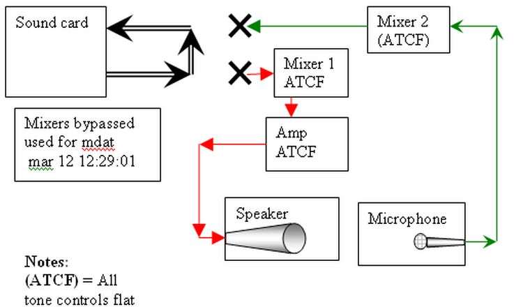

I am using REW to analyze the audio. PC output goes from mixer 1 to speakers. Microphone goes to mixer 2, then to PC

These speakers that I designed and My good friend, and craftsman Bob built are better than they should be!

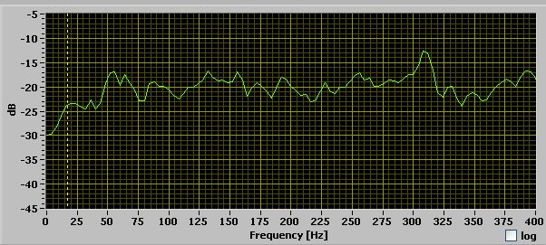

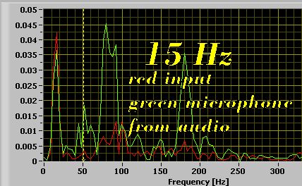

This is what convinced me that the speakers were able to reproduce the subsonic signals.
In order to make it a real life test, the tests are done in our living room.
Test signal, in red is mixed with music audio. Speaker output level is about 70-75 db. Microphone, in green is also picking up background noise.
Low frequency audio is from the horn which is delayed ~6 msec from high freq audio, due to 1meter long horn, + 12” to back wall, +12” & + 24” back to front of speaker. All audio (Green), is delayed 8 m sec, from input signal (Red) due to the 8’ to the microphone, so red and green traces only align on the test signal
Don't really understand what's baffling you (pun intended 😉).
Your frequency response graph shows a quite flat speaker system, with a reasonable peak at 45Hz, and which drops 24dB at around 22 Hz (sorry, all values interpolated using "eye-o-meter")
Book perfect example of "dropping 24dB/oct" below box lower limit.
Yes, even with such massive drop, you will still "hear something" at lower frequencies, nothing wrong or unusual about that.
Specially because of ear's incredible sensitivity and Log response.
JMFahey thanks,
so a 1.3 cubic in speaker reproducing 20 HZ to 30K HZ for $100, and showing (feeling) 10 Hz Is nothing to write home about . OK sorry to bother you
That would be impressive, show me one.
The graph you posted is reasonably flat (for which I commended you) from 42Hz to 14 KHz, and drops like a brick, 24dB/Oct below and above.
By the way, that "horn" has nothing to do with anything you reproduce at 20 Hz.
Do you have any idea of the size a 20Hz horn is?

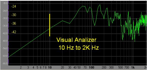

Many other Analysis programs do not show any low freq dip
My ears do not hear a 20+ Db dip
On the left is O-Scope, On the right is from Visual Analizer

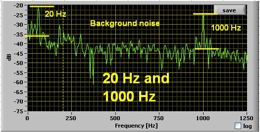

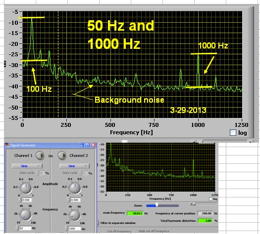

In order to show that the low freq are not reduced I played a 1000 Hz note for a reference, along with a 20 Hz and a 50 Hz note. This shows they are equal or close. attached are the results.
It seems that REW results are in error, or I am using it incorrectly.
